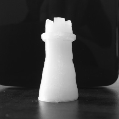

I figured out it was the heated bed causing the issues... I was able to get a good calibration with only the head heated up after I took everything apart and put it back together.
Now I have something else going on.. layers are shifting around during the print < see attached>
any ideas on that?
Re: FSR smoothie auto calibration 1st layer woes
travelnaut wrote: Now I have something else going on.. layers are shifting around during the print
Make sure that your u-joints are lubed and don't have any spots where they stick or snag.
