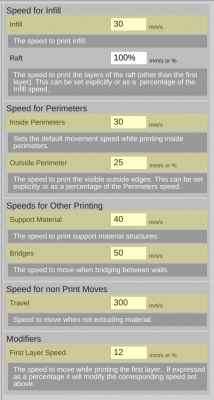

These are the speeds I currently use in MatterControl that I've had really good quality prints with. Can I increase any of these speeds with a significant reduction in print time and without compromising quality? Can anyone else post up their speed settings? I use the same speeds for PLA and ABS.

You could probably take them all up to 50mm/s, except for the first layer depending on your adhesion requirements.

It's worth noting that because of acceleration, path planning and minimum layer times, often even dramatic increases in requested speeds don't impact print times significantly.
You might want to time a couple of prints and compare quality at the requested speeds.

That's very true. I find, though, that 70mm/s is the speed at which we start to get diminishing returns on increasing it. there is definitely still a difference between 50 and 70, for most models, it seems.

Is this comparison on a small part and what are your cooling settings? With PLA, your friend can run a part-cooling fan. With ABS, that's generally considered ill-advised, so printing on molten layers is usually avoided by setting a minimum layer time. You may never actually be using the print speeds you've set.

Acceleration, Jerk and cooling settings become dominant very quickly.
The default Max acceleration values are pretty conservative, some Cartesian printers run as high as 9000, which will make a huge difference in print times as you increase velocity.
