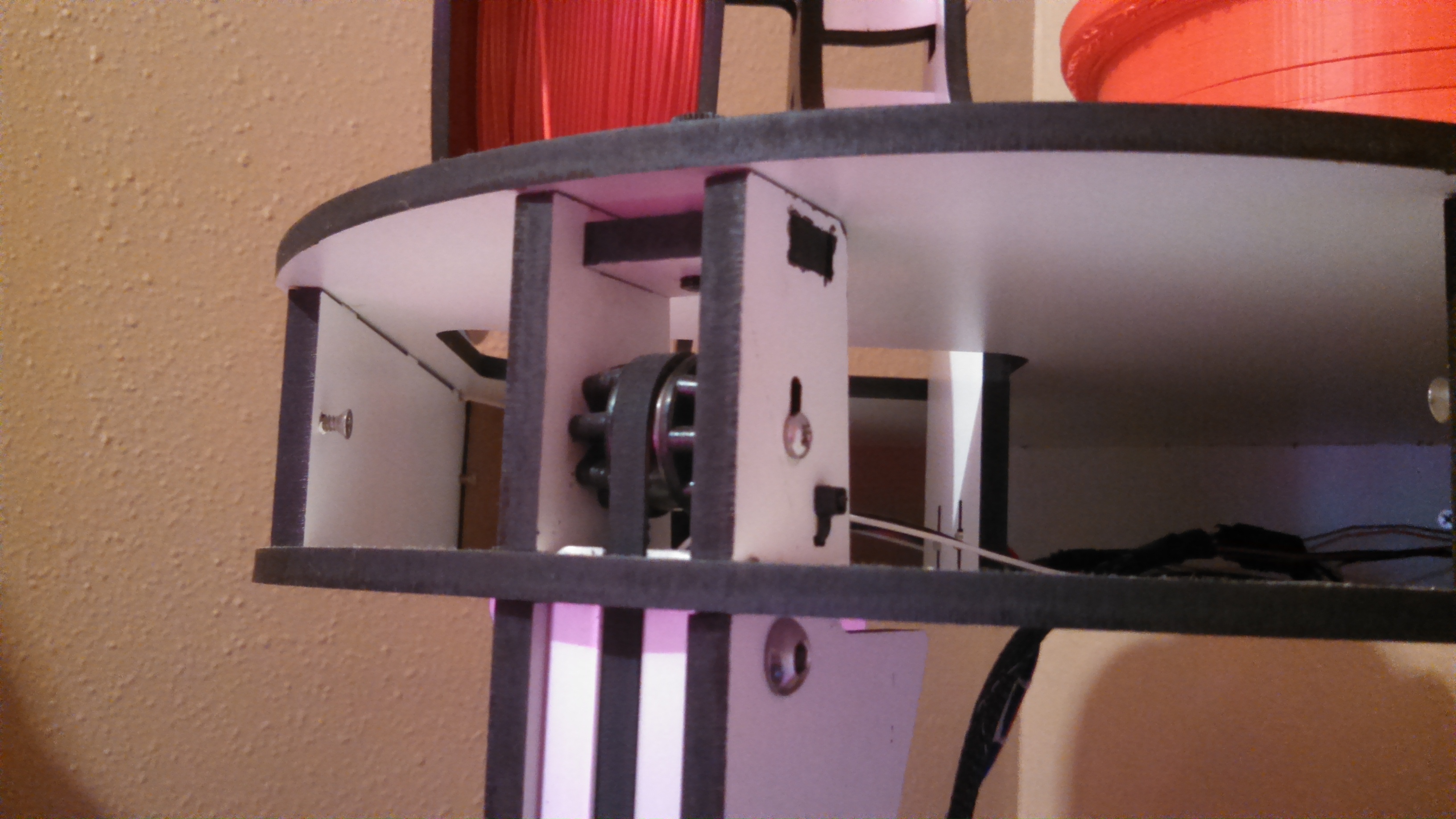

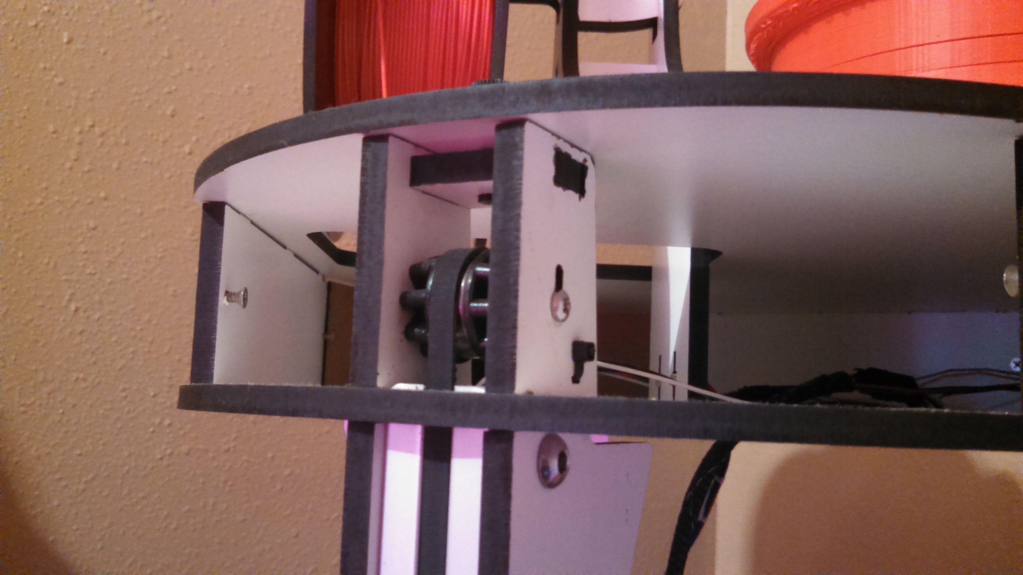

Flavored Coffee
Posts: 59
Joined: Wed May 21, 2014 1:02 am
Re: Rostock MAX V3
Post by Flavored Coffee »
I've got no pictures. But, I have looked over both the belt tensioner and how it works, and I think it would be easier for SeeMeCNC to drill an extra hole in the top's support brackets for a total of four L brackets each with only two screw holes. Then the axle of the belt would go through two of the L brackets, and be bolted together. That would allow for a thumb screw to pull the four tabs together for each belt via a nut and thumb screw. It would just pull the belt's axle up as you tightened the thumbscrew. You'd work on either side to make the tension equal on either side of the belt and be sure it was travelling centered over the bearings. There's a melamine tab that's about an inch long and three quarters of an inch wide, right below that is where the new hole should be drilled for the nut and bolt to hold the metal tab for the four L brackets.
L Bracket Type **Not correct size.
This is where the brackets would be located.
