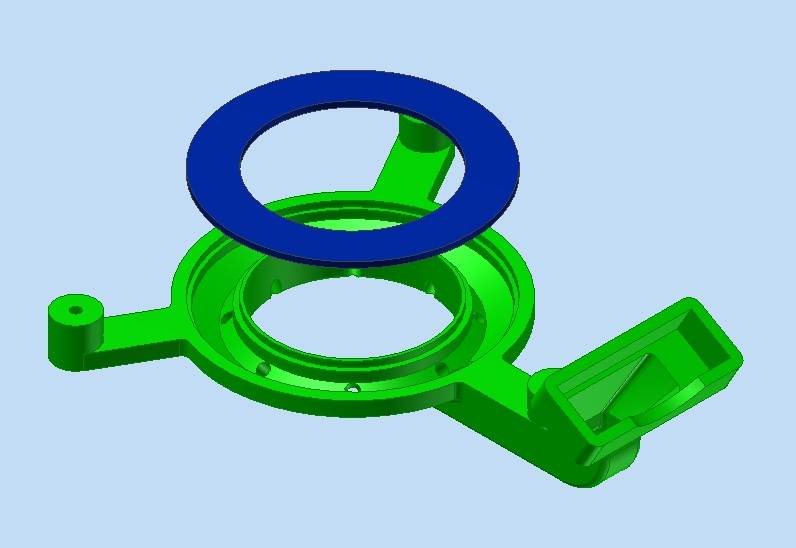

Hi All
I have been designing this Radial cooling Housing, for the MAX 2 because when I print something tall it seems to sag to the Z post. After 3 or 4 tries at style, and 7 prototypes, I got it, seem to be working fine, cooling the ABS at 10% fan setting. I have the stl and gcode, These file do not have to be scaled, already done ready to print. Glue the cap in with PVC/ABS cement to seal top.
Happy Printing
Draw-Tech

Radial Cooling
Radial Cooling

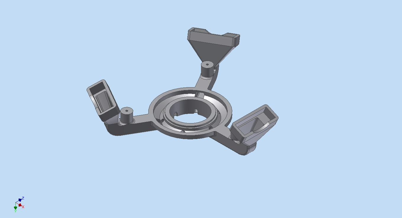

Hi
Just to let you know I almost have the one to mount the tricklaser, also maybe one for three fans, print transparent ABS
Jack
Draw-Tech

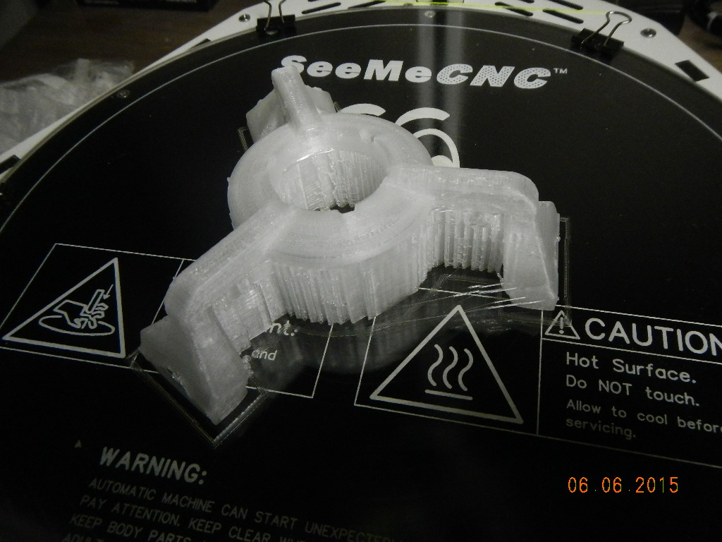

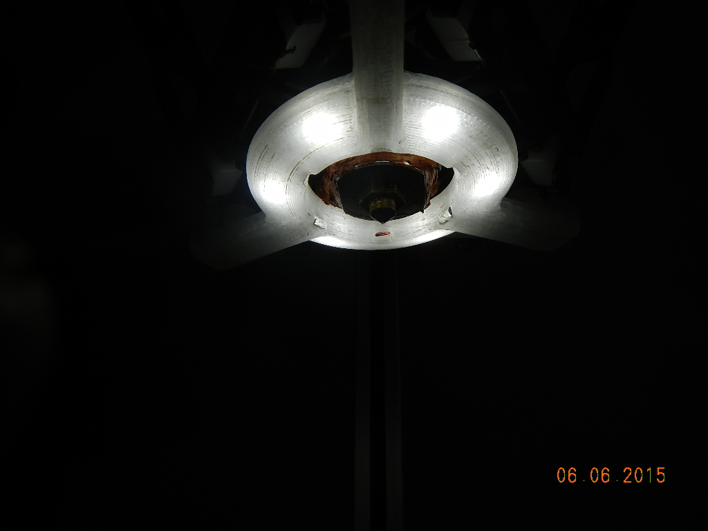

bot wrote:You gonna share that 3 fan design? I doubt it has enough clearance for my setup, but it's a cool design anyway.
Here it is. I believe that if the front fan clears others will be fine. I printed the first one in clear ABS, very bright, maybe white will give a softer light.
Draw-Tech
3_Fan_Housing_TrickLight_10_.025.stl
(1.67 MiB) Downloaded 675 times

Hi 3d-Print
Try any light color, I find the clear gives a real nice white, but white ABS might give it an incandescent type glow, easier on the eyes. Yellow or green might also work ok
Draw-Tech

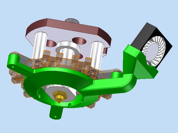

Post by draw-tech »
Hi Neptune
The main reason I positioned the fan that way, to keep from sucking hot air from the peek fan.
Draw-Tech

Hi draw-tech,
that is a really awesome fan shroud you have designed.
LOVE the way the light ring glows and diffuses the light.
Having 3 fans is wonderful.
Great work.
I would like to see the fans turned 90 degrees for better clearance of arms when at print extents, and maybe better airflow not having the tight 90 degree bend in air path.
IMHO possibly taking in a bit of warmer air from peek fan is inconsequential... my "Maker" buddy claims it does not matter if air is warm or cool, it is the air MOVEMENT that draws away heat. What do you think?
