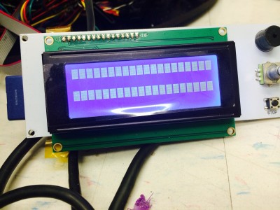

After we upgrade the firmware to 0.91 version, the LCD suddenly refuse to show numbers like showed in graph,
What's wrong with it?

Are you sure it was uploaded? That's what the LCD looks like before you initially flash the firmware.
I'd try it again and make sure you clear the EEPROM. The v2 manual on page 214 should explain it. (page 209 is what your LCD looks like)

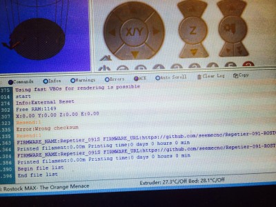

1. After we completed the assembling the first time, which is two weeks ago, everything is fine (the heat rod, bed and everything except the arduino codeand we skip the code calibration). Then, we failed a lot of times
for the test print--the cube because it cannot go flatly while printing and no matter how we adjust it mechanically, it cannot fix the problem.
2. Then we took the advice to upgrade the host. It helped to fix the slicer directory problem but not main problem for printing.
3. After that we took another advice, which is to upgrade the firmware. However, we could not find printer_radius in the code in 0.92 so we changed to 0.91, that's when the LCD and G-code do not work. My partner fixed it and we tried to redo all the calibration part.
4. Now when we are at PID, we found out that the bed cannot be heat up and there is always a "resend 1".
So ,I believe our wiring is ok and it is our software that makes it wrong.

Hi, we have already installed 0.91 as you taught us. And after we change the cable, everything wired in the information board disappeared.
However, the heat bed still refuses to heat up but the nozzle works fine. And we have checked all the wires and it is fine.
One thing I would like you to know is the voltage at the output of motherboard is only 1.2V, would that be some side error that cause output voltage error?

until you get your display back, your firmware is not loaded, reload using arduino. you cannot do anything until that is correct.

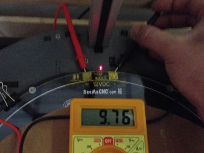

About the bed... checked the wiring with a multimiter? if not:
Turn the Heated Bed on (to 60ºc for example) and with a multimiter check the Heated Bed mosfet output of the board.
It should give +/- 12vDC. With hotend on could be less though.
Then check the voltage of the Onyx.
like this: Don't mind the value. It should be around the 12vDC
