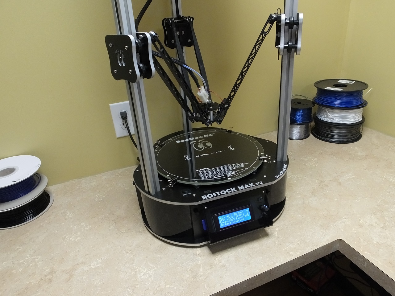

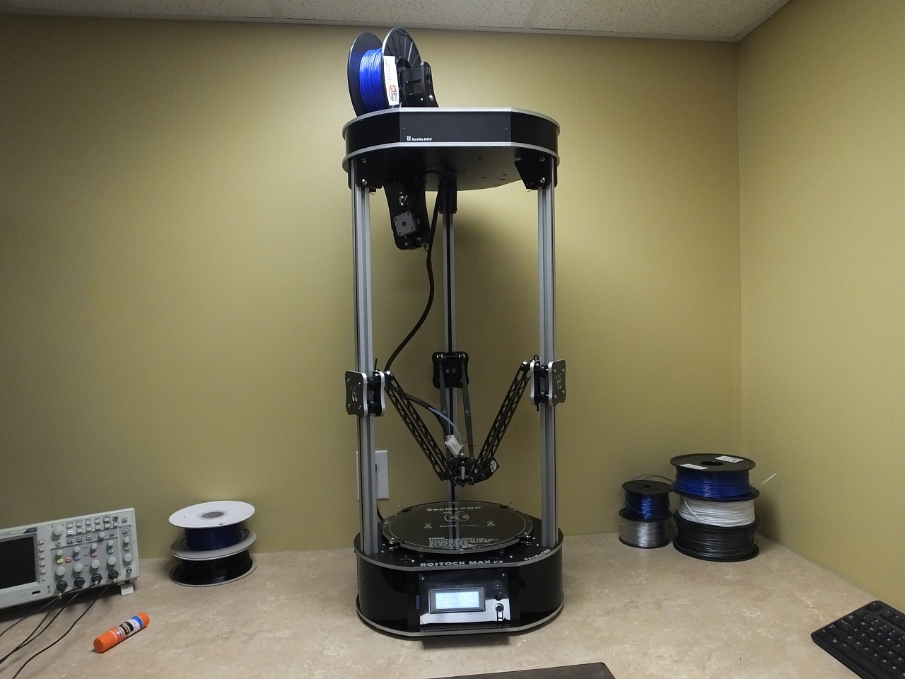

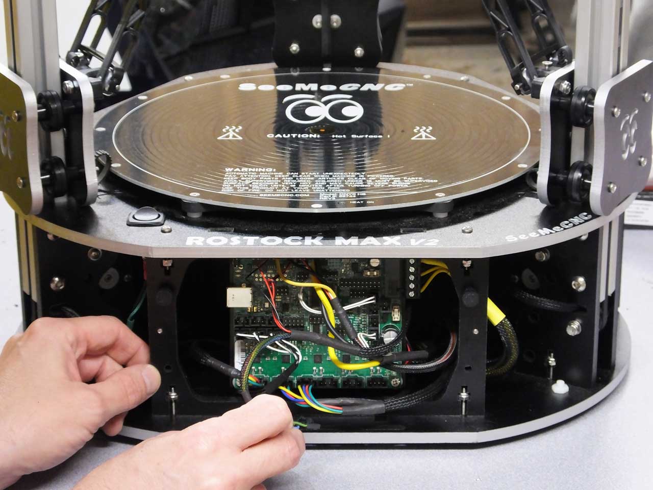

Here's a couple of pictures of our Rostock Max V2, showing the finished printer. We spent the extra time to get the printer built as neatly as practical, and did our own custom color scheme for the melamine parts to bring out the exterior edges with silver accents and black on all interior edges so that the internals and the visible tab edges were not the burnt laser cut color. Painting the edges also takes away the burning leaves smell that the parts gave off. We think it turned out even better than we expected.

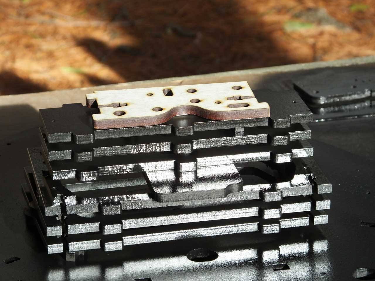

Close-up of the custom paint scheme

Very nice! By the way, what do you have against burning leaves? LOL :lol:

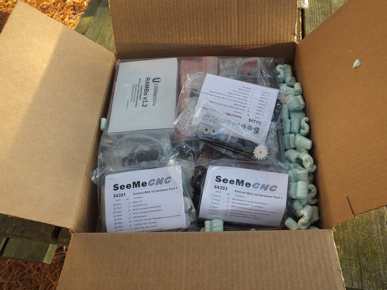

Here's a couple of still photos from our build video footage:
Where it all began!
Where it all began!
Painted black edges vs. burnt black edges. It made a difference to us. ;-)

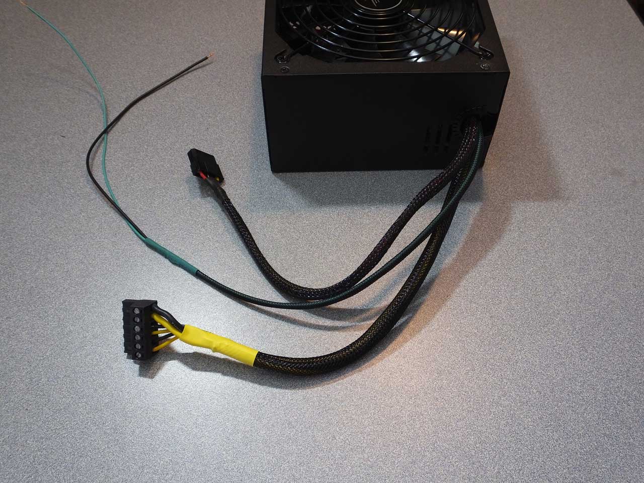

Replaced Power Supply with beefier unit and removed unused wiring harnesses before installation.

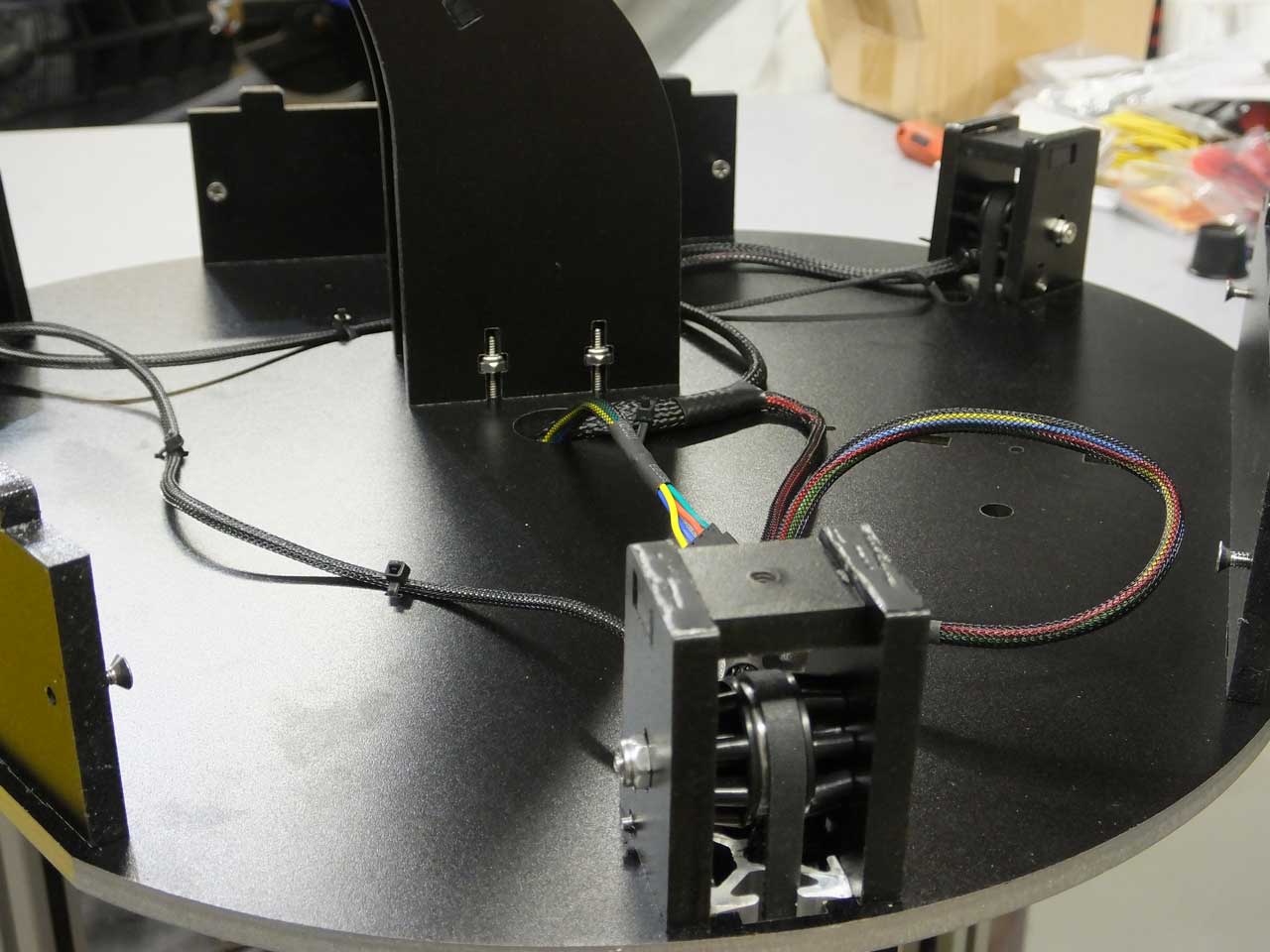

Top End wiring in progress. Wire harness sleeves were taken from the discarded Power Supply harnesses and some from HobbyKing.
RAMbo Wiring In progress.

I think your printer looks great with the silver edges and highlights.
Thanks for all the pictures and the ones to follow.
Time is valuable and I appreciate that you shared some of yours with us.

What would you say is the best way to go about painting the edges of the parts? Roller, brush or Spraycans?
thanks,
-Steve S.
Re: The Intimidator
technut09 wrote:Hi team,
thanks,
-Steve S.
One of my favorite ways is to use a paint pen, they are available in different colors and I like the Sharpie Bold Paint Pen as
listed here: http://www.amazon.com/Sharpie-Paint-Mar ... bold+black
Re: The Intimidator
I stacked my wooden pieces, spaced with construction staples to keep the edges from sticking together, and painted mine with a spray can. I did need to prime the edges first to make the color visible, otherwise the paint just wicks into the wood and is very dark.
