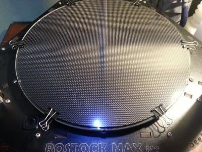

Does anyone have experience printing on a carbon fiber surface over the borosilicate glass or not?

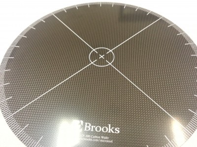

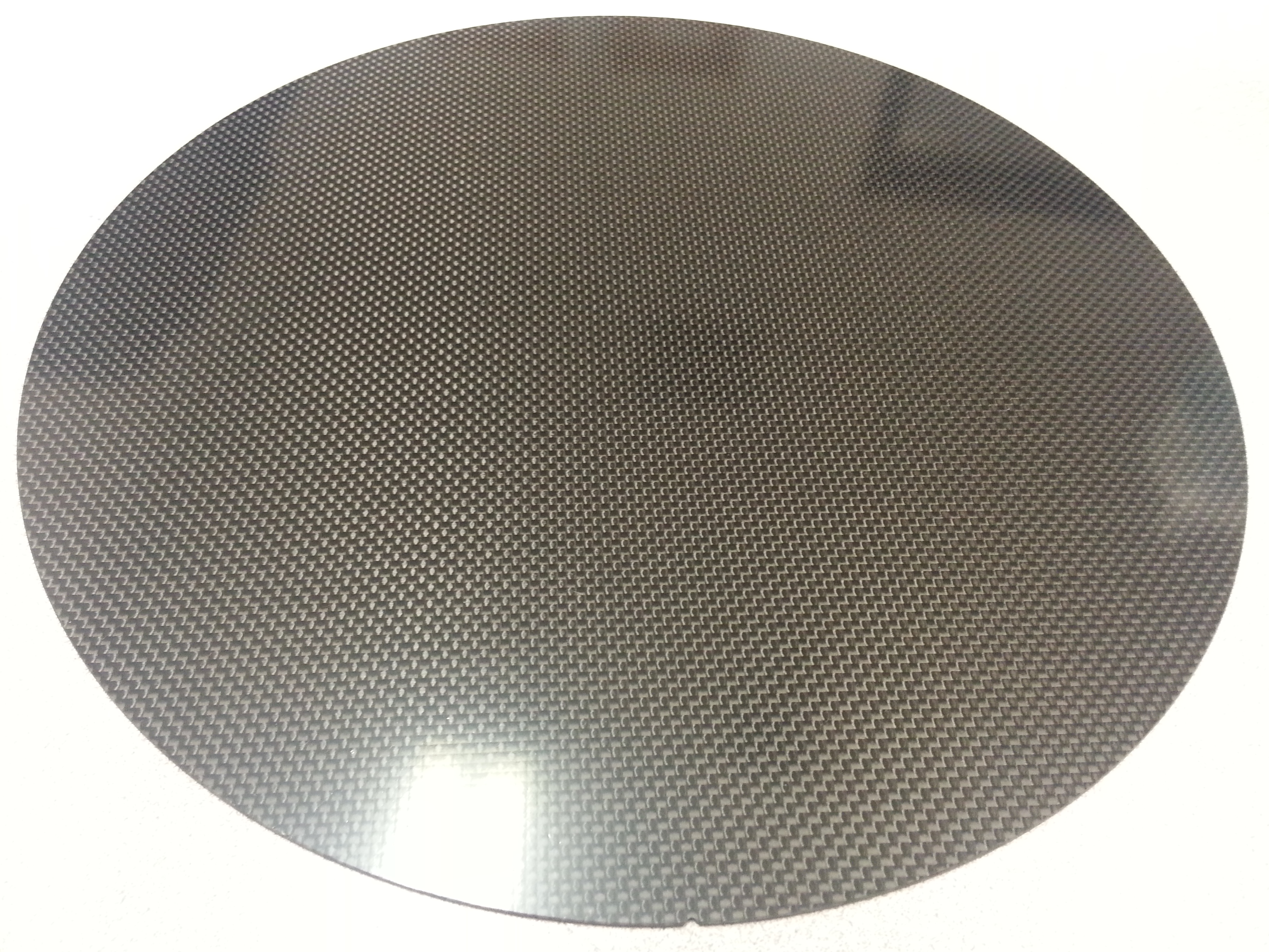

I contacted Brooks Automation and might have used my Air Force email (which may or might not had influence...) Although they are sending a 300mm Carbon Fiber wafer sample for testing, expected delivery tomorrow. These carbon Fiber wafers are way to expensive to use in our application and I made that clear up front. Brooks expressed concern that any temperature over 100c is pushing the limits of the disk to guarantee the flatness. That's the main reason I'm expecting to use this surface over the glass with the same clip attachments.
The carbon fiber disks brand new, hold your breath because this isn't an April Fools joke: $300 bucks each.
They are sending me a "visual" defect sample knowing that I'm not using it for the intended purpose. I have no idea what it's going to look like. I'm hoping it doesn't have chunks missing out the center, but who knows.
I'll post picks when it come in.

it's 1.2mm thick with a .15mm tolerance. I'm sure that's fine for a silicon wafer machine, and doesn't seem much for deviation but +/- .15 could look like a ruffles potato chips under heat

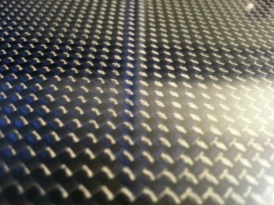

Well,  it lays flat on my desk with no obvious cup or bowing.  It has a small nick on the edge that shouldn't matter. I'll know more when I get it on glass.
The screen print on the top can be felt with my finger nail, and I'd assume can be taken off. I can't feel any woven carbon fiber which was my fear. I'm going to assume some type of resin infusion.

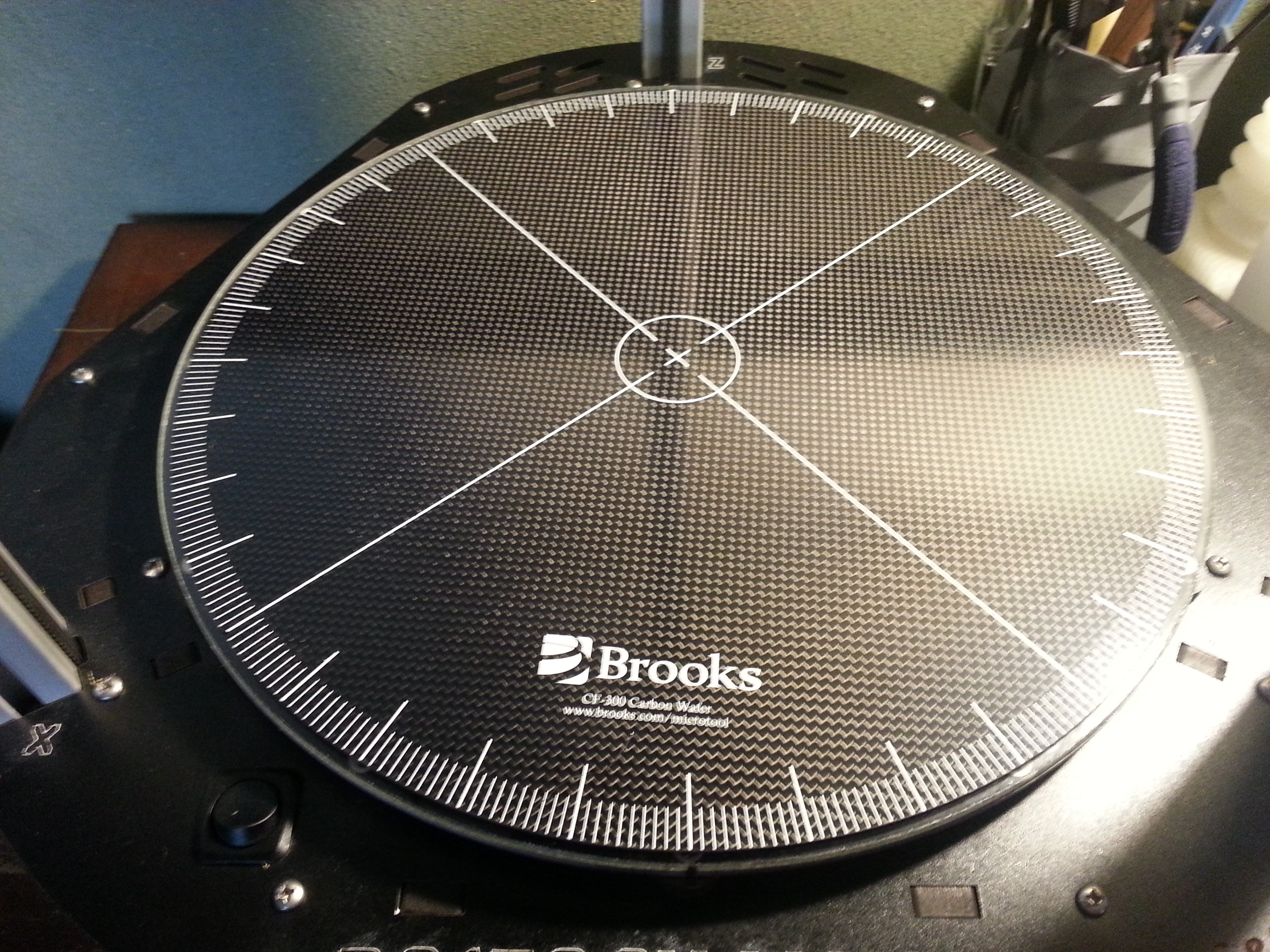

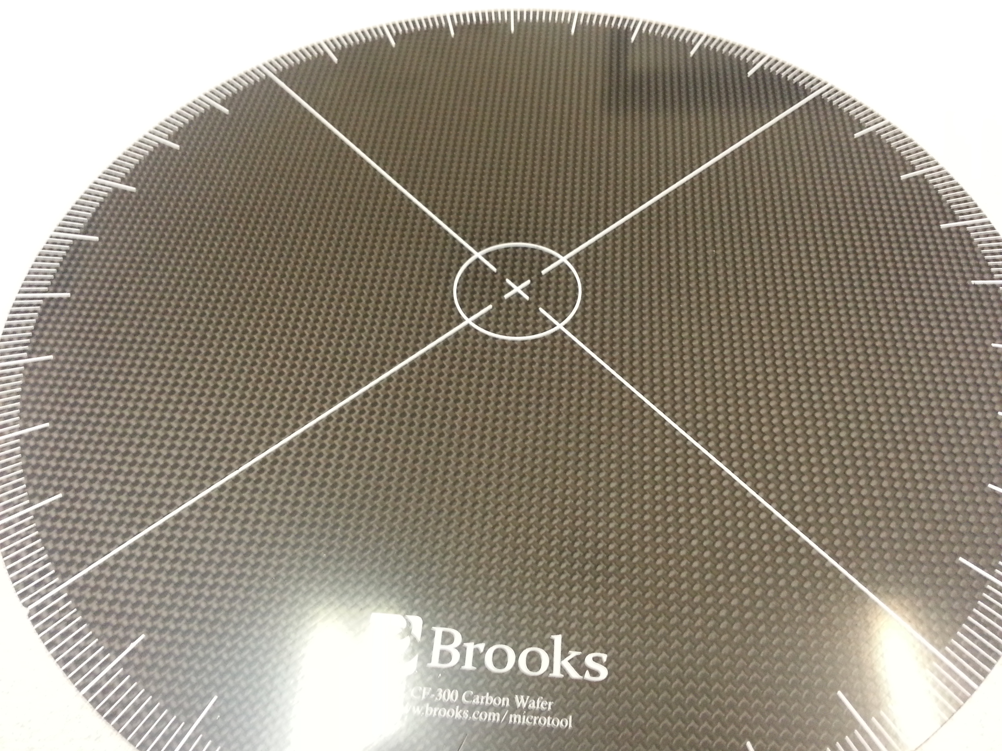

Brooks Automation wants $37.50 for the rejects. I don't know if they have profit built into that based on the original cost of $300. If you purchase in bulk the cost goes as low as $170 for 500 units. (no joke) That's out of my league for sure.
I'll be honest in saying the surface is slick right now. The camera doesn't pick it up, but its almost a mirror coating of whatever they're using or it's polished.

Starting a Kossel upper in PLA now. Not sure if it's off to a good start, as skirt literally comes off with no force at all.
						Re: Carbon Fiber Printing Surface
I'm going to say it's a no-go in its current form. PLA slides off the disk like eggs in a Teflon pan.
I'll send an email in the morning to purchase this disk. I like the thickness and rigidity of the carbon fiber, so I'm thinking about doing a light sanding to knock off the slickness and try again.
Worth a shot anyways.

Surface may have silicone residue from manufacturing.  You might try an alcohol or acetone wipe down.  Assuming the binder they used is solvent safe...
