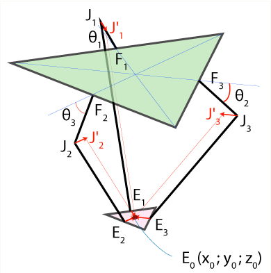

This problem reminds me of the kinematics for a traditional delta, where there are servomotors on top that actuate hinged arms: http://stackoverflow.com/questions/1816 ... elta-robot
Delta kinematics.png (16.62 KiB) Viewed 16073 times
It occurs to me that the traditional delta is actually solving a problem very similar to the problem this thread is about. Linear deltas are just a simplified version of the original design. Perhaps there are things they have in common, trigonometrically, that can be used to figure out a solution.
One partial solution would be to use the unit vector's Z component to correct for carriage elevation. If the carriage Z changes by 0.998 for every 1mm of elevation commanded, I can choose to move the carriage by 1.002mm for every millimeter commanded. That will correct it in the Z dimension, possibly taking some error out in the process. However, it would amount to "pushing error around" instead of eliminating it.

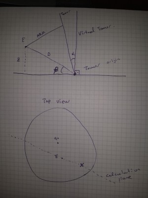

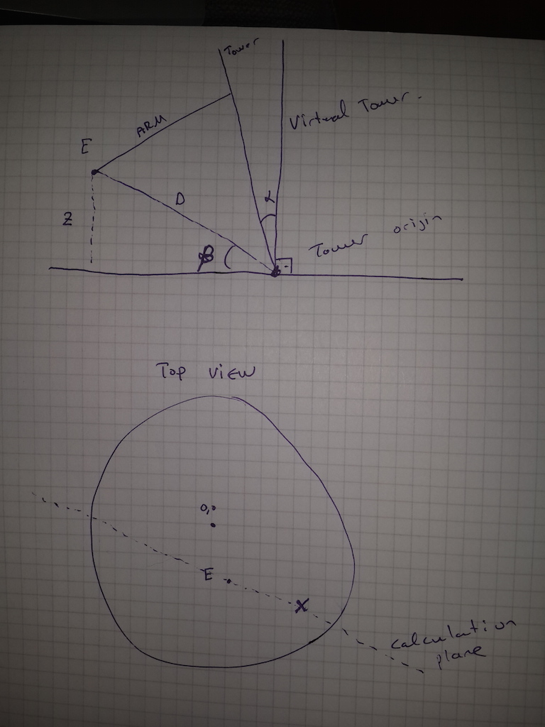

are you assuming that you know X Y and Z at this moment? Oh and is your tower lean a parameter? (And are you assuming the tower can lean just towards the center or does it include a sideways lean).
If for the inverse kinematics you have knowledge of X, Y , Z position of the carriage and at this point you know the tilt, then it can be solved.
626Pilot
Posts: 1716
Re: Working on tower lean - could use some trig help!
Post by 626Pilot »
teoman wrote:are you assuming that you know X Y and Z at this moment? Oh and is your tower lean a parameter? (And are you assuming the tower can lean just towards the center or does it include a sideways lean).
X, Y and Z are inputs to the inverse kinematics. They are the desired Cartesian coordinates of the effector. The tower lean parameter is in { degrees from X, degrees from Y }. That gets turned into a unit vector and multiplied by the distance from the tower's origin (oTWR).
teoman
Posts: 1770
Post by teoman »
I think i have found a solution, but you need to calculate 2 angles.
Both of these angles have to be on the vertical plane (relative to the base) that passes through the arm.
The first angle is beta, it is calculated using X, Y, Z and the origin of the tower.
The second angle is alpha. Alpha is the angle between the real tower and the virtual (perfect tower) projected on to the previously mentioned plane.
Using the law of cosine would make ELEV the position along the real tower of the carriage.
AL^2 = ELEV^2 * + D^2 - ELEV * D * cos(90 - alpha - beta)

teoman wrote:I think i have found a solution, but you need to calculate 2 angles.
Law of cosines is: a^2 = b^2 + c^2 - 2bccos(theta).
So there should be a 2 there.
What is D^2 in the equation? Maybe I am missing something. If you know D as well, then that works great.
If this equation does work, there is an easy way to find alpha. In calc three, you learn that the dot product of two vectors is the lengths of each one times the cosine of the angle between them. This can be manipulated to solve for the angle. http://www.ltcconline.net/greenl/course ... otcros.htm
v = virtual tower vector = <0, 0, 1>
w = lean unit vector
Alpha is the angle between them.
Absolute value signs around a vector means the length of it. Its simple to get using Pythagoras's theorem.
Code: Select all
v * w = |v||w|cos(alpha)
Length of each of these vectors is 1.
<Wx, Wy, Wz> * <0, 0, 1> = 1 * 1 * cos(alpha)
Wx * 0 + Wy * 0 + Wz * 1 = cos(alpha)
Wz = cos(alpha)
alpha = cos-1(Wz)
So if you want alpha, you should be able to take the inverse cosine of the z component of the unit lean vector

D is the distance from the tower origin to the effector.
It is the hypothenus of the right angled triagnle with one side being Z and the other being the distance of the X,Y point projected on to the base and the tower origin.
Yes you are right. I forgot the 2 over there.

Direct unit vector may not work as you still have to project it to the vertical plane i described.
