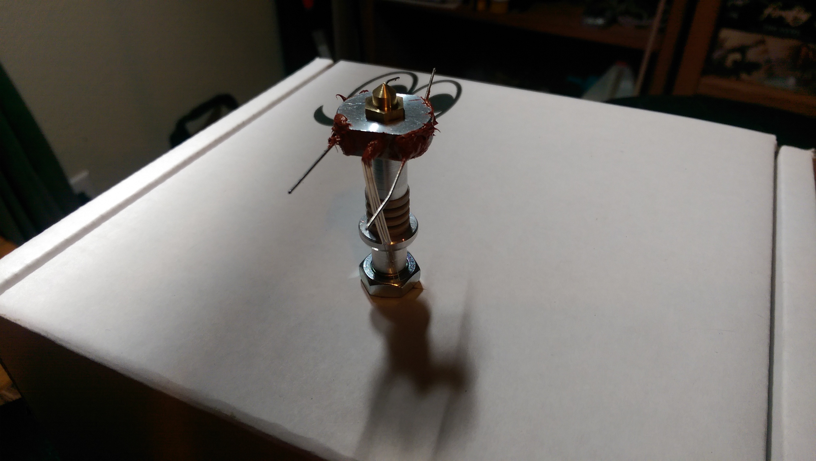

Got the hot-end assembled. Here in San Antonio, the Permatex Ultra-Copper High Temp RTV was available from Advance Auto, AutoZone shows it discontinued. Want a bunch of blank stares? Go to Home Depot or Lowes and ask for Kapton tape. Ultimately, ordered it from Amazon. Hot end is now sitting, as recommended, curing.
Hotend curing
Hotend curing

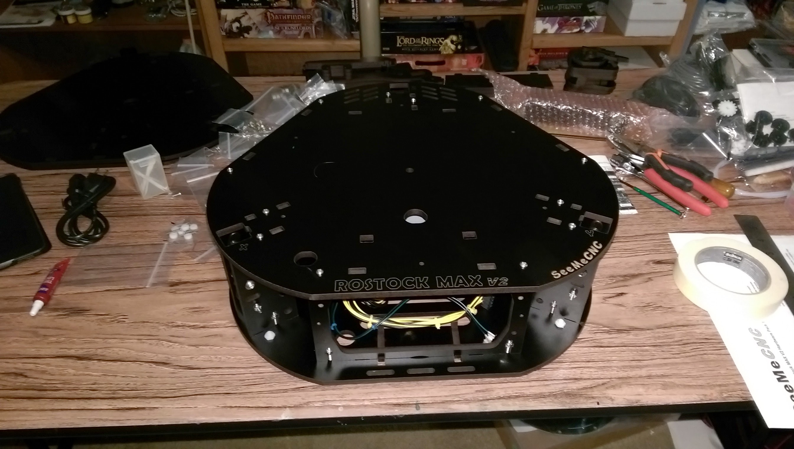

Day #2 -
Got the stepper motors, upright supports installed and to top of the base completed.
The only part about the instructions here was the orientation of the wires from the stepper motors. I had to take one apart and rotate the stepper motor 180 degrees to get the wires where I wanted them. I suspect it doesn't actually impact anything other than some OCD.
Next up to the get the Onyx bed pieces attached and then install it on the base.
Base completed 1
Base completed 1
Base completed 2
Base completed 2
Base completed 3
Base completed 3

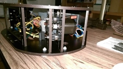

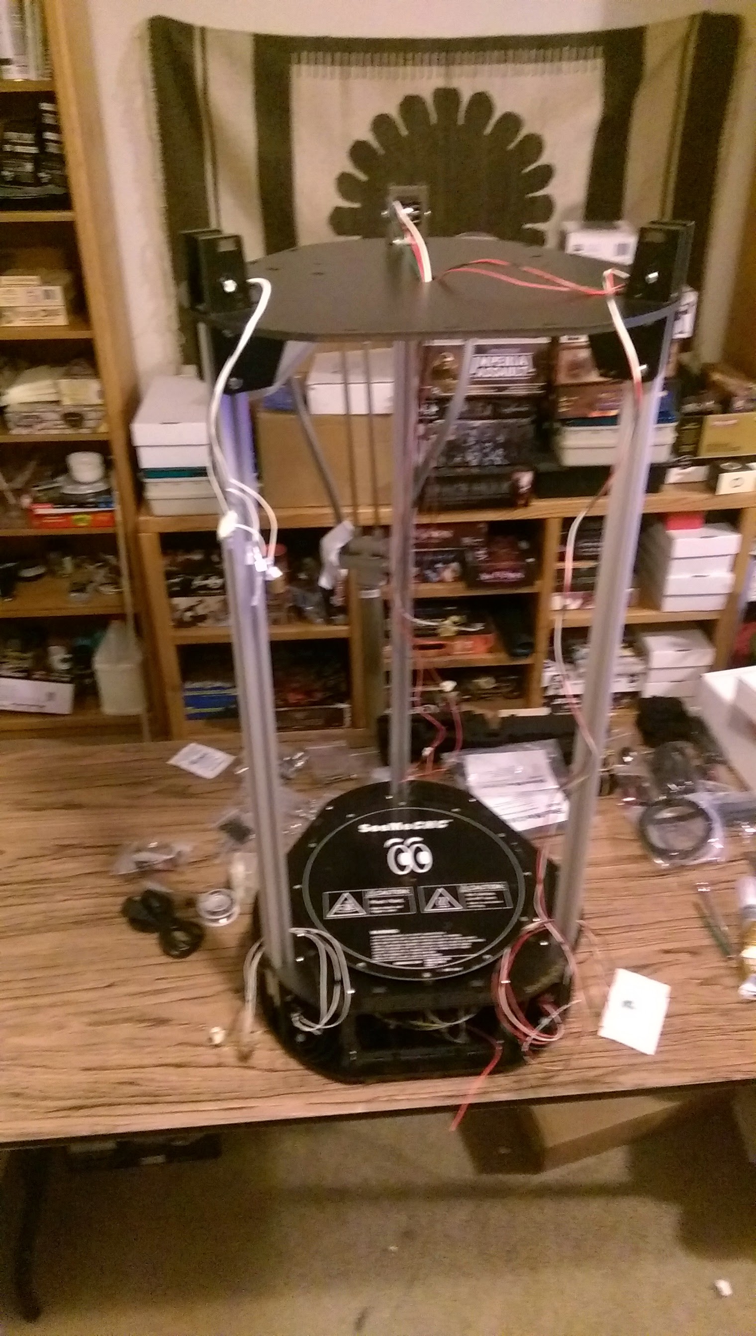

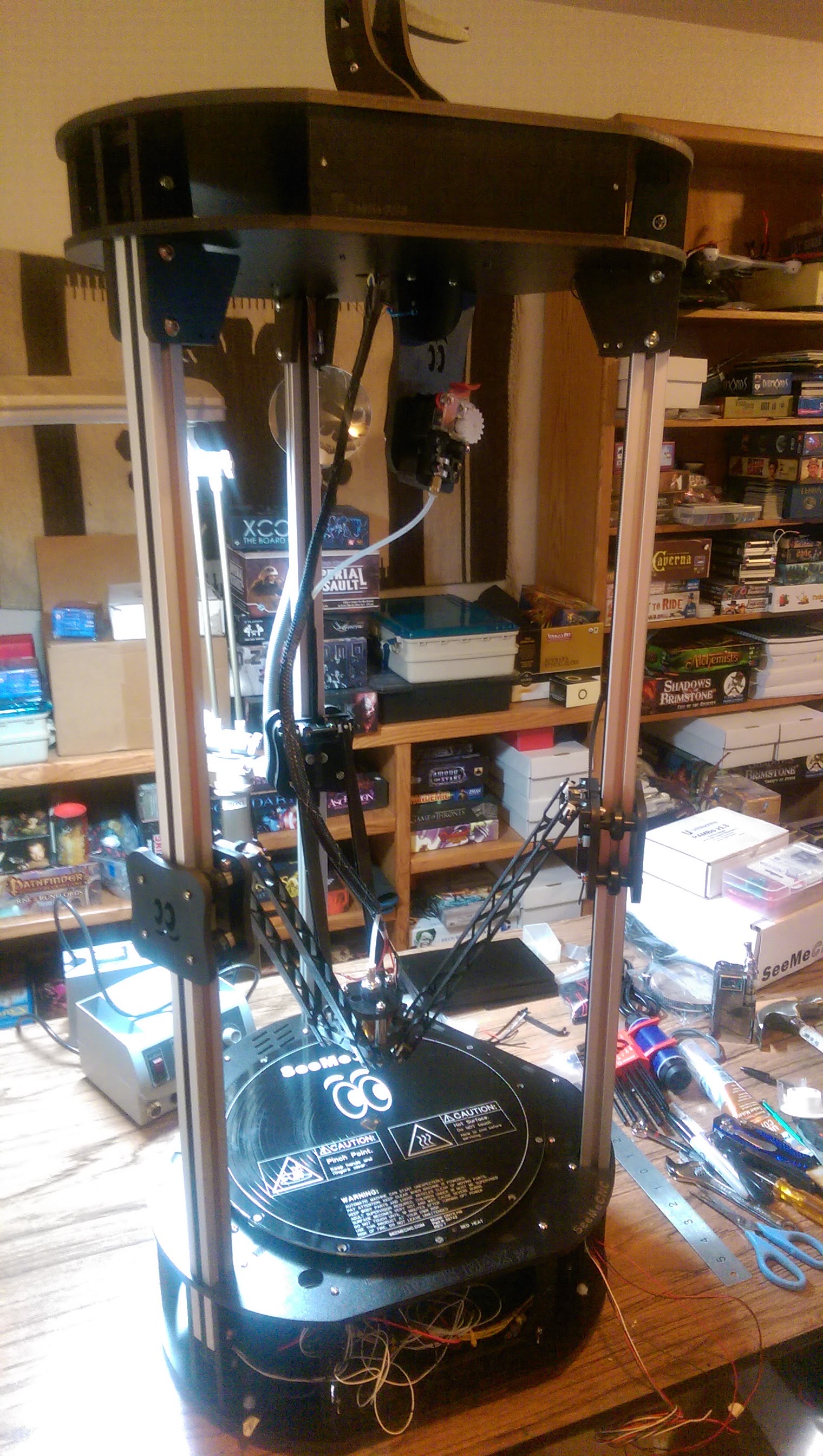

Day #4 - Got the uprights wired and assembled to the base and then the top base installed. It's actually beginning to look like a printer :)
Only minor issues for this day:
- The #4 3/8" Sheet Metal screws that came in the kit don't seem to be the correct type. The supplied screws can't actually bite into the 'hole' (slot) in the top support. So, I picked up a few from Lowes. The picture in the instructions show the correct type of sheet metal screw, but what was in the screw bag was different.
- When putting together to top supports the instructions say that the support with block screw goes to the left, but I couldn't find anywhere it said which side was up on the top base. A couple pages later there was a picture of fully assembled top base.
So far this has been a fairly relaxing build; well, I'm moving at a relaxing pace at least. The instructions are actually quite good and easy to follow.
Beginning to look like a printer
Top support, w/ the sheet metal screw in the bottom slot.

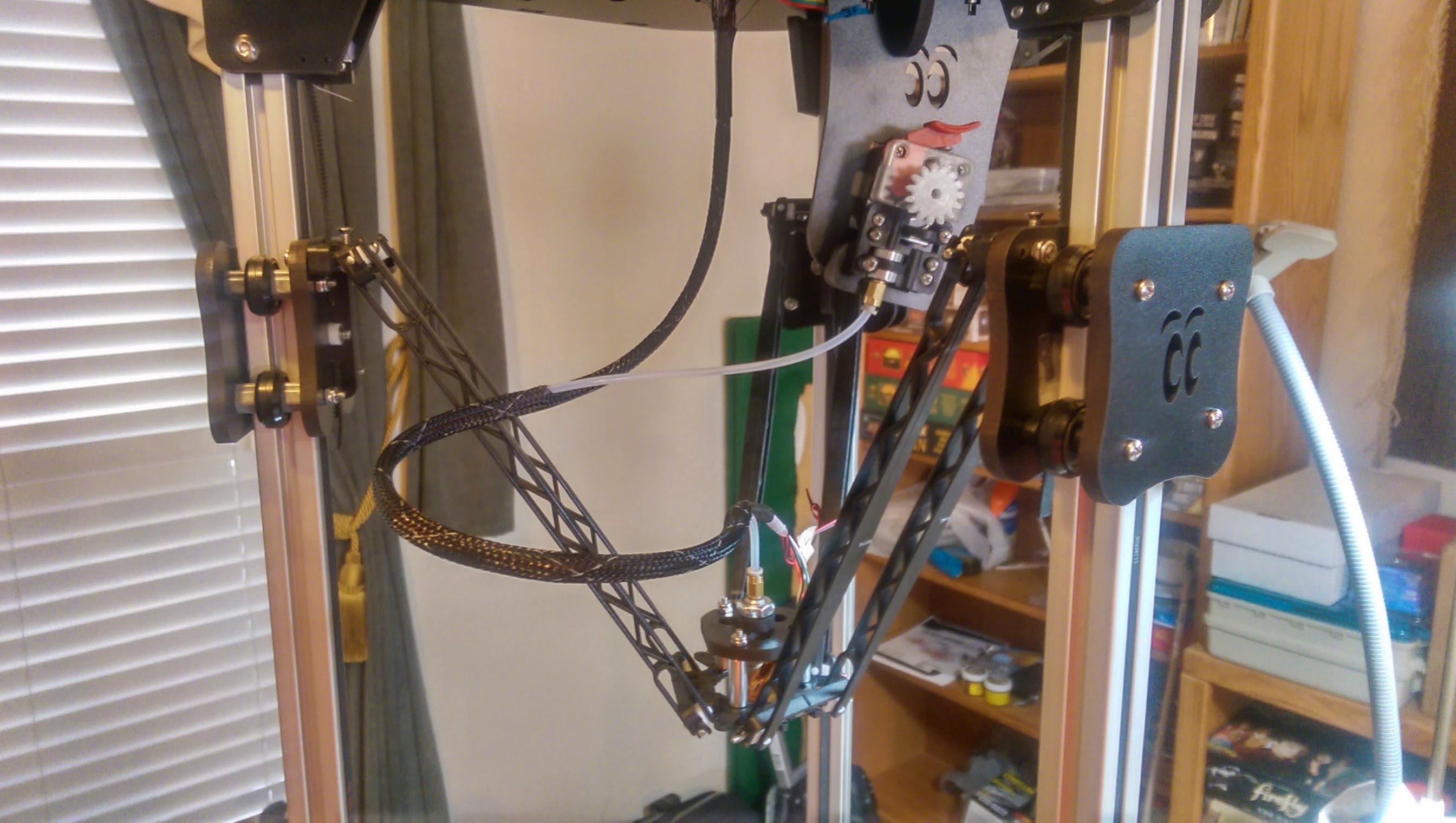

Day #5 - Got the mechanical build completed today. It actually looks like a printer now. Next up is to get all the electronics wired up and installed. I expect I'll be powering it up sometime on Sunday.
Arm attached to the cheapskate

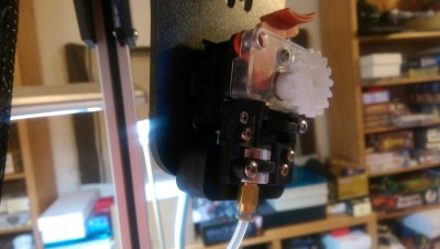

Hot end installed getting close to being completed.
Ez-Struder installed

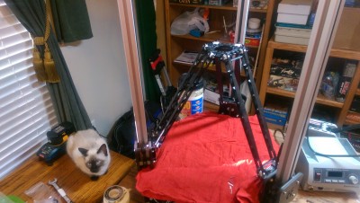

Arms connected and inverted to install hot end. (Note, I was able to get a shot of the invisible cat that assists with the build)
After installing the cheapskates and the belts

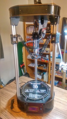

Completed mechanical build

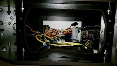

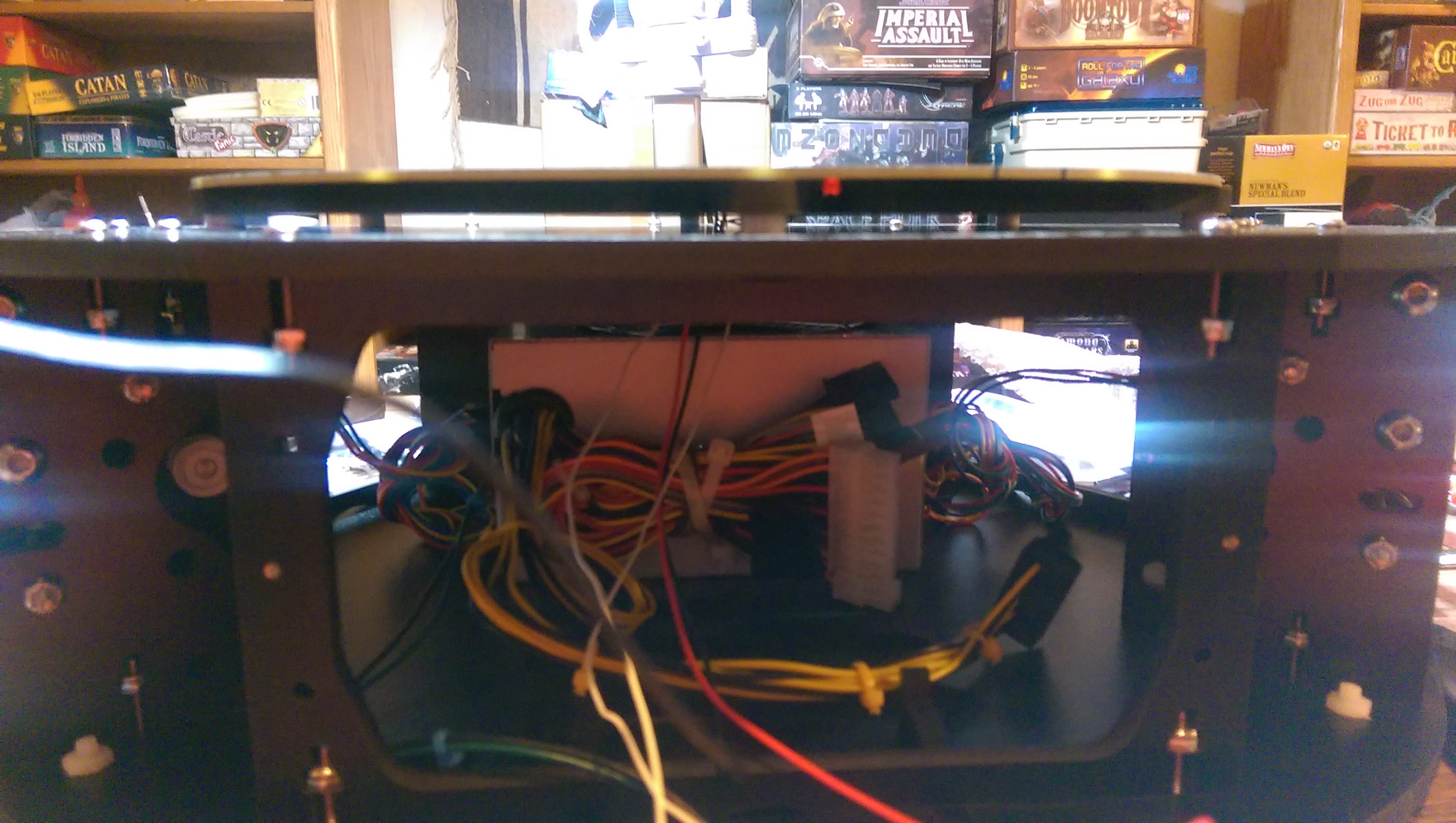

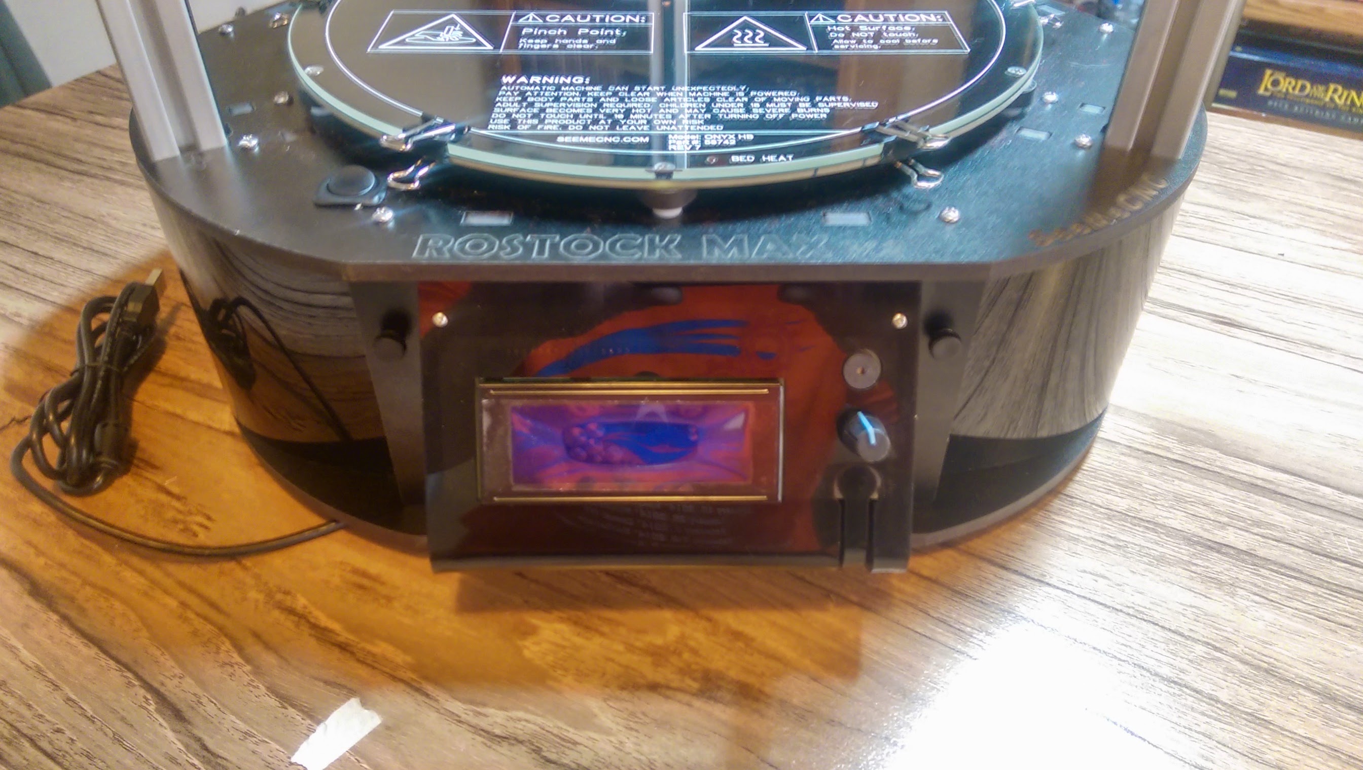

Day #6 - Finished getting everything wired up and connected, and put the finishing parts on the printer.
Went to do the 'smoke test' and no power. ATX power supply fan isn't turning on when the switch is turned on. I checked the switch to make sure it was working and it checks out good. I disconnected the power supply from the RAMbo to check to see if maybe there was a short, but looks and continuity checks good.
Possibly a bad power supply from the start; that would be really really unusual, but not unheard of.
Now I need to try to figure out how far apart I need to take it to change out the power supply.
Posts: 1407
Re: Alamo-Bot Build
Post by Mac The Knife »
Power supply should drop out through the opening in the bottom.

It....... Lives.......
Installed a Corsair CX750M power supply
It has a modular cables, meaning, fewer wires behind the PSU. Downside? All the wires are black, so trying to find 6 yellow and 6 black is REALLY challenging and you have to be very careful.

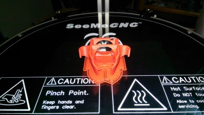

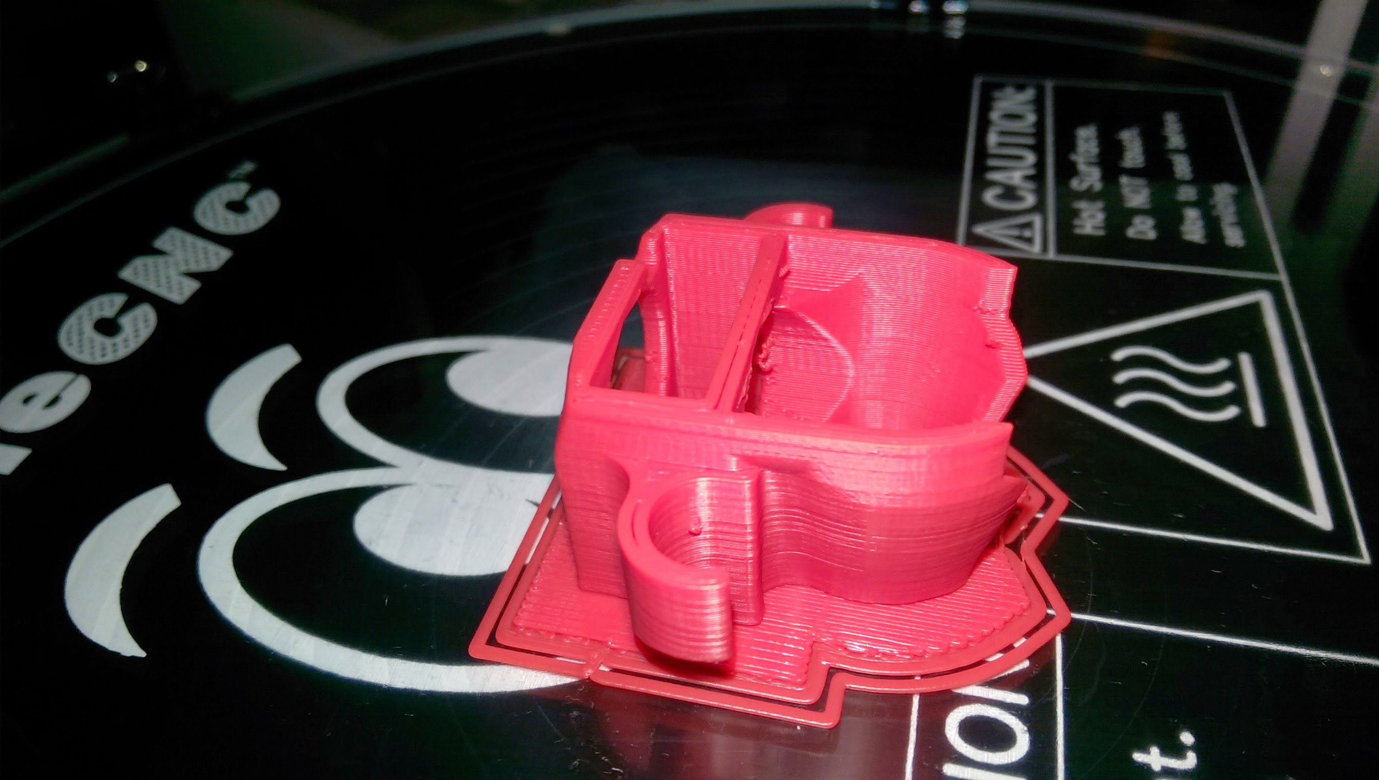

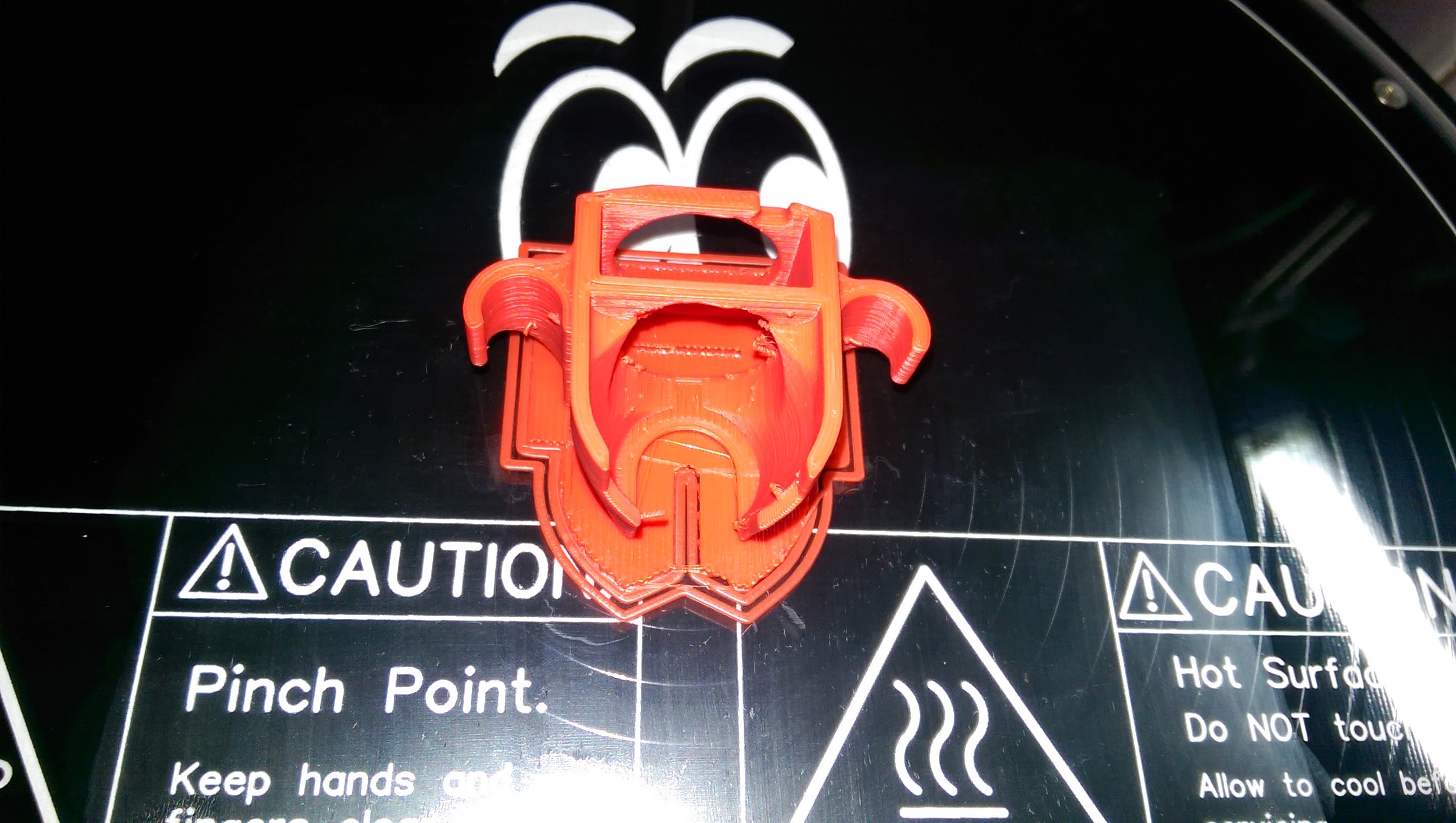

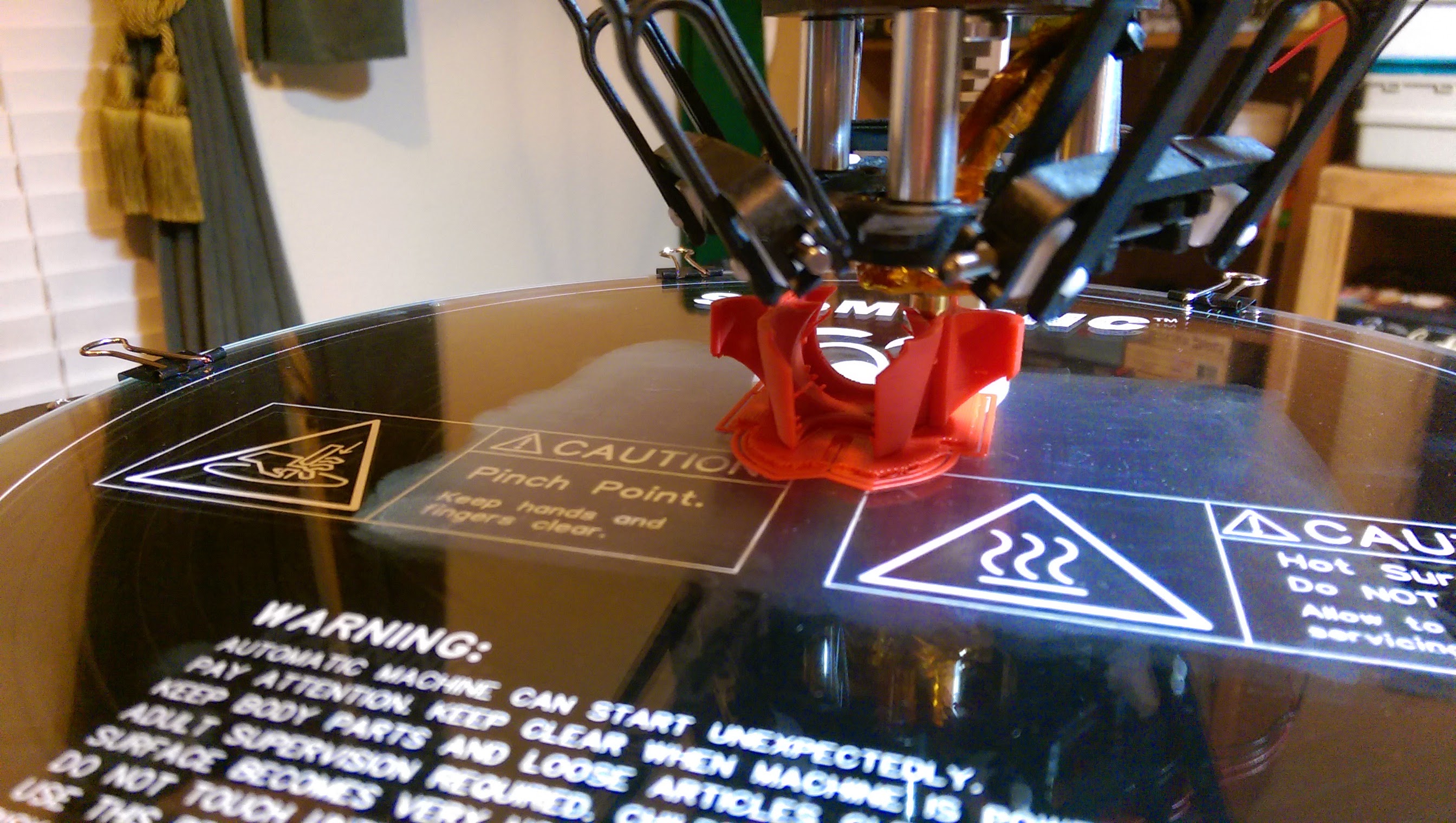

Day #7 - Build completed and first print came out incredible!
It is really quite amazing to see this printer go to work and start printing. While building it was a challenge, it wasn't a frustrating challenge. It was a great deal of fun. Even better is when the first print 'just works'.
Kudos to the SeeMeCNC team for creating such a wonderfully engineered kit!
Big thanks to the word of encouragement from the forums here; this is really a great community!
Printing in progress; PEEK fan shroud
