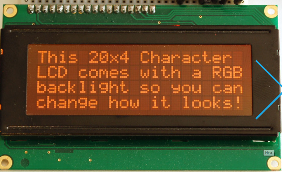

I also want to replace the default blue LCD screen with a negative orange one. I don't know that much about electronics, so if anybody could point me in the right direction (model, maybe even a place to get it, any other modifications it would require) it would be much appreciated!

http://proto-pic.co.uk/rgb-backlight-negative-lcd-20x4/
RGB 20X4 LCD. Difference is it's got 18 pins instead of the normal 16 to change the colour. yes you can do Orange
Presumably you'll have to use some spare pins on the Rambo to drive those colour pins, doubt it will be that hard .. lots of LCD tutorials for Arduino
and with some minor coding skill it's pretty easy.

Did you check out the RGB display that will allow you an Orange display, the site I linked is just the one from Adafruit
They are very cheap but it really depends how easy it is to upgrade as it got 2 additional pins to control the colour... will be doable though imo.

I think you could find a version without the RGB backlighting, as in one that is orange and only orange.

Yeah you could get a 20X4 Amber.. but selectable colour is way cooler :)

RocketMagnet wrote:Did you check out the RGB display that will allow you an Orange display, the site I linked is just the one from Adafruit
Thanks for the link, it's much appreciated! I did check it but I got lost at 18 pins. I wouldn't even know where to begin adapting it :D I was hoping for a simple mod that only implies desoldering the original LCD and soldering another one in its place. Selectable color is indeed cool but if I would get one, I would set it to orange and ever touch it again.
Nylocke wrote:I think you could find a version without the RGB backlighting, as in one that is orange and only orange.
That is exactly what I had in mind. I only managed to find a single source for a 20x4 negative orange LCD but I wasn't sure if it's compatible and now it's listed as sold out.
On the same note, I've seen LCDs that run on either 3V or 5V. Does anyone know what's the voltage on the Smart Controller's LCD Vdd pin? Any other things I should look for to know whether it's compatible?

The LCD is soldered on to the PCB. You CAN change them out. Jasper(?) did that with his Yellow Jacket Rostock MAX. It now sports an LCD that's a very crisp yellow on a black background. Looks very bad ass. :)

geneb wrote:The LCD is soldered on to the PCB. You CAN change them out. Jasper(?) did that with his Yellow Jacket Rostock MAX. It now sports an LCD that's a very crisp yellow on a black background. Looks very bad ass. :)
[img]http://www.themakerhive.com/FTP/jassper/LCD.jpg[/img]
