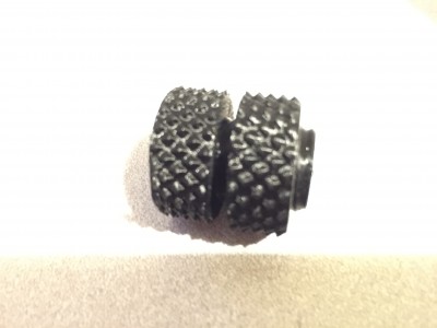

Posted: Sat Oct 03, 2015 6:36 pm
by briankb
I've made the Makerbot Nut & Bolt a few times on different machines as a calibration test. You will want to enlarge the "nut" by about 5-10% to make it work well.
Knurled Surface Nut and Bolt
