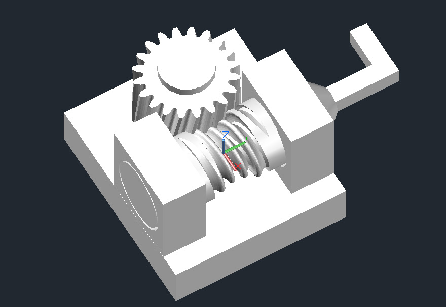

I actually designed a rather interesting (I think) hyperbolic worm gear. It has some weird overhangs with PLA, but I'm sure printing with something like Nylon would make it easier, but mine print ok and are fully functional. Here's a screenshot of me working on it in AutoCAD.
There were conceptual tutorials on how to make these sorts of gear sets online.  I just used the same methods and concepts within AutoCAD to make my own personalized gear set.

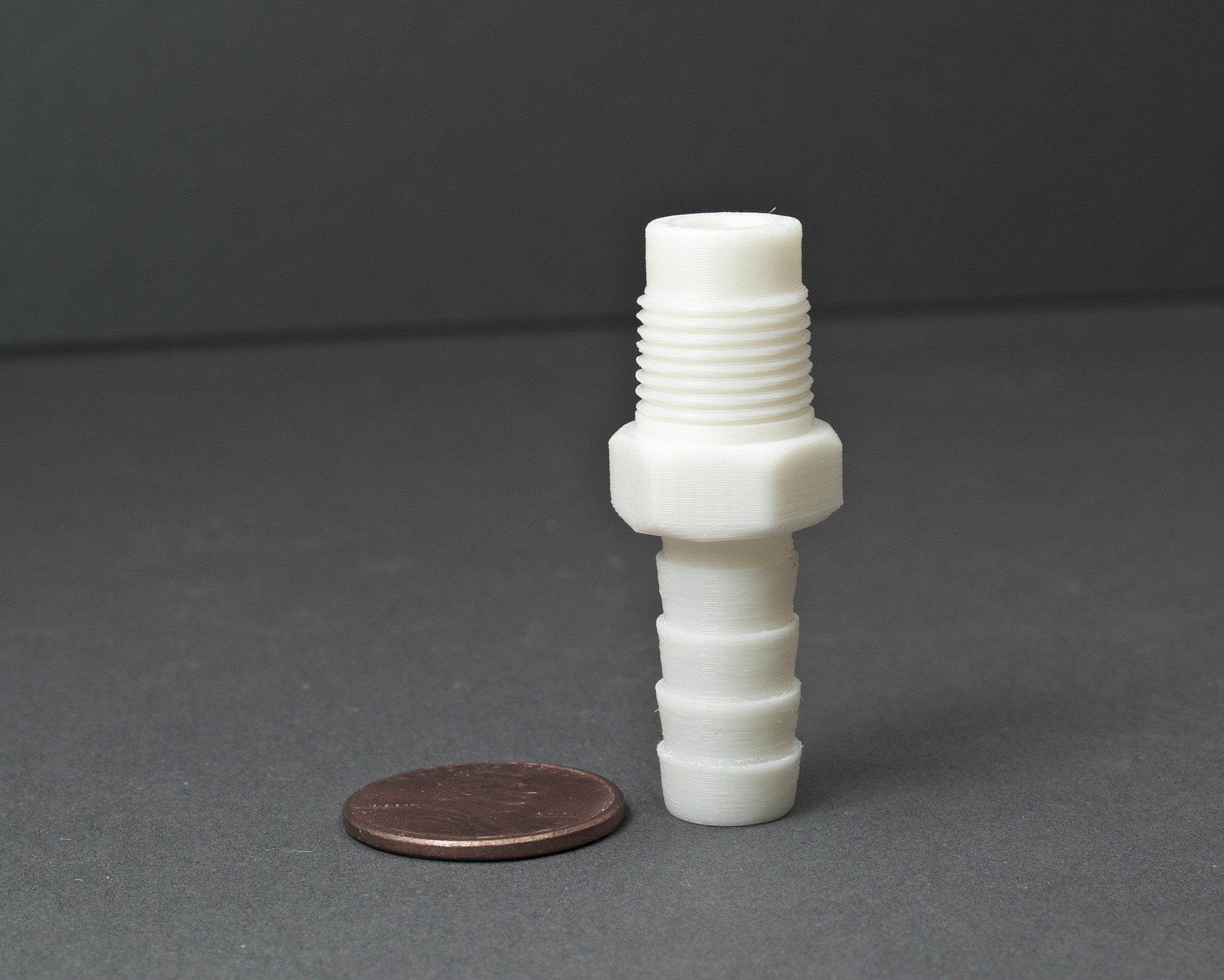

Here's one I just printed this morning. 12mm-1.0 tapered thread x 9.5mm barb. Threads look a little rough in the picture but screwed in perfectly to the metal female thread. ABS and sliced with S3D.

heathenx wrote:Here's one I just printed this morning. 12mm-1.0 tapered thread x 9.5mm barb. Threads look a little rough in the picture but screwed in perfectly to the metal female thread. ABS and sliced with S3D.
Nicely done. What is your layer height? Minimum layer time?

My layer height on that one was .17mm and printed at 30mm/s with the cooling fan (PLA) set to 50%.

That's nice work. Just to clarify: you're printing in ABS, and you're using the layer fan?

Ha! Yup! Normally I never do that but on small parts like this it's sometimes beneficial to turn the layer fan on. You'll need good bed adhesion of course (I used hairspray on this job). I only had the fan set to 50% and I ran the job at 30mm/s. Nice and slow. An alternative to the layer fan would be to print two or three models instead of one. That would give each layer on each part time to cool before the next bead gets laid down. Keep the part close to minimize any stringing if that's an issue. We all have our tricks, right? ;)

I print ABS at 230°C and run by bed at 85-90°C.

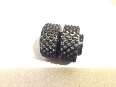

I've made the Makerbot Nut & Bolt a few times on different machines as a calibration test. You will want to enlarge the "nut" by about 5-10% to make it work well.
