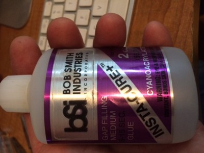

How to fix scratches and divots!
You've been using PEI for 100s of prints. You love it. Then you get the inevitable divot from removing a part in your haste. Or you scratch the surface with a poorly set Z height. Never fear, a fix is here!
Let me preface this by saying I have probably spent more time trying to figure out how to repair PEI than almost anything else I've done on my printers! Why? Because the fly fishing reels that I print and sell require perfection. The surface finish from the print bed is the most highly visible part of these reels so it has to be perfect.
[img]http://mhackney.zenfolio.com/img/s12/v1 ... 6588-3.jpg[/img]
I've experimented for more than a year. I tried dissolving PEI (I won't explain this as it uses very nasty chemicals), melting PEI, filling with HDPE and other plastics, filling with bondo and other polyesters, epoxy, epoxy with PEI dust and the list goes on and on. But, one technique not only works well and is quite easy, it lasts for a long time (I have repairs over 6 months old that are still holding up). How is this minor miracle accomplished you ask? With Bob Smith Industries Medium Gap Filling Cyanoacrylate! I tried many other varieties and viscosities of CA (aka super glue) but this one is sheer magic. It comes in a purple bottle so get the right stuff:
Next, the process...
In order to get the best bond you need 2 elements: absolute cleanliness and a slightly rough surface. I start by sanding the area of the scratch or divot with 400 grit wet/dry sandpaper with water. This is important, don't sand dry or you will never get all of the dust out of the scratch. You can do this with the plate installed on your printer.
Once you've sanded, clean the area with isopropyl alcohol (IPA), the good stuff 100% not the 80% you get at the pharmacy (some pharmacies do carry 90-100% and that is fine). I use a squeeze bottle and flood the sanded area. Clean with a paper towel and repeat 3 times. Now, heat the bed to 50°C and allow it to soak at temperature for 15 minutes to make sure things are good and dry.
Next you apply the BSI medium CA. The idea is to fill the problem area a little proud. I use a straightened out paper clip as an applicator. Put a dab of CA on the tip of the wire and poke it into the scratch or divot. Filet the edges and let it overflow just a bit.
Now the tough part, wait! Seriously, you have to give this plenty of time to fully cure. A good solid 8 hours (overnight).
Once the CA is cured, fold a piece of 400 grit wet/dry sandpaper into thirds. This provides just the right amount of stiffness to sand the high spots without sanding a gouge. Use water and sand gently across the width of the scratch or narrow dimension of the divot. The goal is to knock down the high spot to make it level with the PEI surface. If you go too far or if you didn't put enough CA in the first time, repeat the above steps.
Once the CA is level, switch to 600 or 800 grit and sand GENTLY with water. Finally, clean off with IPA and print!
NOTE: this process is ideal for the matte PEI surface or for those of us who sand their PEI to make it matte. If you want gloss, then you really have to be careful when you sand. And sand from 400 to 1500 grit or so, then polish with a plastic polish and you should be able to restore the gloss.

Re: PEI Print Surface How To - recap
Great method for repairing scratches! Just curious, is there a reason you chose to wait for the CA to cure rather than using a catalyst? "CA Kicker" will dry the adhesive instantly, although in my experience you can get rock/crystal like formation as it cures so fast. Alternatively though, sometimes I've had issues where the CA doesn't cure without it, but more often with odorless or cheap CA than the Bob Smith stuff
Yes there is a reason. The catalysts generate a lot more heat and result in pull out on curing and as you observed, a harder product that chips out easily. Slow and steady gets the worm in this case.
