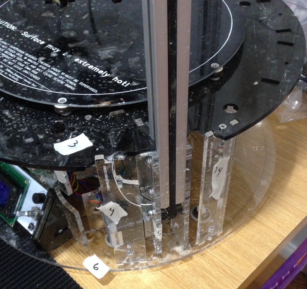

Hi all,

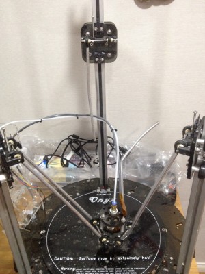

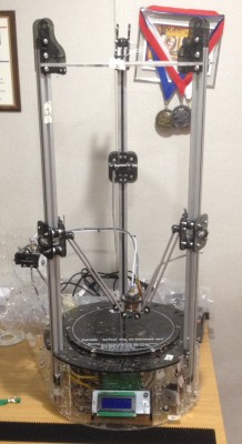

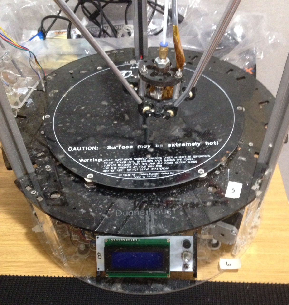

I am brand new to 3D printer ownership, I was given a Rostock Max V1 from a friend. Unfortunately this printer had gone through a EF2 tornado and got banged up!
ROSTOCK V1 vs EF2 Tornado Round 1
All of the electronics work so the damage is structural. The original owner updated the arms to the current setup. But some of them broke and need to be replaced. Also the vertical aluminum stock has lots of dings and scratches.
I am just looking for any advice or help getting this thing printing.
Thanks in advance!
Casey

I guess the best would be to buy a "wood only" kit, along with new arms, and towers.
If you want to make sure you order only one time and have everything ready for rebuilding, read the manual, and everytime there is a reference to a part that is not wood, make sure you have it, and it is not damaged.
You can already dismantle the printer anyway, as the wood only kit will be V2, but your machine is V1.

Seems like the mechanics would work aswell.
Try to get it running as it is. Even if you cannot get good prints you will know exactly what is wrong with it.

Thanks for the feedback. I forgot to mention that 14 of the plastic parts were broken along with 3 of the arms. How is the full upgrade kit to the V2? I was kind of leaning that direction....
Re: Rostock V1 vs EF2 TORNADO!!!
The full upgrade kit to V2 from V1 is your best, the least expensive option. Everything you would need are in the kit, except for the aluminum uprights.galesc wrote:Thanks for the feedback. I forgot to mention that 14 of the plastic parts were broken along with 3 of the arms. How is the full upgrade kit to the V2? I was kind of leaning that direction....
I used to have a V1 made from the clear plastic like you have there and you will not be able to find the clear plastic repair parts for the base or the top.
The clear plastic is very brittle and cracks easily, that is one of the reasons that they quit making them.
If you feel that your uprights will work even with the dings and scratches then I would reuse them. If you not feel comfortable reusing them then let me
know and I will send you a couple of links on where to get them. Please let me know what other help you need or questions you may have, I definitely would like
to help you get this printer running at the least cost possible.

Thanks All, will do. I'll try to salvage the vertical posts maybe rotate them 90 degrees. I would like to repair this printer in a "cheaper" way. So I was contemplating getting the Laser Cut Wood parts only instead of the full upgrade and re-creating or buying these arms.

My friend who is in the advertising business uses chloroform to chemically weld plexiglass.
As i said, stick it together with spit, glue or duck tape and get it moving.
Test the temperatures, chexk all the motors. Check the usb connection and the ability to read from the sd card.
As you said, your plexi parts are gone, the towers do not fair well, there may be some other errors (your bearings for the cheapskates may have rusted aswell). So basically right now you have 4 motors, and a rambo board, arms and a hotend.
If not you may find yourself ordering hotend resistors, motors, and even a new controller and lcd. And in the end you may be better off buying a complete kit.

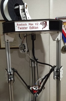

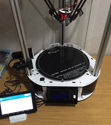

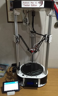

So, it's been a month and I've been printing for a little while. Well when you hit a Rostock V1 with a EF2 you get a Rostock Max V2 Tornado Edition!
Thanks all for the help with getting this printer going. Now I just have to figure out how to get great prints from this thing!

Nice job on the conversion. Can't even tell its the "same" machine!

Thanks. All I really used from the first version was the electronics and hardware!

What a difference from the tornado version.
Very good job!
