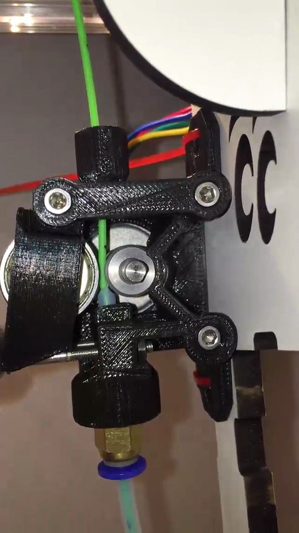

1. I have a new feeder. http://www.thingiverse.com/thing:126778 I found too much jamming and stuff with softer filaments on the stock feeder... Even with the PTFE tube in there.
However, even on the airtripper i found some jamming as well. So I had to drill out a hole for ptfe tubing there too... Now it seems to be running pretty well.

What im noticing is this. - [img]http://i1132.photobucket.com/albums/m562/dunginhawk/th_1A91D3DA-07F8-40DF-BB0A-8F0297AFE254_zpsg8738b4s.mp4[/img] as you can see the black mark is moving, then stopping, then moving again.. but the entire time the drive gear is continuing to move... would this be some setting i am missing? perhaps the extrusion multiplier?
Also, i think part of my problem MAY be the spool of ninjaflex itself.. its wrapped in such a way where the filament often gets wedged between other layers on the spool and it requires more force than usual on the drive gear to pull that loose. With the TINY variances with soft filaments causing major differences, its a thought.
One other thing im trying is a fan on the stepper motor... Its cool as the other side of the pillow now. It certainly cant hurt. Thanks Ben
Last thing im trying is i am running the tensioner for my feeder at its loosest setting possible. just enough to contact the filament with the bearing, but not enough to make anything work that hard.
oh and one more thing. I cut a little length off the PTFE tube in the feeder to allow more contact with the gear.
Ill certainly keep everyone posted on my results.
