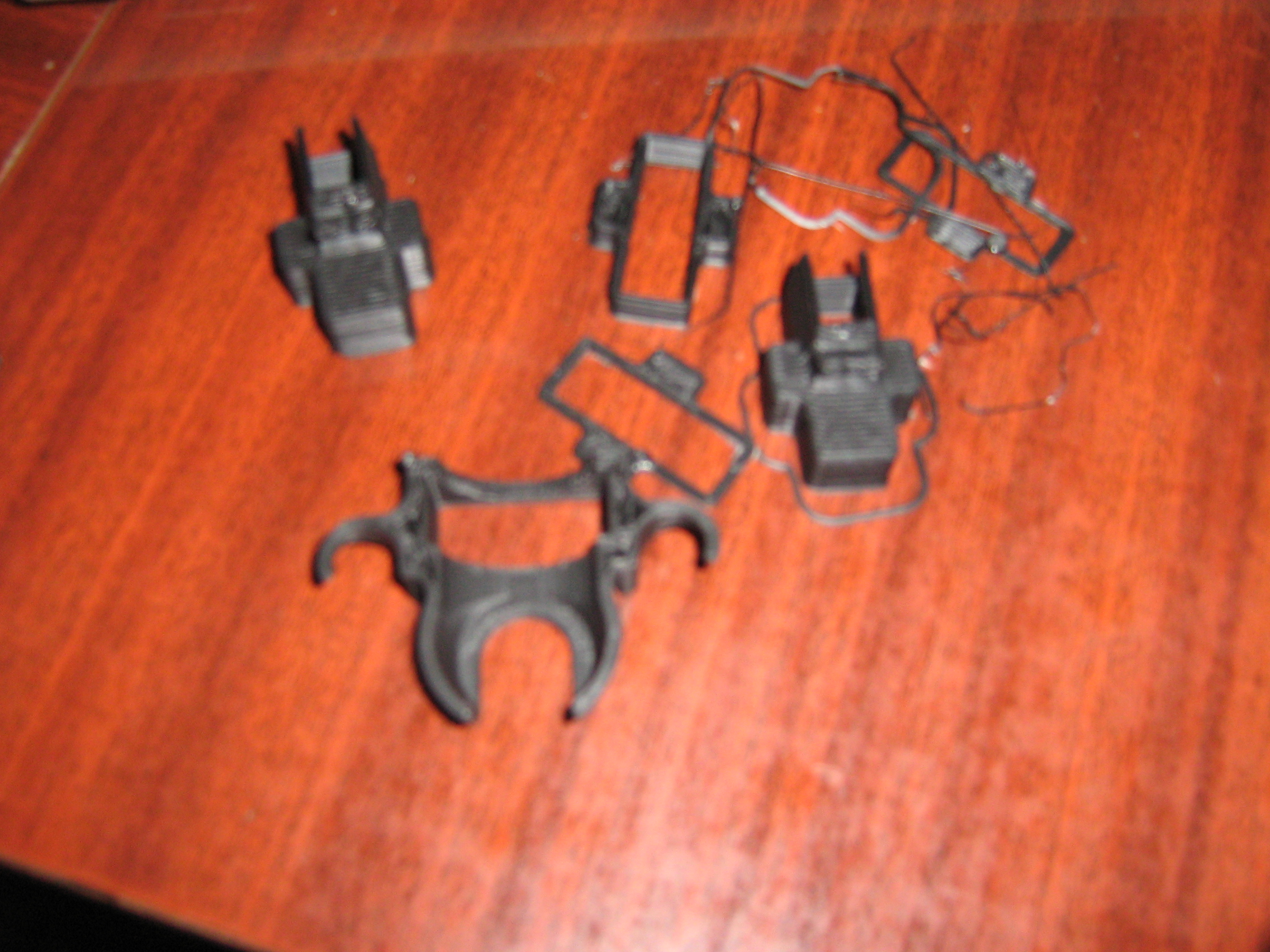

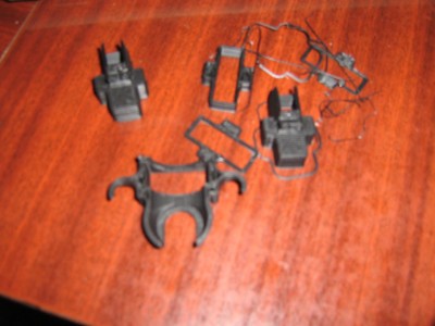

I don't know what to do.
MAX 2 can stop working in any time without any reasons.
Just stop in a 10% , 30% ,60% model not completed.
No have any warnings. Looks like working but no movement

its look like press on "pause" but without pressing. Running with computer. I cant move MAX2 by computer with this problem, but can push a reset button on printer, works fine, all towers return to upper position.
Not all fan installed , I dont know running or not .I'm still not finishing second fan. I try print it 5 time !
