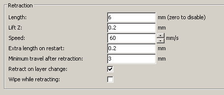

What are your retraction settings? If you retract PLA too far it can jam on restart.

0110-m-p wrote:What are your retraction settings? If you retract PLA too far it can jam on restart.
- Retraction Capture.PNG (6.04 KiB) Viewed 13251 times

try changing your retraction length to 3 mm.

Testing that. I believe I increased it because I was getting a LOT of stringing as the head moved between locations.Mac The Knife wrote:try changing your retraction length to 3 mm.

That's what I hate about pla,,,, but if your retracts are to long, it creeps up the heat break and solidifies.

Yes, but I was also getting this while printing a single-wall vase form. So the retraction can't be my only issue since I believe that never retracts.Mac The Knife wrote:That's what I hate about pla,,,, but if your retracts are to long, it creeps up the heat break and solidifies.

Printing the fan shroud part has helped immensely. I'm guessing the heat was creeping up the hotend. I still have the retraction high but it has not jammed recently. Also I ordered more PTFE tubing to replace the piece in the hot end for a better internal seal.
