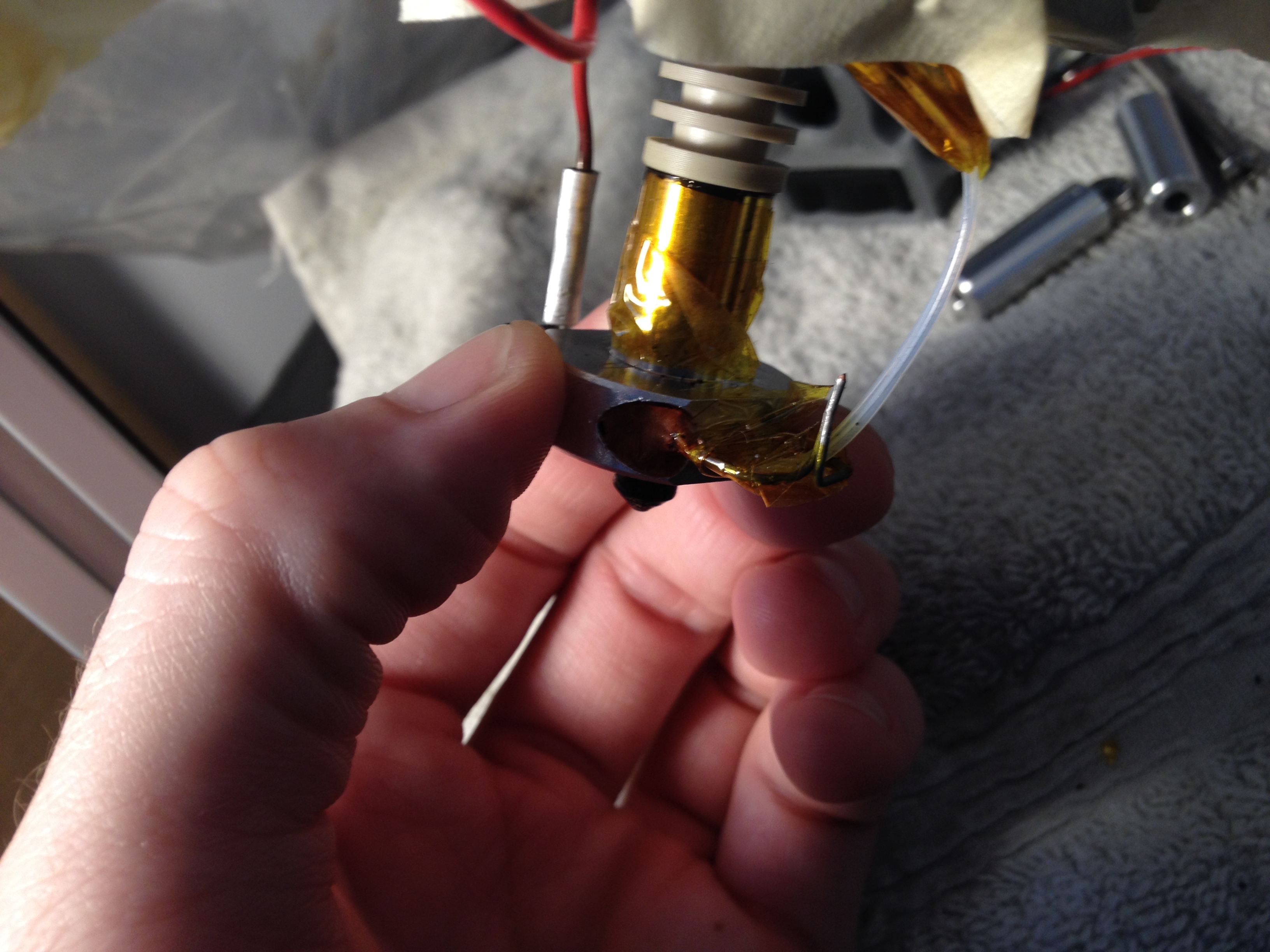

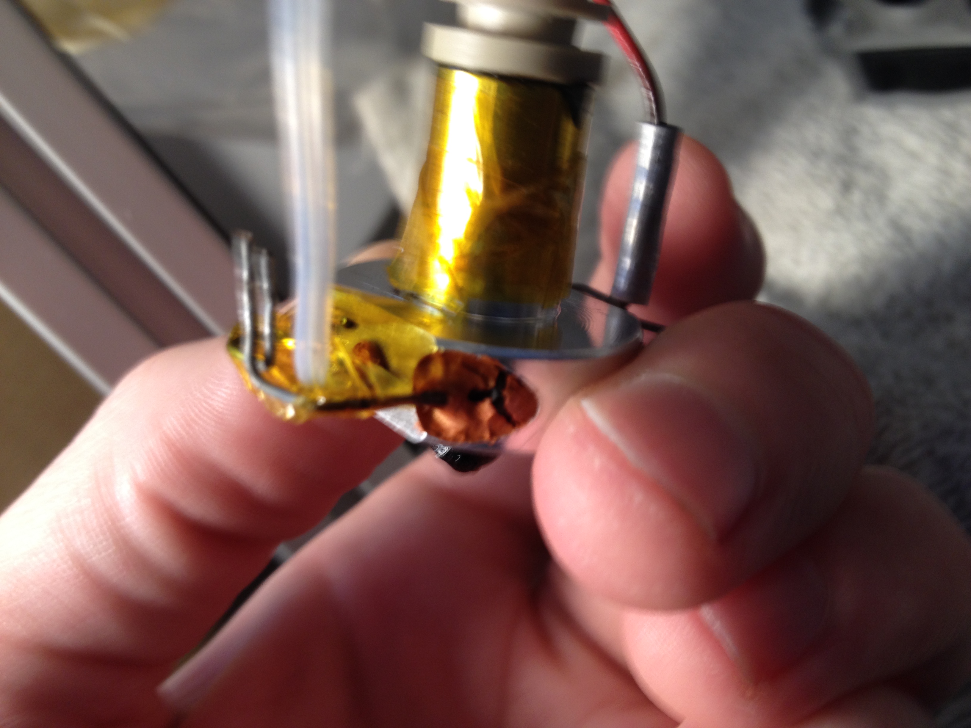

Well it seems the wires got hot and melty right where the uninsulated crimps are near the hot end. Hmmm. Wonder why that is. Gonna redo them and see how long it lasts.
This is actually gonna be pretty tough to fix without damaging the thermistor or resistor leads. :|

Well here we go! This was wayyyyy too easy to remove. Oops :oops:.
I also filled in some RTV where some cracks had developed, per guanu's expert advice (he really does know his stuff).
I actually did fill it in, you'll just have to trust me. I'm not gonna wait til it'll cure. I'm sure with 240C it'll cure in no time! :)

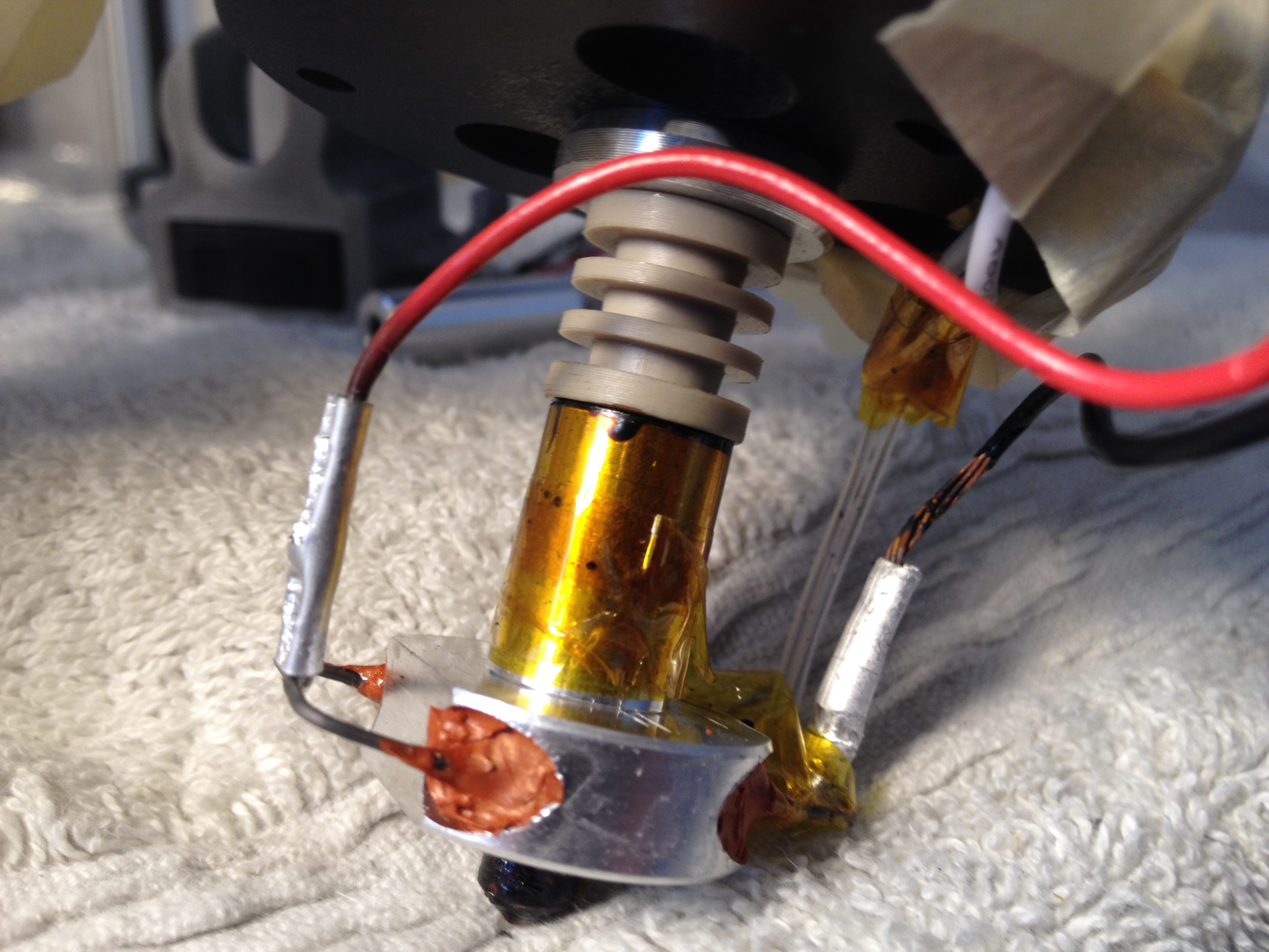

I crimped it back together and this time it won't slip off! (DOH!!) Well, it didn't fully slip off by itself, but I could pull it off without much effort haha. I tested the resistance and it is hovering around 3-4 ohms. That's bang on right?

The crimps I got this time were a snugger fit to begin with, and I wasn't afraid of damaging anything this time (cause what have I got to lose, right?) so I squeezed extra hard. I actually remember when I did the crimp originally thinking (meh this isn't great... let's see if it'll last.)
Follow your gut.
I couldn't get the red off without mangling everything, so I left it as is. It's a bit blackened, but not like the negative terminal was. So hopefully it gives me enough time to finish this print.

Aaaaaaaaaaaaand we're printing again! :) It's working just the way it's supposed to for now. I also oriented the hot end in the effector so that the wires had plenty of "air cooling" (as much as theyd get being there) and kept it away from the nuts, screws and fan shroud. Should be good to go.
Lesson learned. EVERY DETAIL COUNTS. Do every single thing perfectly or you'll be doing it again.
