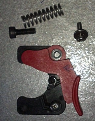

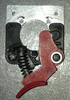

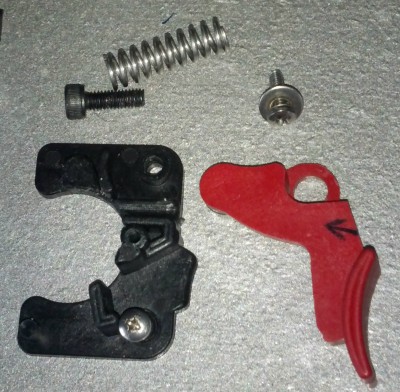

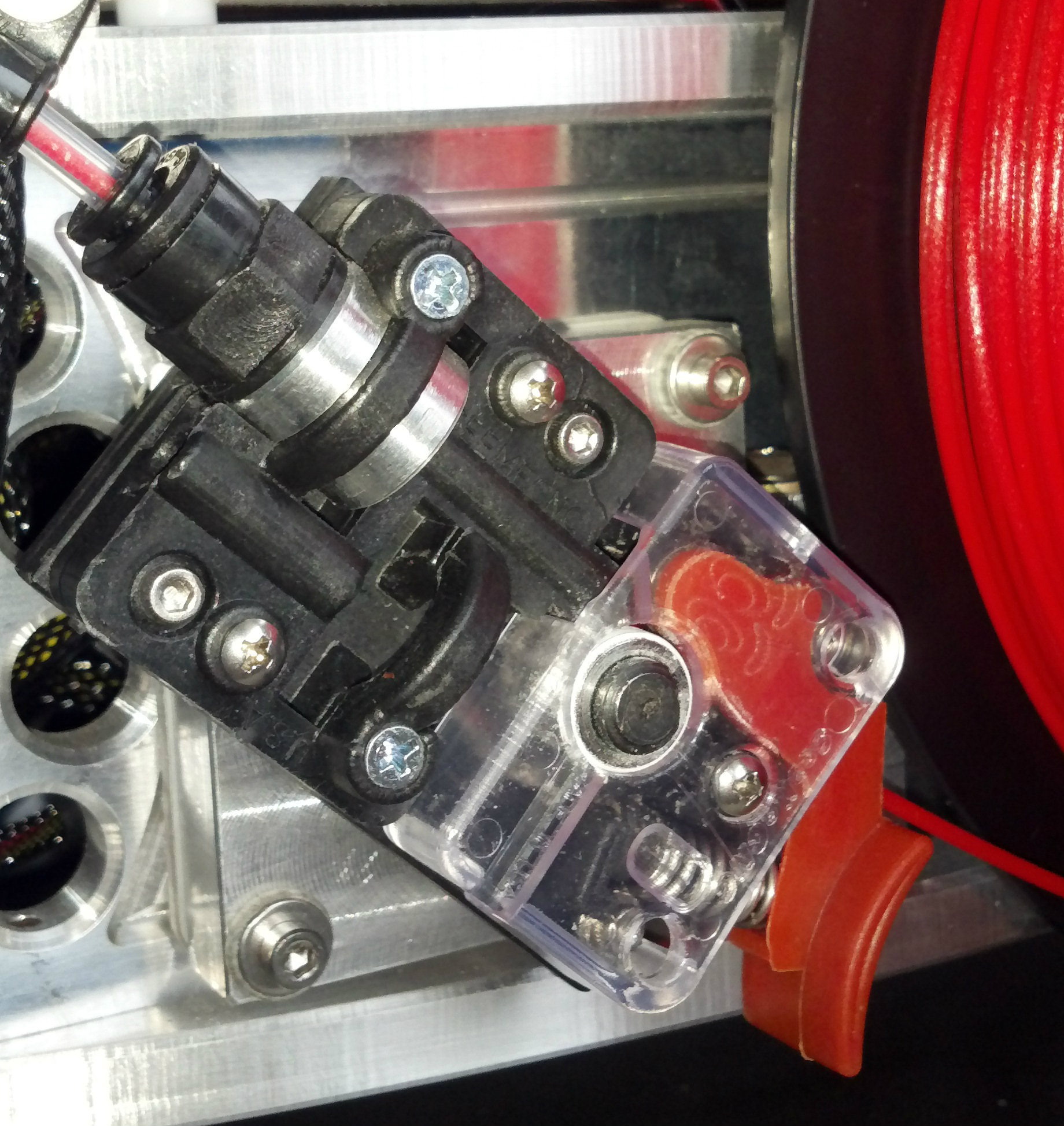

Mods/upgrades that will help the ezStruder push filament more reliably, particularly when running smaller than stock .5 nozzle ...
1. Add a M4 x 10 socket head cap screw to the spring to increase spring pressure. See photos.
2. Trim off the height of pivot boss for the red lever so it can not twist to the side. About .010" - .015" is all it needs, just so boss is flush with lever.
3. Replace the washer under the pivot screw with a larger diameter to help stabilize the lever.

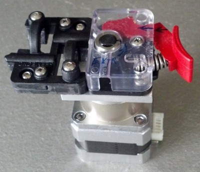

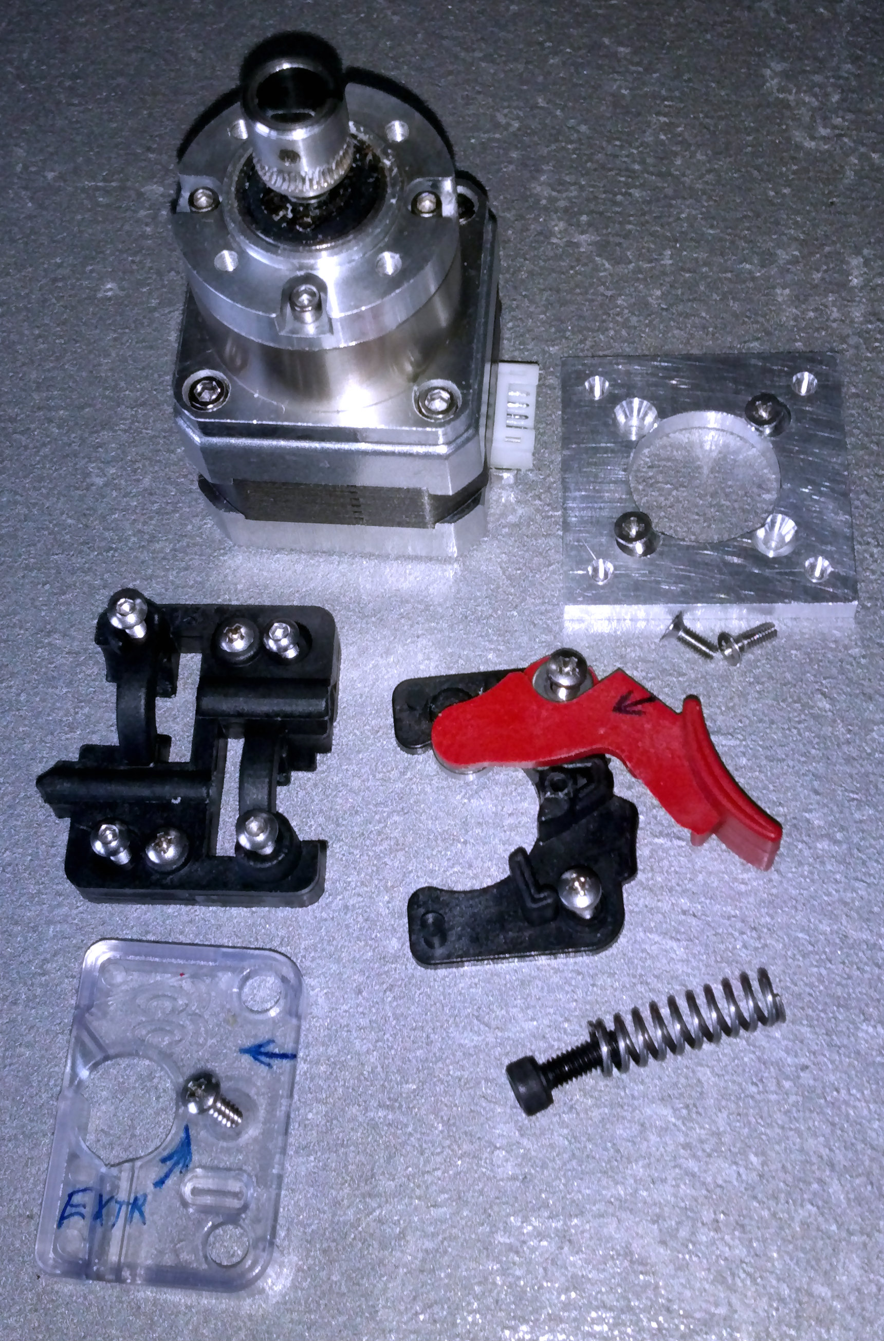

4. Replace stock stepper motor with a Kysan #1040222 5:1 geared stepper motor to increase torque. http://www.3dmakerworld.com/store/parts ... pper-motor

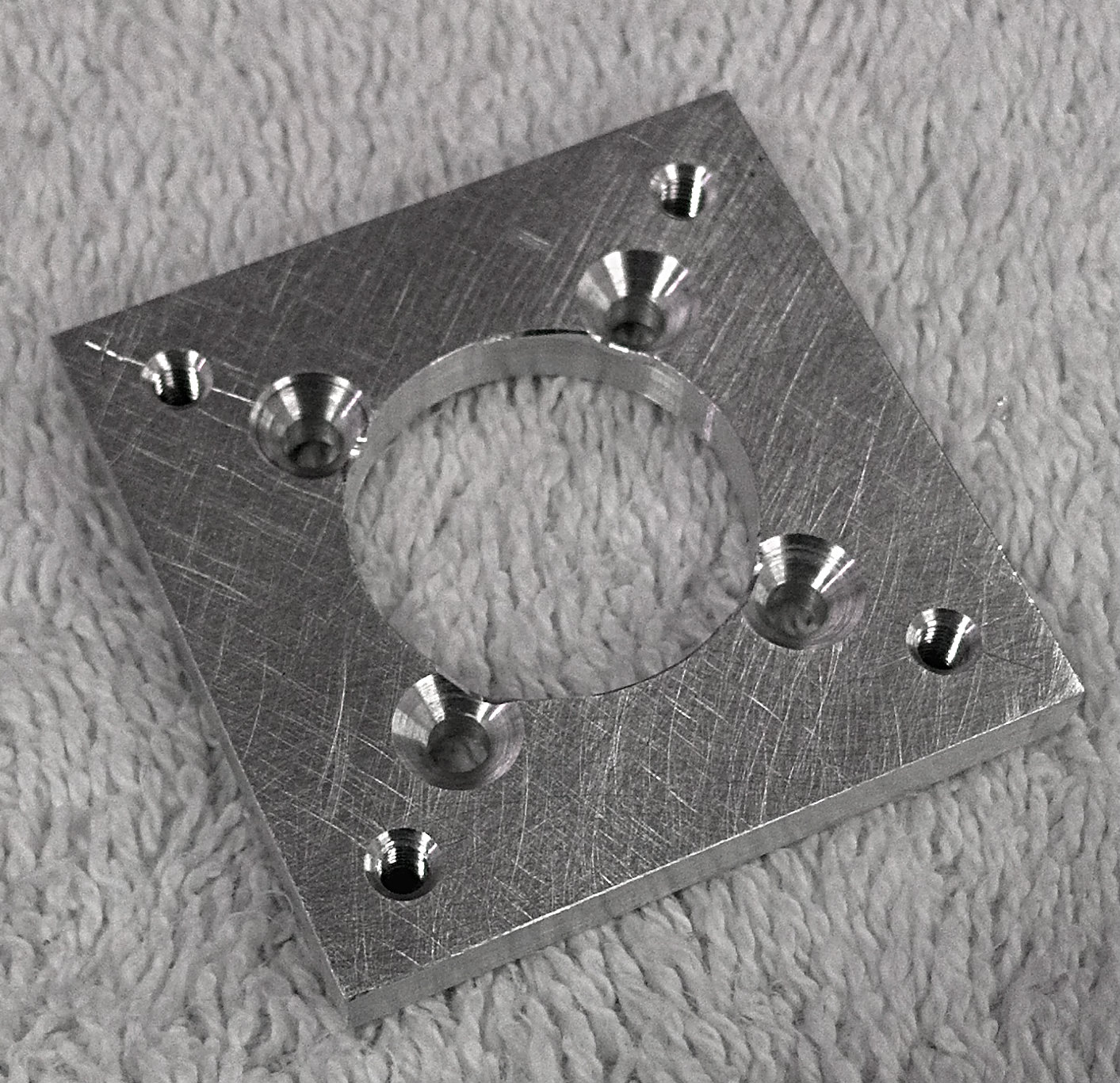

You will need to make or print an adapter plate for the geared stepper. Here is a printable one https://www.thingiverse.com/thing:131310
I machined mine from aluminum
The stock stepper has 76 oz-in of torque, the geared one has 125 oz-in
Note: the geared motor has a 8mm dia. shaft, stock motor is 5mm. So you will need to bore out the stock roller or get another one.
They are a bit hard to find with 8mm hole, see posts below for some sources. I carefully bore out the stock roller on my lathe.
5. Make sure you are running motor at proper amperage.
6. Replace the PTC fitting with a fitting that allows bowden tube to pass thru all the way close to the drive roller.

See the attached photos to hopefully clarify things.

Glacian, your right the shaft is 8mm instead of 5 like stock. Can't believe I missed pointing that out. Thanks for the catch. I will edit original post.
I bore the stock roller out to 8mm carefully on my lathe.
They are hard to find. Thanks guys for the other source links.
I have also bought 8mm drive rollers from Tytan 3D in Poland http://www.tytan3d.com/en/ I am also testing one of their all metal "Goliat" extruders on NEMESIS v2, so far it is working pretty good.
Note: the Tytan rollers teeth are not as nice as others, teeth are coarser and not as sharp. Still seems to work though.
Stock SeeMeCNC rollers I just measured are 12mm O.D. and 10.8 dia. at bottom of groove.
Tytan rollers are 12.5mm O.D. and 10.6 to 10.7 at bottom of groove, close enough to still work but you will need to test and adjust your steps per MM in firmware.
No matter whose roller you are using you need to calibrate it. Here is how I check it, make a reference mark with a sharpie on the filament, extrude 100 mm of filament and measure how far it really moves. Adjust steps per MM accordingly. You will need to send M302 command to allow extruder movement when hot end is not up to temperature. For a starting point my steps per mm with gearred stepper and SeeMe roller are 491.5
On the machine with the Tytan roller it is at 561.7 (either the groove is deeper or greater spring pressure of Goliat is smashing filament a bit more changing the effective filament drive radius. Maybe both.)
No matter what roller you have you should check the calibration. Not all actually feed the same, even from same mfg. Spring pressure, filament diameter and softness of filament does affect steps/mm just a little.

Either way should work, what you want is more torque and resolution. Planetary geared stepper is more compact, simpler and quieter than gears.0110-m-p wrote:So what are you guys thoughts on geared stepper motors vs. geared extruders with standard motors?
I've started developing my dual extruder setup and was planning on using a pair of richrap's modified greg's wade bowden extruders. Definitely the cheaper setup between the two.
If space is not a concern you could use GT2 belt and pulleys for gear reduction that is silent. Although belts, pulleys, and bearings can add up cost wise.
So the geared stepper seems like the simplest most cost effective way to go.

So the Phidgets is the better choice. For only $5.00 more I think it is worth it.
Plus you can probably order just (1) from Phidgets.
You can order direct from Kysan, but you need a $100 min order, which is 3 motors.
I like that it also has shaft on back that you could put a knob on.
The Kysan 1040222 geared stepper I have been using has 125 oz-in torque
But the Phidgets geared stepper has 225 oz-in !!
http://www.phidgets.com/products.php?product_id=3325
