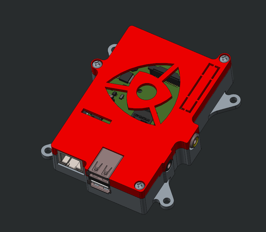

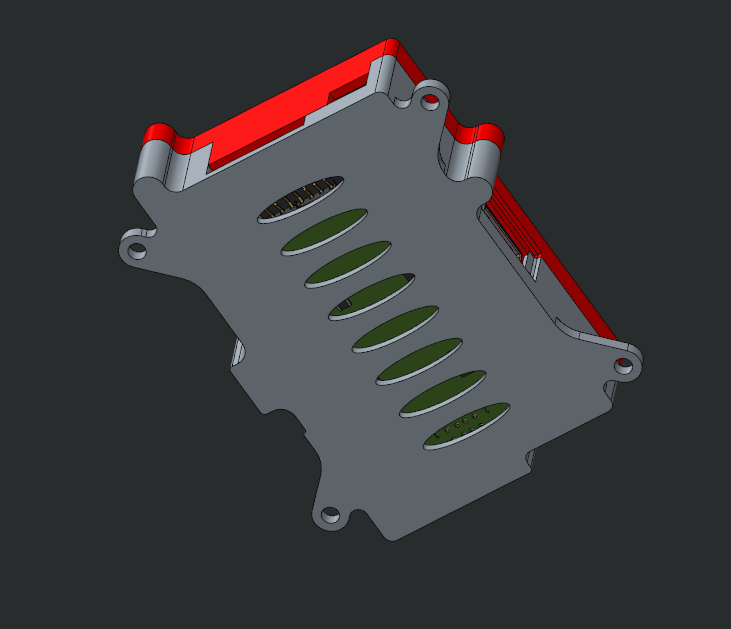

Been printing with the Raspberry Pi exclusively for a few weeks now so I thought I should go ahead and finish up this project. Not quite done with the design yet, but close now.
- Incorporated built in 75mm VESA mount holes
- Eliminated the SD card tray since I am using a flush-mount (super short) microSD adapter that doesn't stick out. (http://www.adafruit.com/products/966)
- Made it so that the top and bottom shells screw together rather than friction fit.
- Made it so that the Raspberry Pi mounts directly to the bottom shell with screws through the holes in the PCB.
- Changed the top and bottom cutout styles
- Fixed all the geometry issues with the original design that I didn't care for

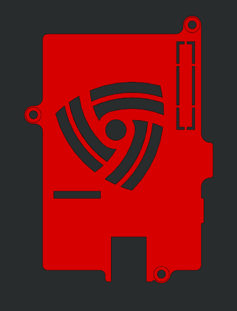

Just printed out the new base plate...made some tweaks and am reprinting the new version now.
[img]https://farm9.staticflickr.com/8638/16077161942_12b893374b_h.jpg[/img]
Also, changed up the top vent design a bit...thoughts?

Looks like a pretty good case design :)
I have tried astroprint and octoprint with the pi and I would not mind trying yours when you get around to placing something online :)
Bob
Delta's are the way!
