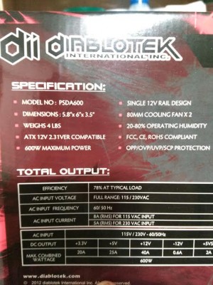

Hey! I wanted to see if you had an update to this, as I'm having the same issue. I successfully completed the PID autotune for the hotend and the bed separately, and either one will heat up fine on it's own, but as soon as I heat them both up together for calibration, the whole thing shuts off in under a minute. This is the power supply that came with my kit. I would love to know what PSU you ended up trying and if you managed to get it stable. Thanks!!cplbob wrote:That's what I thought, but I wasn't 100%. Before I got it up and running I was torn between some kind of short/defect in the heated bed or insufficient power supply being the cause of the malfunction. Based on what I've seen, the PSU that came in my kit just wasn't enough to power the whole printer on its own.
Re: Rostock Max V2 Shutting Down on Heatup UPDATE
I'm also curious if you had an update. My Newly assembled V2 with the 600w Diablo power supply was shutting off during the heated bed auto-tune. I removed the plastic lower covers and was able to heat the bed and nozzle without any issue. I'm guessing there's not enough airflow to keep the power supply happy. The only thing I did with my build is I used 2 18ga wires in parallel for the heated bed instead of the single 18 ga wire as in the directions. Maybe I'm pulling too much current and See Me CNC used very small wire in the directions on purpose?shentheory wrote:Hey! I wanted to see if you had an update to this, as I'm having the same issue. I successfully completed the PID autotune for the hotend and the bed separately, and either one will heat up fine on it's own, but as soon as I heat them both up together for calibration, the whole thing shuts off in under a minute. This is the power supply that came with my kit. I would love to know what PSU you ended up trying and if you managed to get it stable. Thanks!!cplbob wrote:That's what I thought, but I wasn't 100%. Before I got it up and running I was torn between some kind of short/defect in the heated bed or insufficient power supply being the cause of the malfunction. Based on what I've seen, the PSU that came in my kit just wasn't enough to power the whole printer on its own.
I also noticed the power supply doesn't make much noise when heating the hot end, but when heating the bed it emits a very high frequency, almost inaudible screeching sound. I also noticed the stepper motor is blocking the exhaust of the power supply. All my motors seem to be turning in the right direction, so maybe this airflow obstruction is causing problems as well.

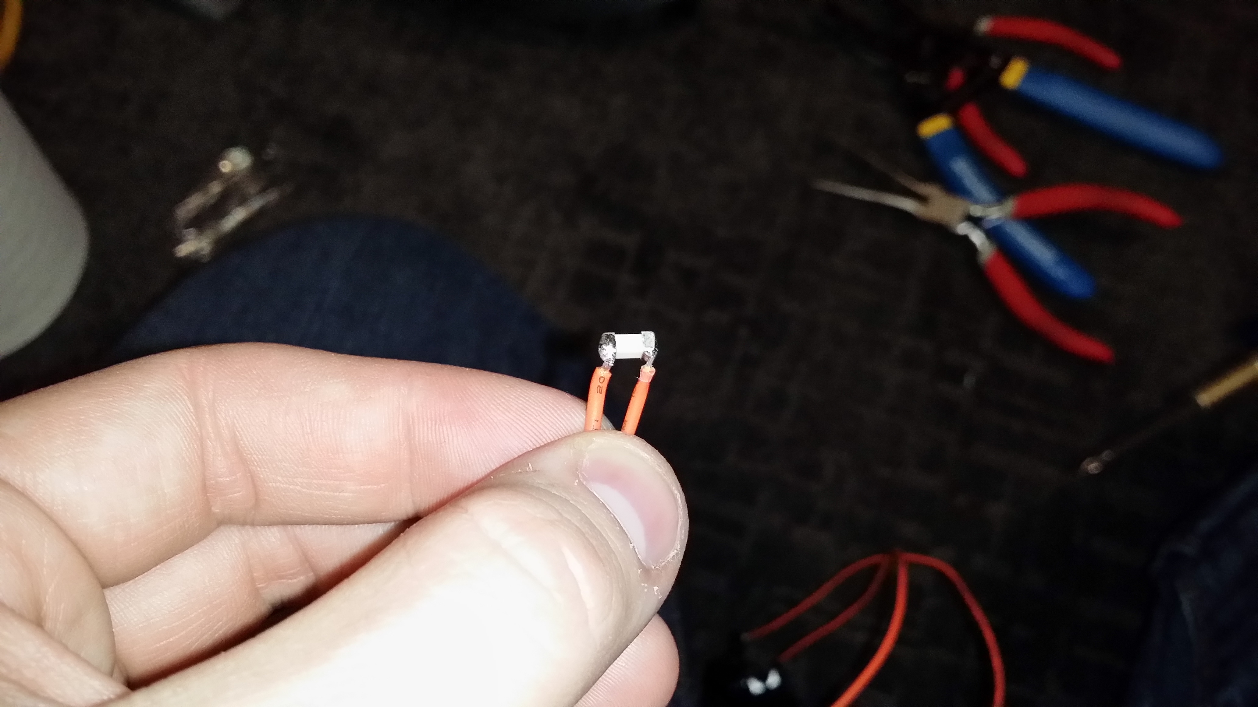

After removing the plastic covers I was able to calibrate the heated bed and calibrate the towers. Shortly afterwards, the unit shut down. I'm thinking I also have a power supply issue.
I've read on this forum that the power supply is more likely to work correctly if the 5V rail has some load on it. Has anyone tried to load the 5V rail to resolve this power supply "instability" issue?
It looks like the problem isn't bottom end cooling. Even with the panels removed and only a single 18 ga wire going to the bed, the unit still shuts down randomly after a few minutes. After looking at the Amazon reviews for this power supply I'm not too surprised. There is a 1 star review with multiple failures for each good review!
Hopefully See Me CNC will be able to get me back up and running. I'm cringing thinking about trying to replace the power supply now that the unit is fully assembled and calibrated!
