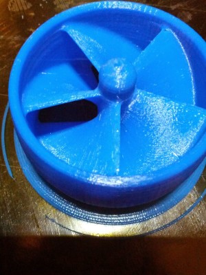

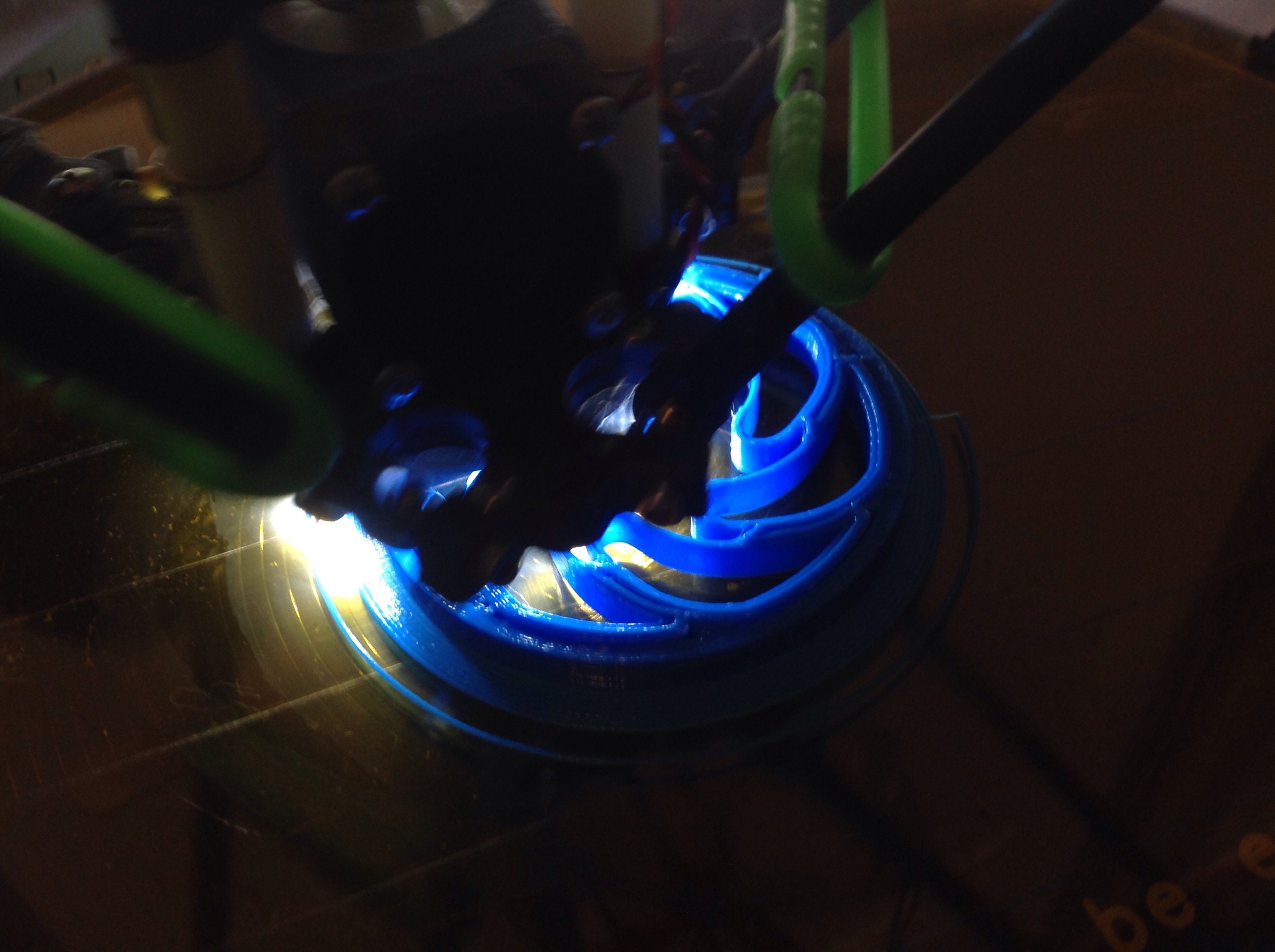

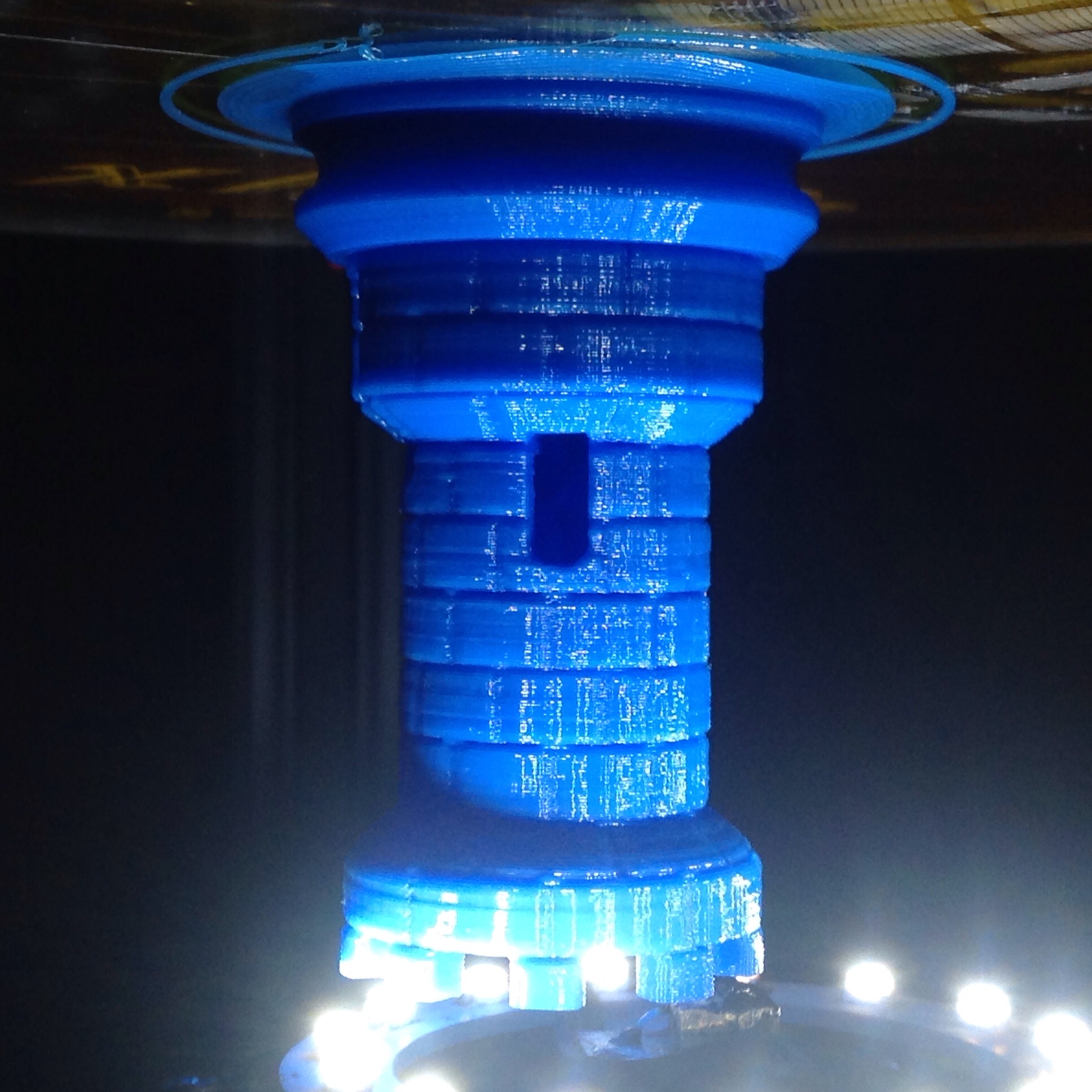

So I read the entire "weed trimmer" line thread several times and gleaned a lot of useful info. I am making beautiful blue prints with it. I love the stuff. Cost per pound is very reasonable. Yes you have to dry it and keep it dry, but these forums gave me all the knowledge I needed for that.
Only problem is, did I mention it is blue. Unlike Cope413, I don't see me cncing out 30 pounds of the stuff all in blue.
For those unfamiliar with the topic, blue is the color code for .065 inch trimmer line.
My whole reason for this post is to get enough people exited about nylon that we can create enough of a market to make it viable for Desert Extrusion to extrude some more colors including natural.

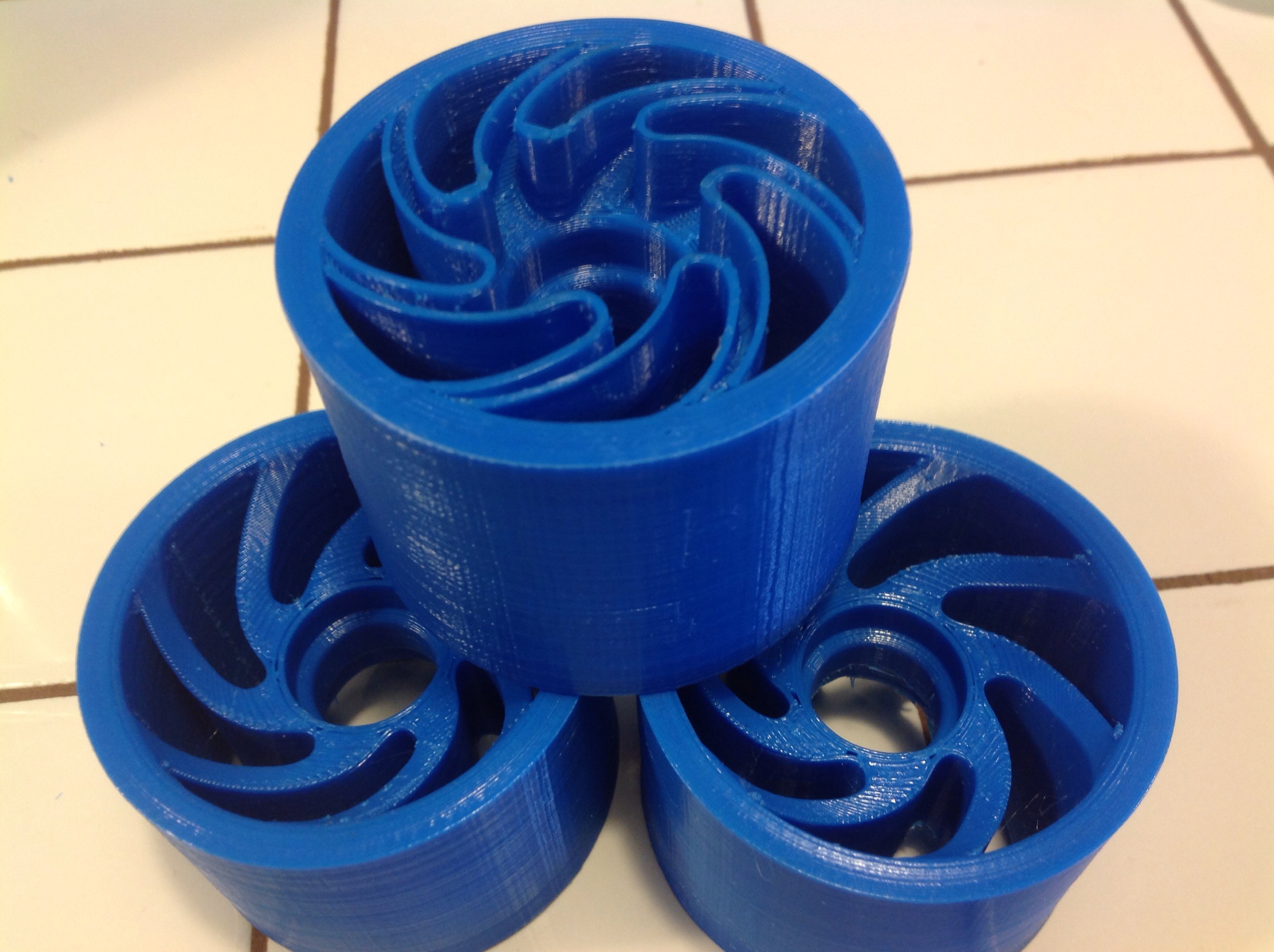

Skateboard wheels.
Skateboard wheels.

Damn those are some good looking prints, would you mind divulging your settings and nozzle and such?

Also, what are you printing on? Looks like a sheet of PEI based on the yellowish tinge, but wasn't sure.
Nylocke
Posts: 1418
Location: Iowa
Re: Desert Extrusions Nylon
Post by Nylocke »
Probably a sheet of Garolite. Nylon sticks nicely to it.

Looks like Kapton to me.

DavidF wrote:Damn those are some good looking prints, would you mind divulging your settings and nozzle and such?
TRIMMER NYLON
260C Extruder
80C Bed (I am currently using 75C for the bed per Cope413 settings.)
gluestick (UHU because I had some.)
E3D Hot end
.4 mm nozzle
.2 - .4 mm layers (rook was .2 wheels were done at .2 .3 and .4)
6mm retract eliminates just about all of the spiderwebbing. COPE413 uses 12mm if I remember right. He uses a larger nozzle so that makes sense.)
If you need anything out of my slic3r settings, let me know.

Mac The Knife wrote:Looks like Kapton to me.
Kapton tape is on the flip side of the glass. I have UHU gluestick on the top.

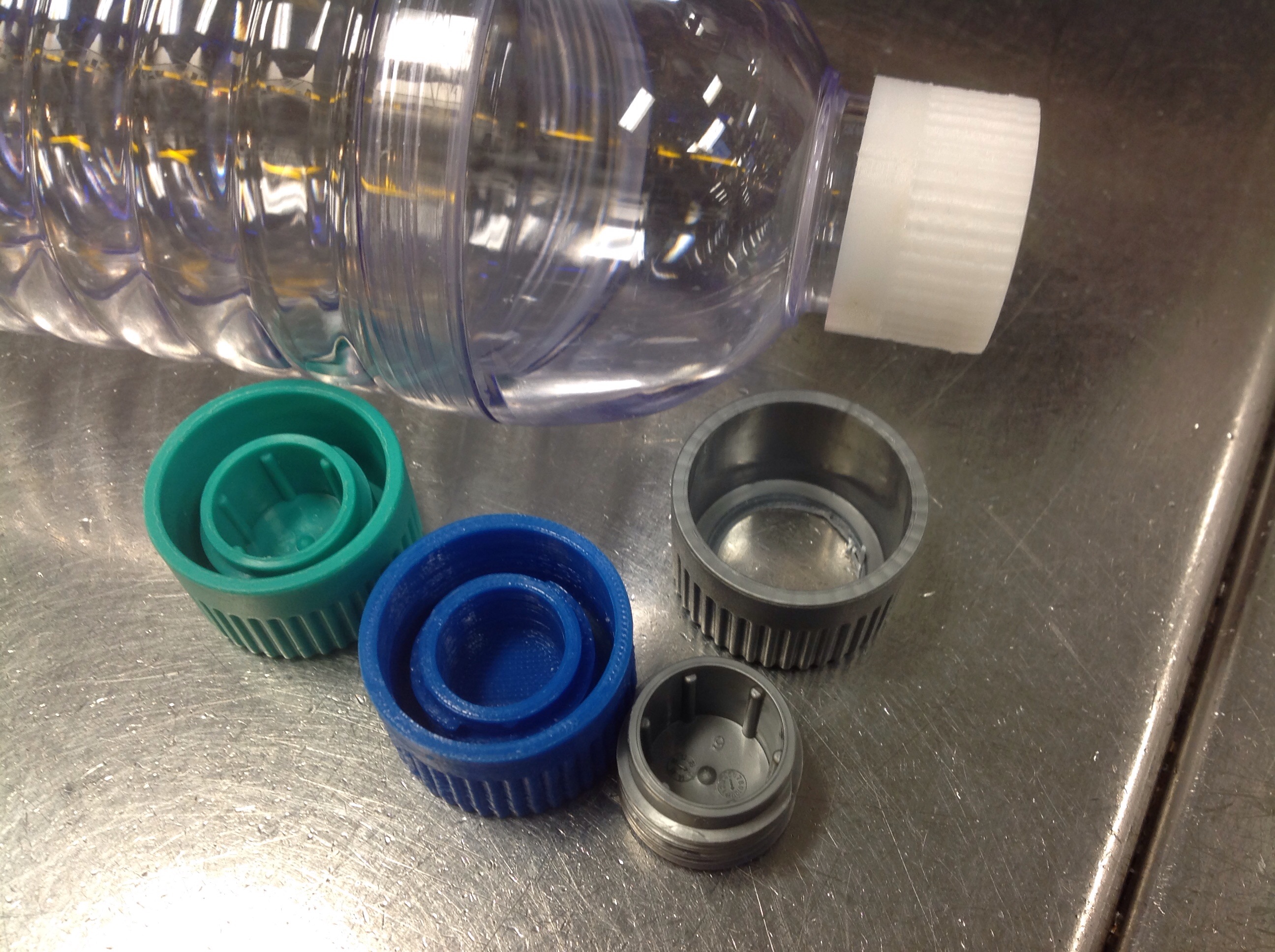

So we bought these really nice reusable bottles made by Aladdin. They unscrew at the bottom of the top bell for cleaning/putting ice in. The problem was the center posts of the caps crack and get pulled down the neck of the bottle. I.E. The silver cap. Teal colored cap is cracked also.
Hmmm.... Print Challenge!
Drafted in Autodesk Inventor.
White Cap is Taulman 618. I figure if it is safe for human implantation it is probably safe for a bottle cap.
Blue cap is Desert Extrusion blue. No claims of human safety here but dang it prints nice.
Keep in mind that FDM printed things are food safe, ONCE. Bacteria can lurk in the spaces between the layers and once exposed to food/water/etc. it's no longer considered "food safe".

geneb wrote:Keep in mind that FDM printed things are food safe, ONCE. Bacteria can lurk in the spaces between the layers and once exposed to food/water/etc. it's no longer considered "food safe".
If you print with enough perimeters to ensure a good wall, then finish with your method of choice (chemical or abrasive) to an acceptably smooth surface finish, it should be reasonably safe for personal use. If I finished a part through 400/600-grit abrasive and I was confident it was truly watertight (so nothing got into the infilled regions), I'd be OK putting a cap on my kids' water bottles.
(wearing my day job hat (technically, hairnet then hardhat) - manufacturing engineer at a big food company, so I'm familiar with principles of sanitary design)
I'm not going to argue with you about that. I was making really nice 5 micron filter caps with slic3r. Switched to cura and the parts are as solid as FDM can make them. Still I'm sure there will still be voids.
Not even once, unless you're printing with material that was certified food-safe by the manufacturer. Who knows what contaminants are lurking in that plastic that are irrelevant when the plastic is used for it's intended purpose.
Here's a link I have bookmarked about food safety: http://forums.reprap.org/read.php?1,164077,168351
Of course it's still up to you about personal use. You only have to worry about legal consequences if someone else gets sick.
