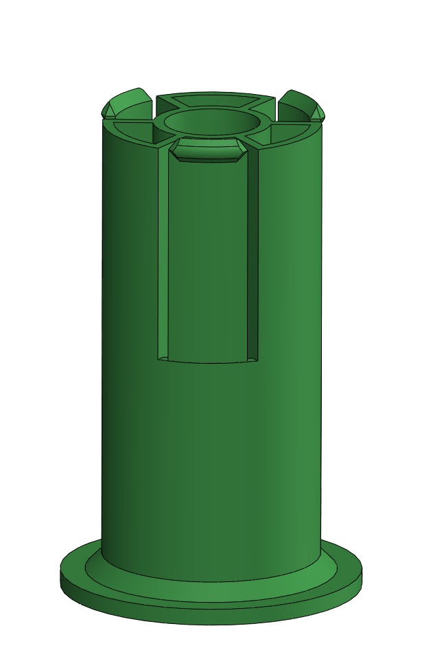

The SeeMeCNC Spool Hub. Made for 1/2" white PVC pipe.
Download, Slice, and Print your own!
SeeMeCNCFilamentSpoolHub.stl
SeeMeCNC Spool Hub
(384.16 KiB) Downloaded 330 times

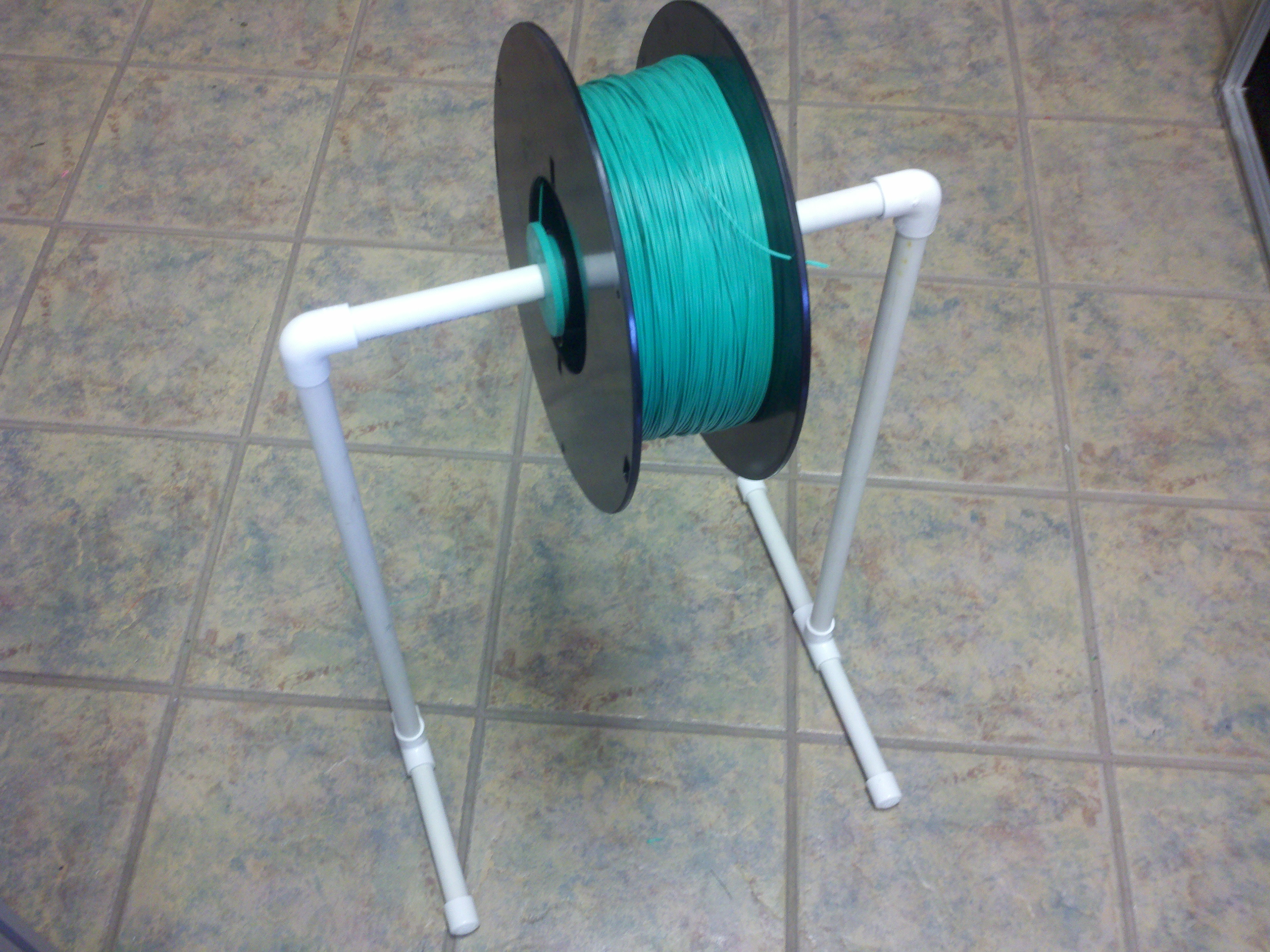

SeeMeCNC Filament Reel Hub for 2lb or 5lb spools
The 1/2" PVC stand uses
> One 10 foot piece of 1/2" white PVC
> Two 1/2" T's
> Two 1/2" Elbows 90 degree
> Four 1/2" Caps
The Upright pieces are cut approximately 24" long. The horizontal piece is cut about 16 inches.
The SeeMeCNC filament reel with Hub, Stand, and 5 pound spool of filament!
