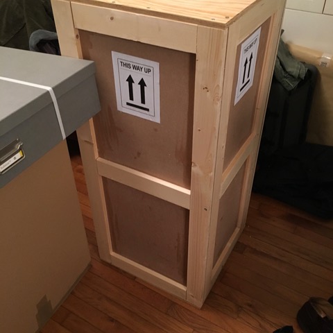

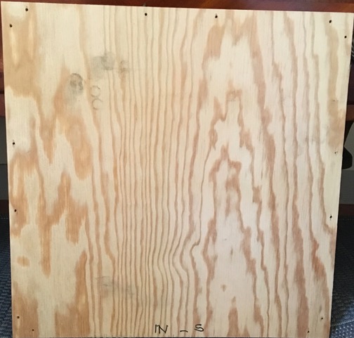

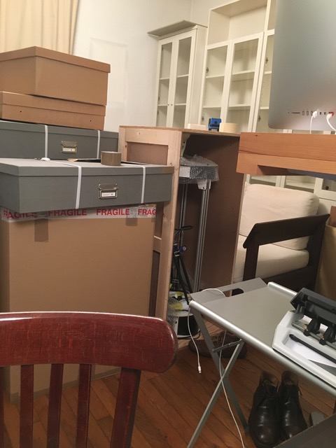

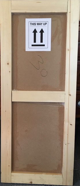

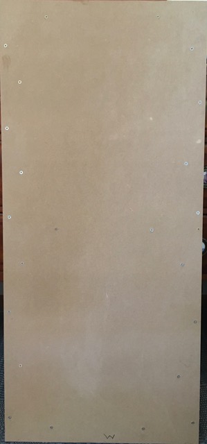

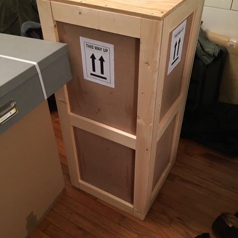

The box I made for my V2 is far too robust and heavy
but it worked
chipboard sheet: 4 panels
vertical beams: pine wood
screws: q.ty 48 4x20; q.ty 10 4x45; q.ty 20 4x75
glue
Material cost = 150 €
Construction time = 8 hours
Weight = 18 Kg
drawings notes: dots are indicating screws positions, dimensions are in inches/mm
