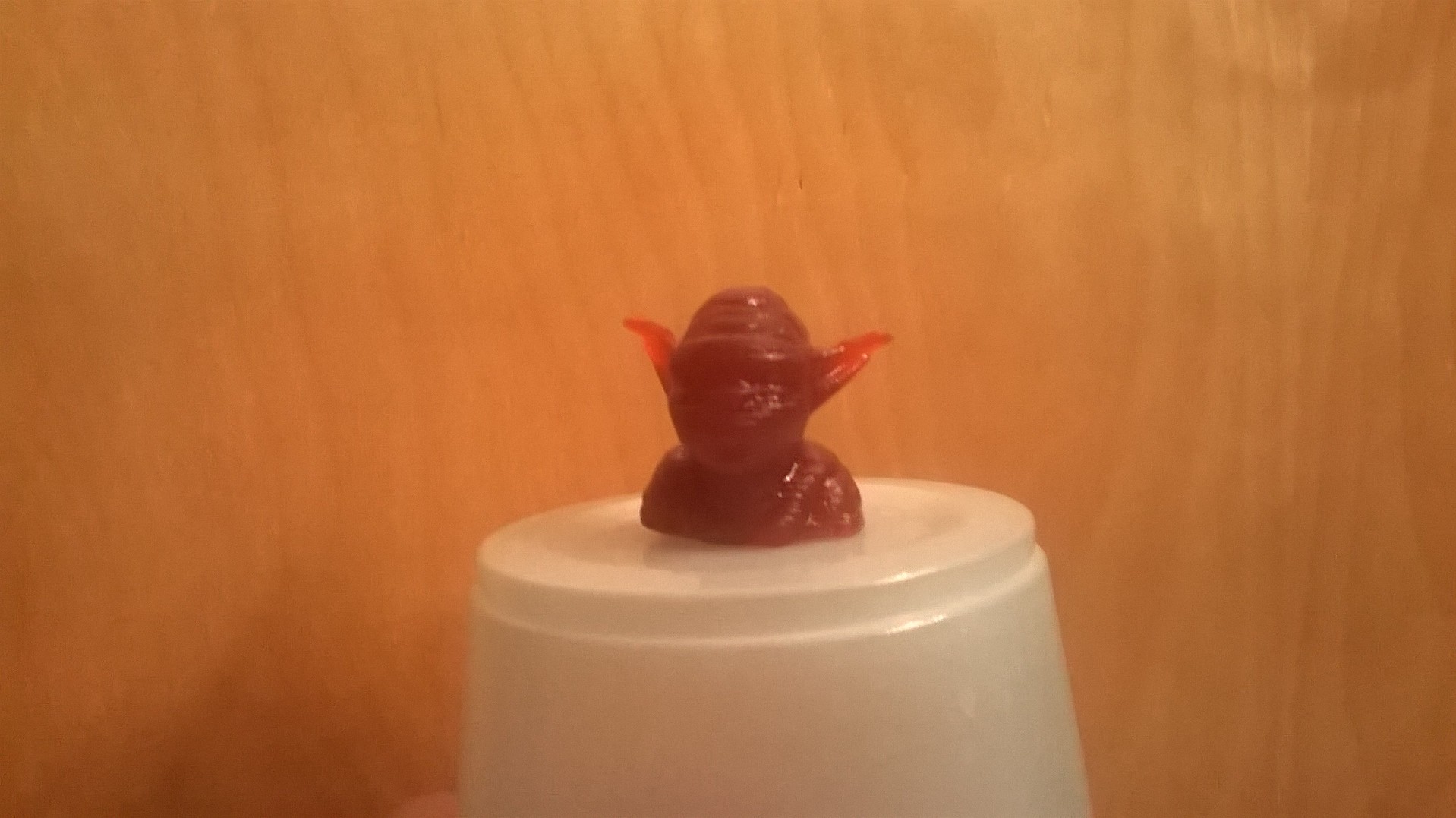

So, what kind of image time should I be setting in the Creation Workshop software. The default was two seconds, but I bumped it to 5 for testing and it seem to work... but I'm going to lower it back to find the limits.
Here is the first print... took about 2 hours and 45 minutes. Bill
