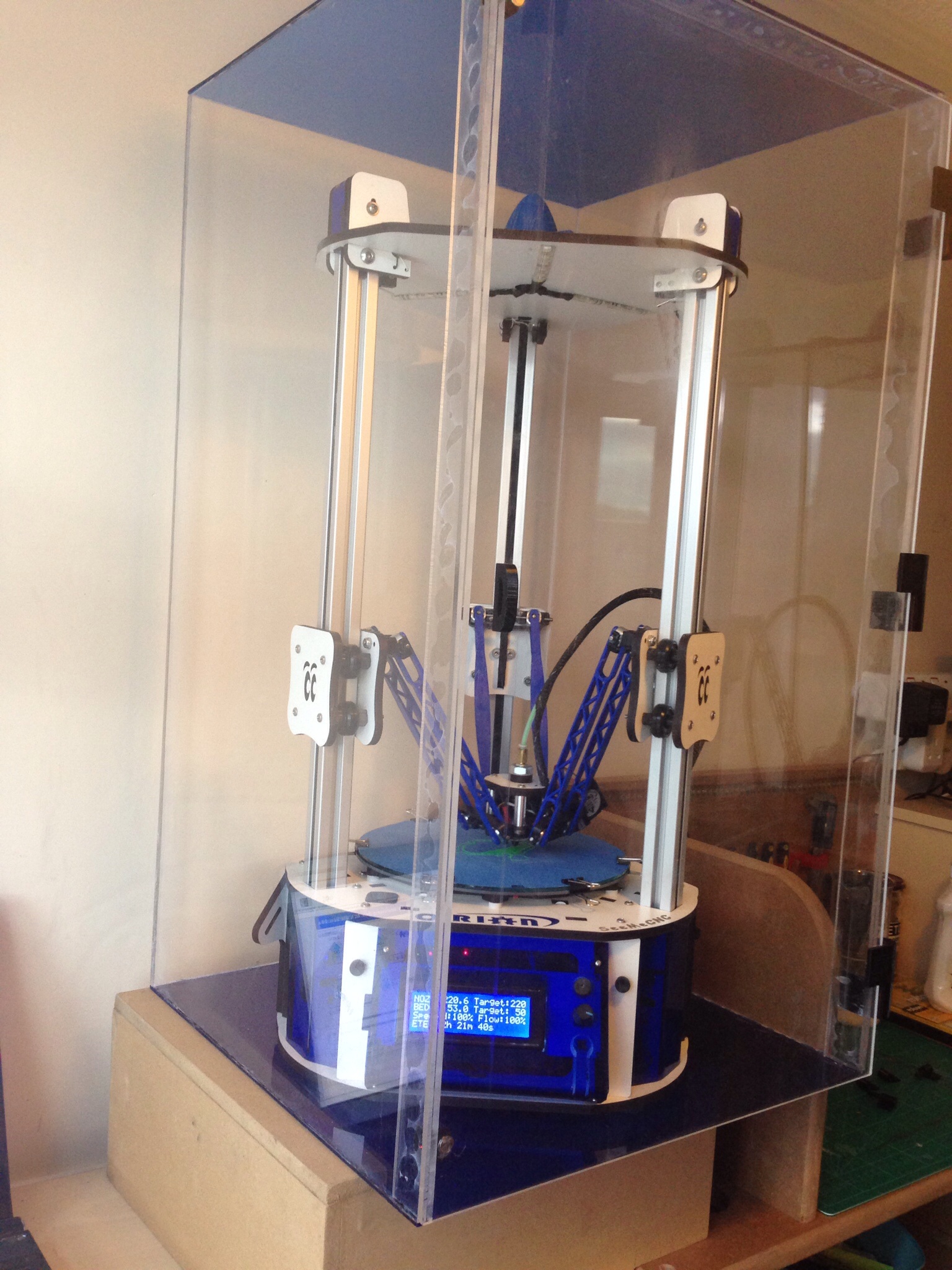

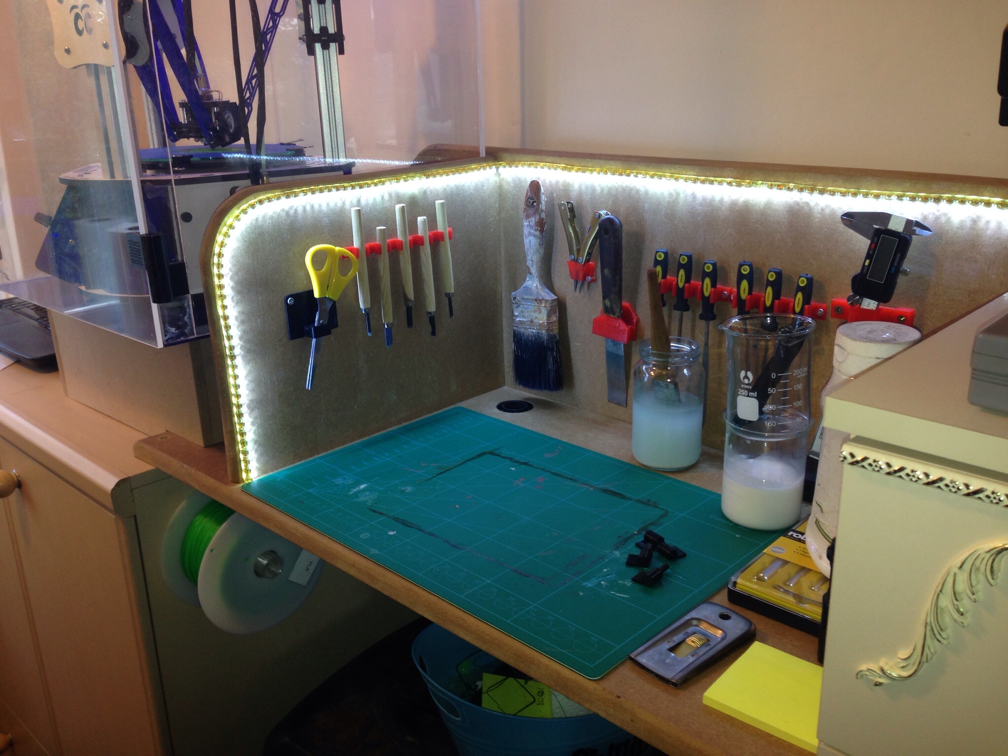

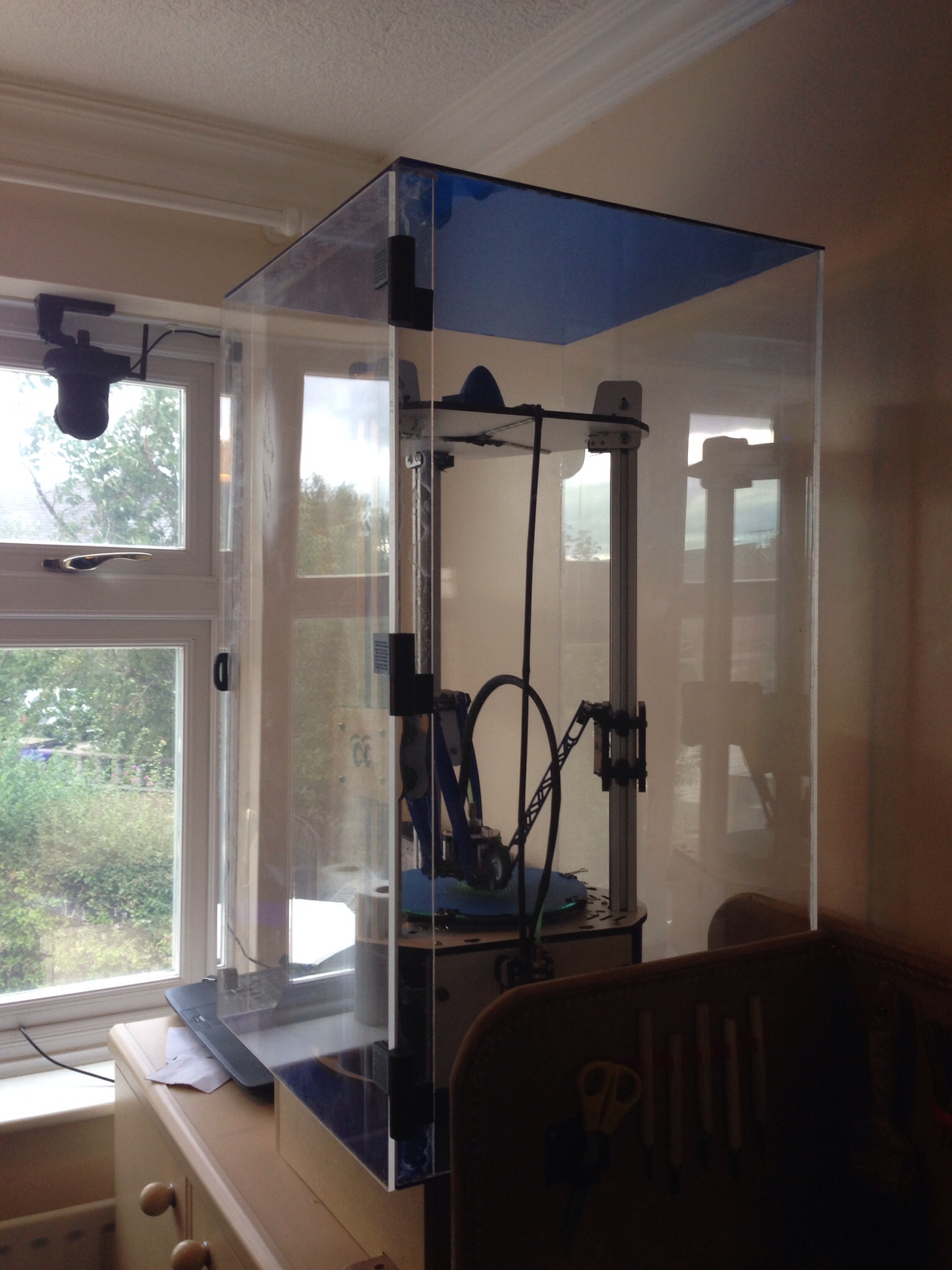

This is my printer! I've had It for around 4 months and have pretty much modelled the room around it! This is my first 3D printer so I didn't want to go down the kit route at the time but now I feel confident I could.

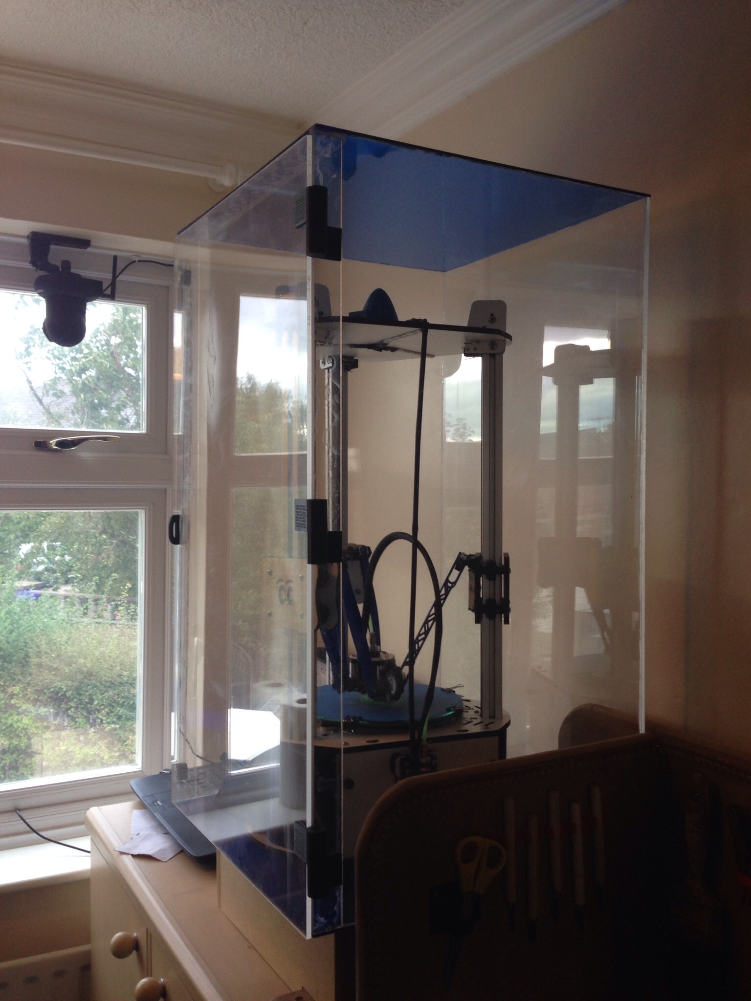

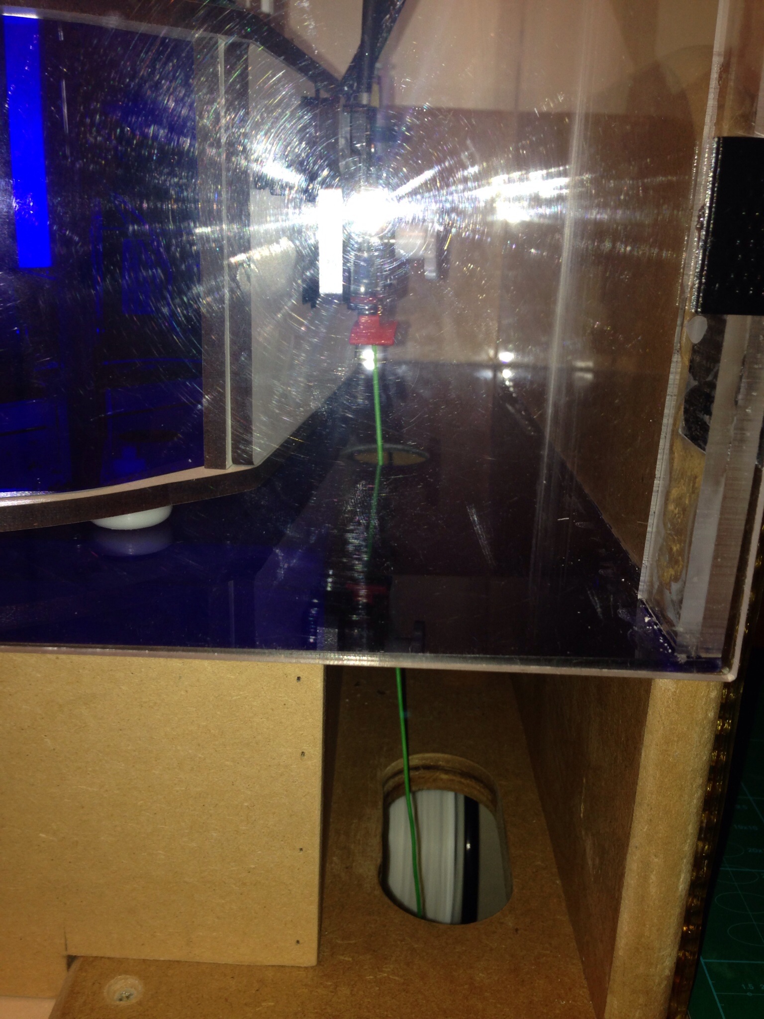

I have recently made an plexiglass box to go round the printer. I made this for a few reasons.
1. Fumes, I print ABS and Nylon 6 which both give off nasty fumes that I'd rather not be breathing in.
2. Noise, it's amazing how much noise insulation a 5mm thick piece of plastic gives.
3. Chamber heating, I've found I get better ABS and nylon prints because the air around the print is warm. On a decent day the chamber can reach around 37°Ish (100°F). The circuitry has cold air being pulled in from the bottom, chill out.

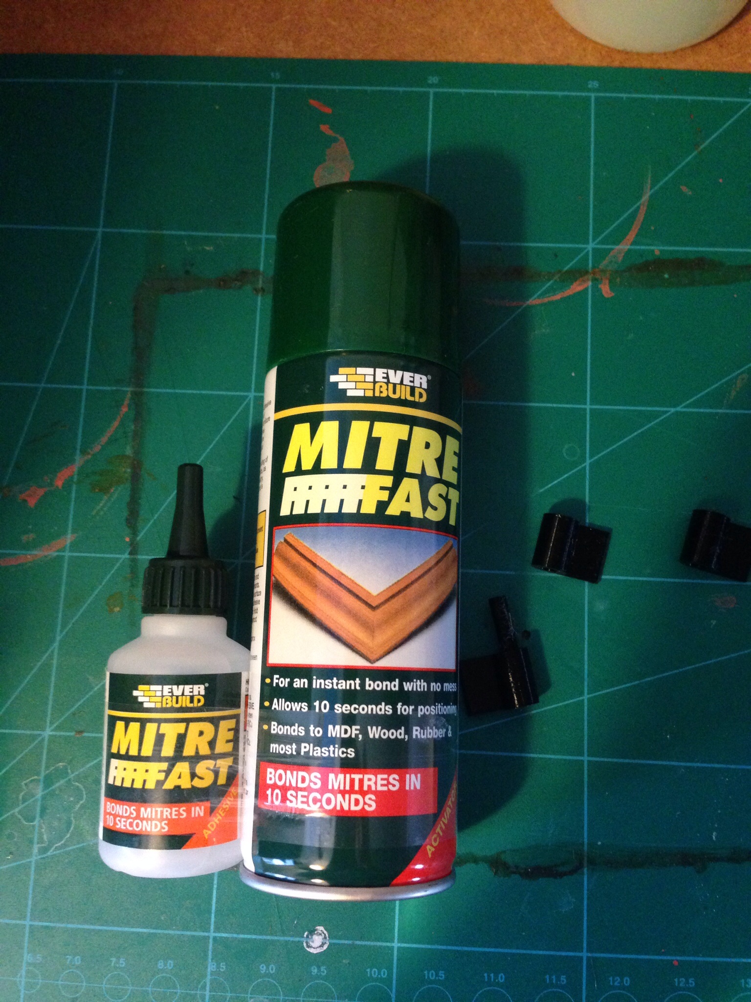

The box is held together with this stuff. It's unbelievably strong and only goes off once sprayed with activator. Not sure if you have an equivalent in the US.

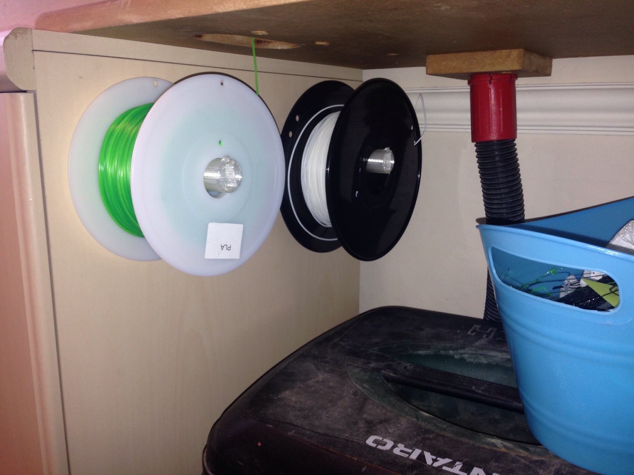

The filament spools from a holder under the "finishing platform" as I like to call it. It then passes through the wood, then acrylic up into the EZStruder. Works really well. I have another spool down there because I can.. Maybe hopes for a dual extrudes mod!

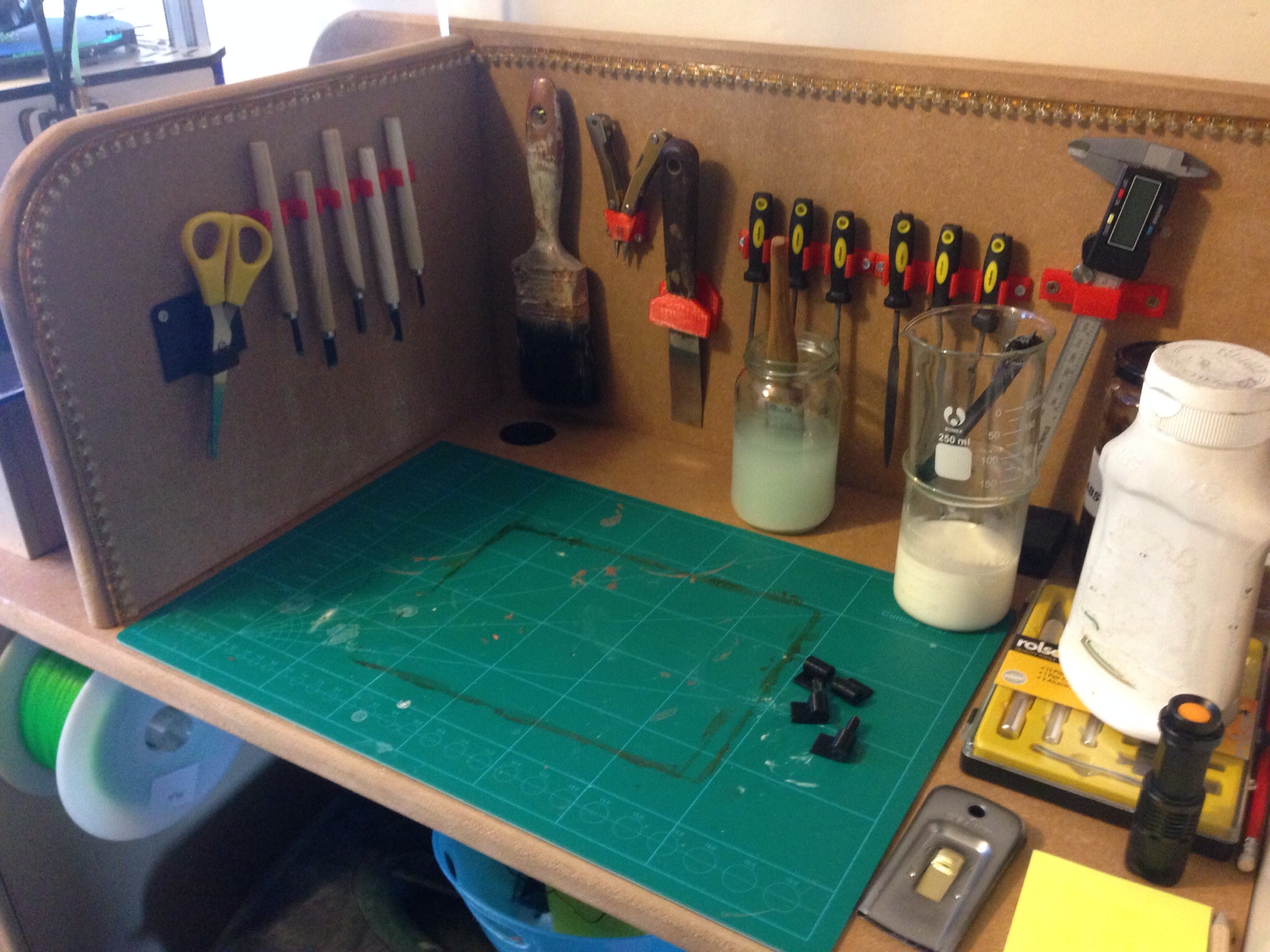

The finishing bench itself is an absolute lifesaver. Having no garage makes finishing prints with a lot of support a messy job but now having a table with a vacuum built in is big plus (hole in the top left).

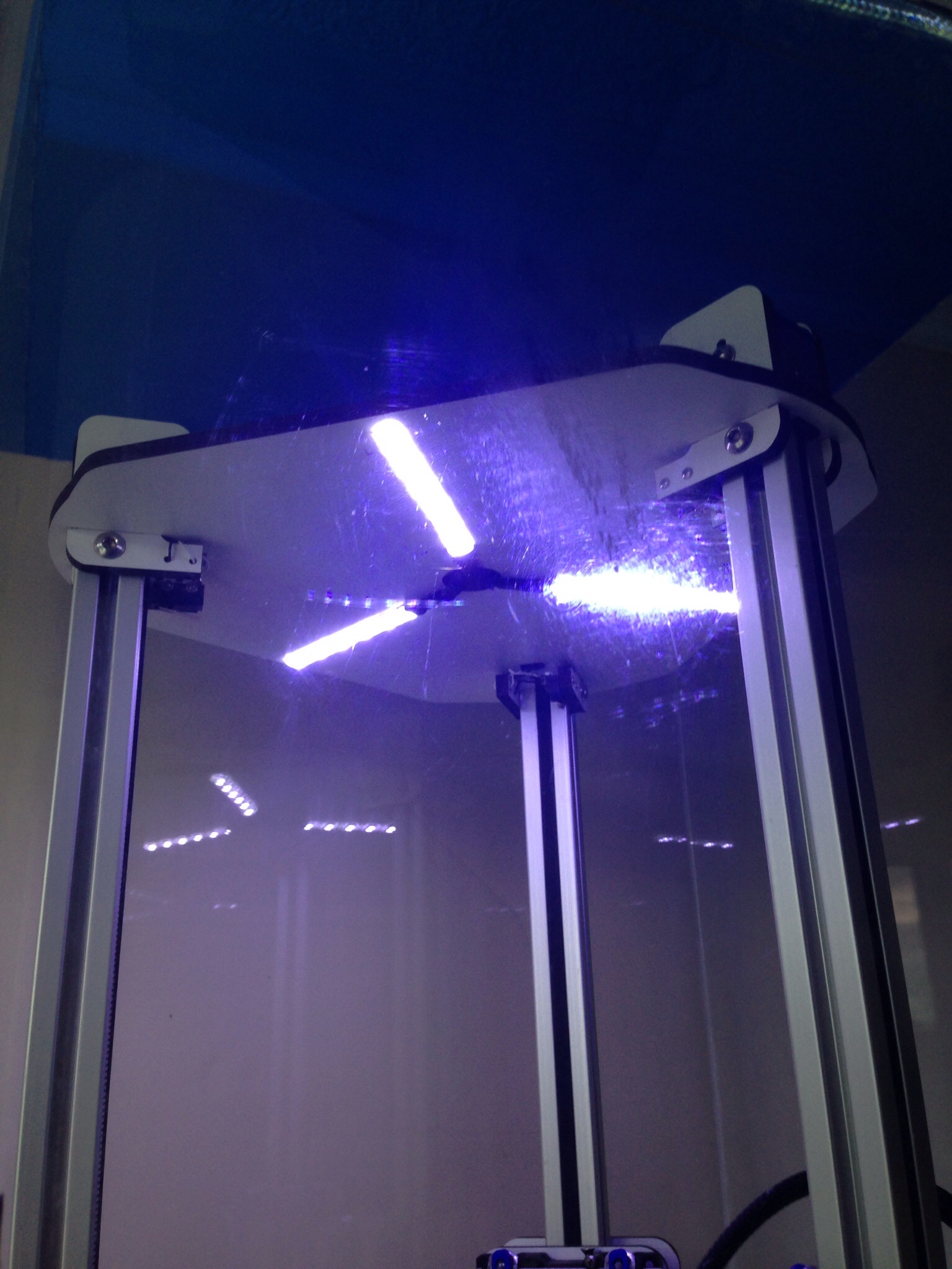

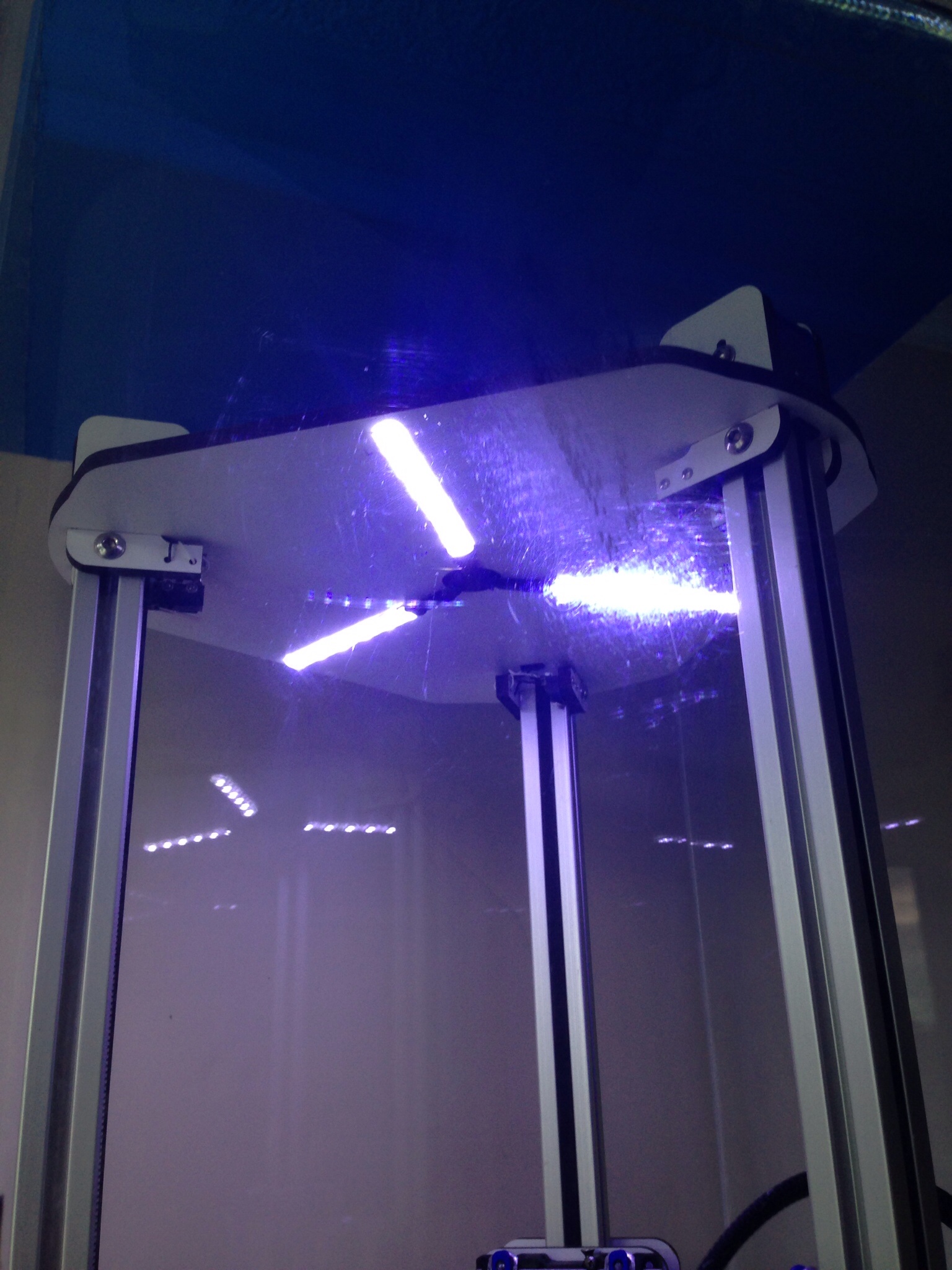

The printer is lit up with some LED strips at the top of the printer and the work bench is lit by one long LED strip. I need good lighting for any time-lapses I'm doing over night which I post to my YouTube channel http://youtu.be/BrpLPVtNaY4
Finally the only real modification to the printer it's self is that I upgraded the heating resistors (which both failed at around the 20 day mark) with one 40W heater cartridge. It works a treat.
Hope you like my setup and would be glad to hear your feedback! :D

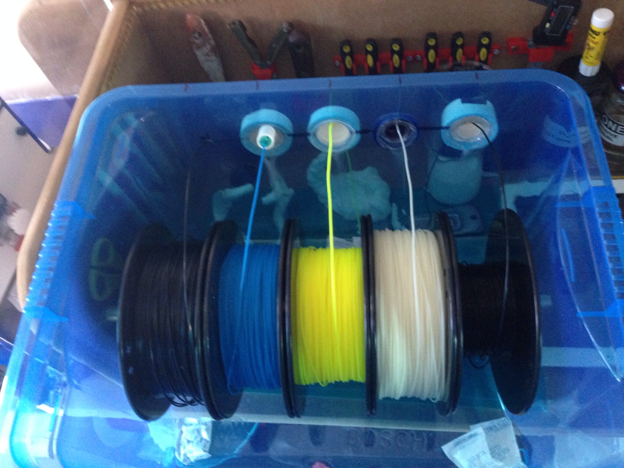

Funny you should mention that!

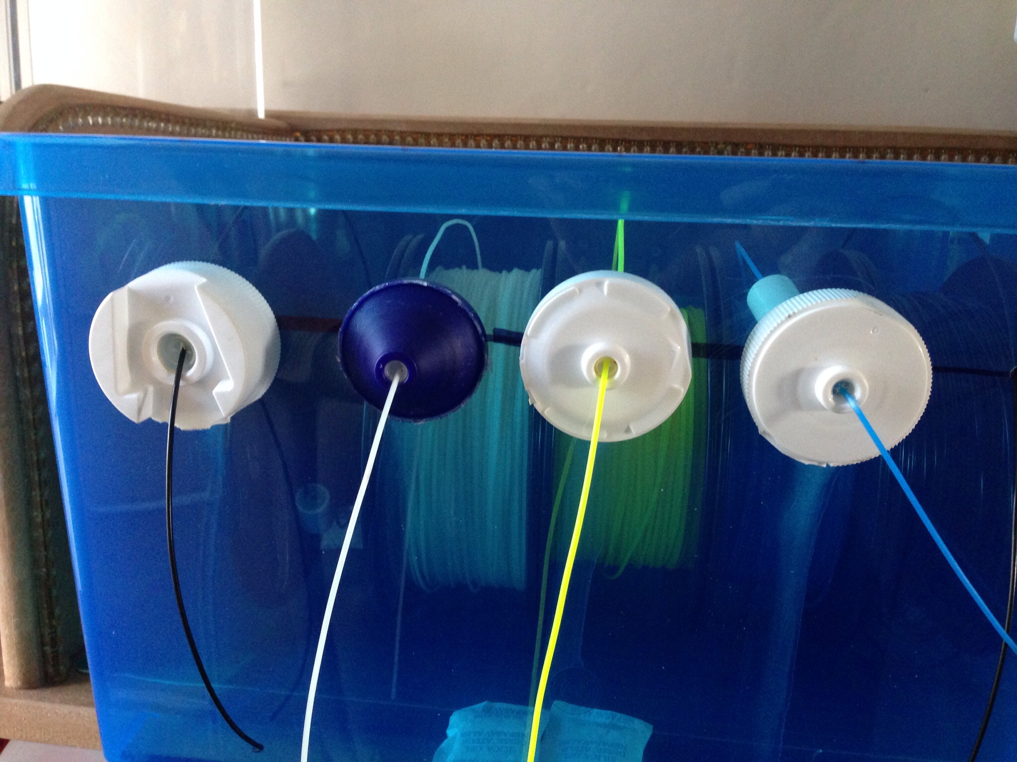

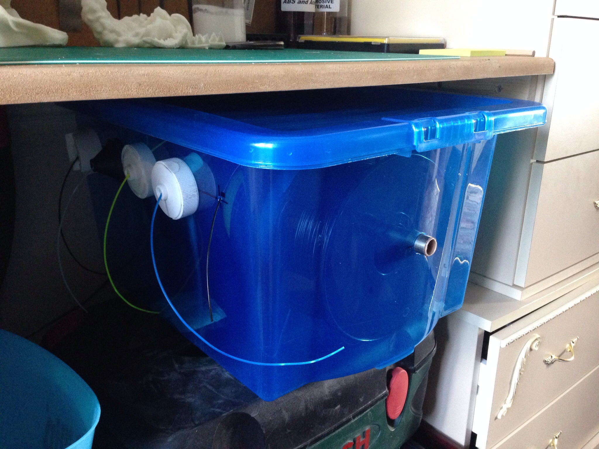

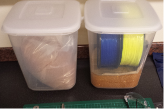

I've just finished making a airtight box for some of my spools that also has airtight valves that let filament spool without it ever leaving the box.
Take a look:

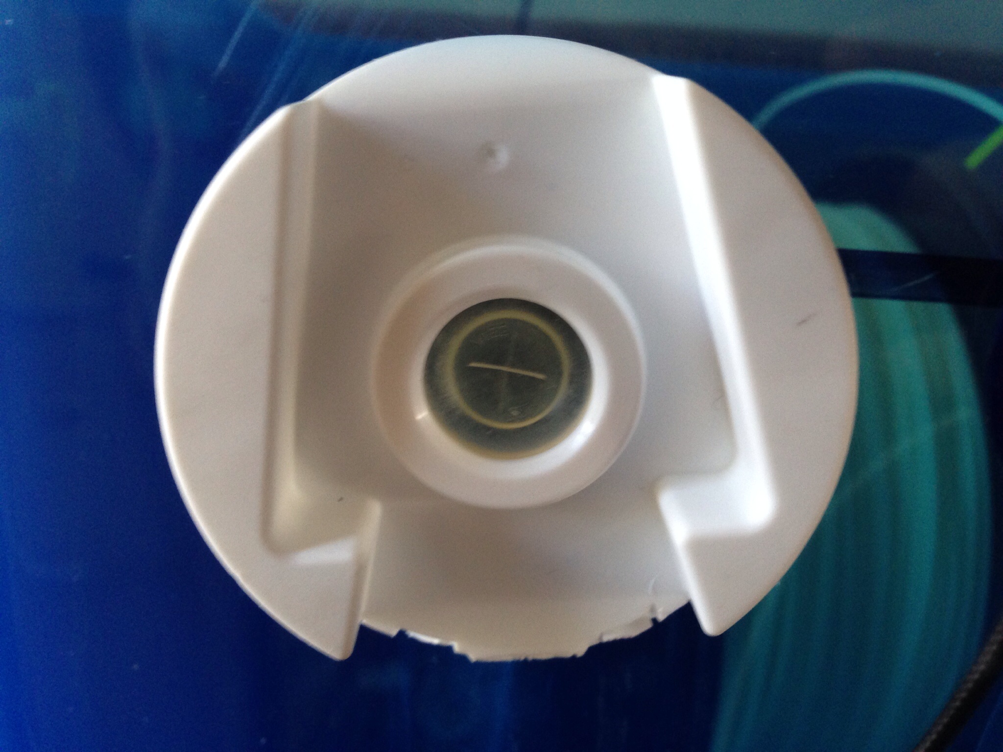

The valves if you haven't already guessed are off bottles of condiments. They have a pretty neat pig valve that lets 1.7 filament through.

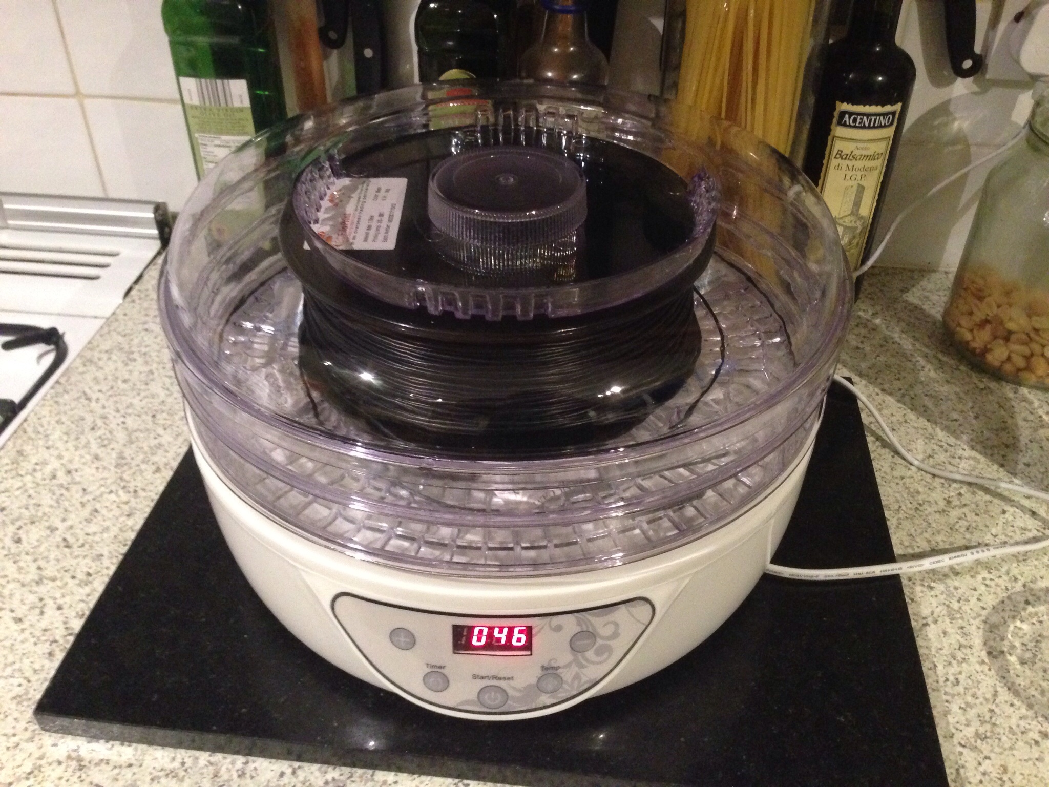

I've had trouble printing some nylon and that was partly due to the moisture in it. I was reading that curing it in the oven for 10 hours works but frankly I don't want to have an oven on for that long due to gas prices and fire hazard. So I went and got a fruit dehydrator (used to dry fruits) and from the feel of the filament it looks like it's worked quite well.
Link to the dryer:
http://www.amazon.co.uk/Electric-Dehydr ... dehydrator

All it is blowing hot air it goes to 70°c but it made nylon softer than I liked it so I ended up drying at 50. So I wouldn't see a reason why it wouldn't work. It's all plastic.

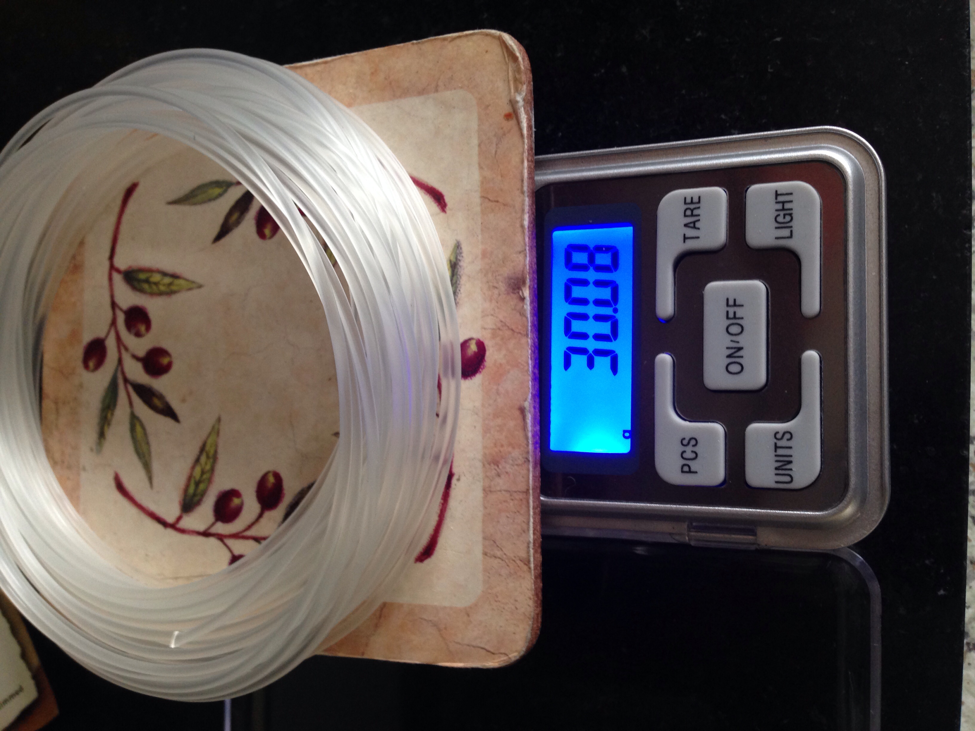

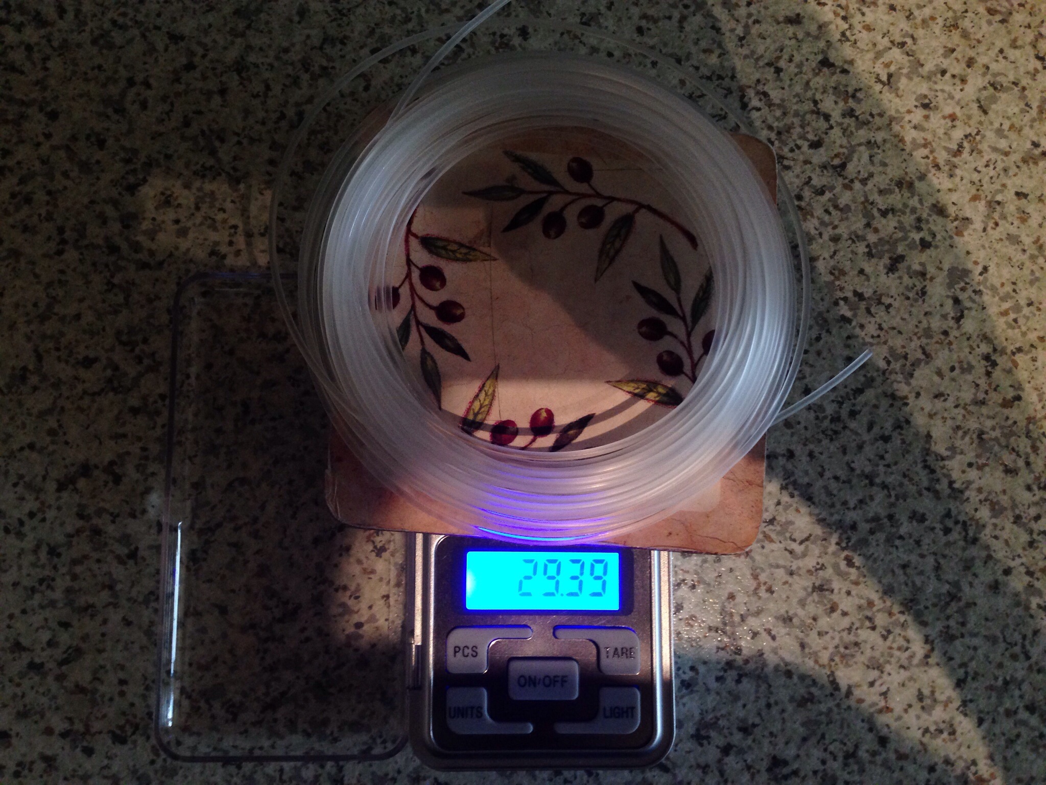

Unfortunately I didn't weigh the spool of nylon before drying. But I did have a 10 meter sample of Taulman Bridge nylon so I thought I'd give that a try. Bridge nylon doesn't absorb anyway near as much moisture as nylon 6 which is what I normally use and it was brand new out of the bag. I dried it for around 5 hours at 65°c.
Before
Before
After
After
So you can see even with Taulman Bridge nylon there's a fair bit of moisture lost and remember that's only 10 meters and it's brand new.

Looks like you have a small bag of desiccant in there but seems small for your container volume especially considering it's not 100% sealed.
I'd recommend filling the base with a few inches of no dust (low friability) indicating silica gel like this
http://www.amazon.com/Quart-Indicating- ... B00BXK8E7M
It's easy to regenerate in the oven, you can see when it's water saturated so when to regenerate and cheap to boot.

you can't really see from the photo but there's loads of Desiccant packets in the bottom (almost covering the bottom now) but I'll defiantly have a look for some of that blue stuff in the UK.
