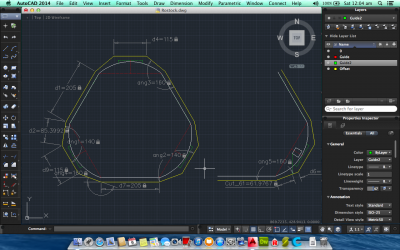

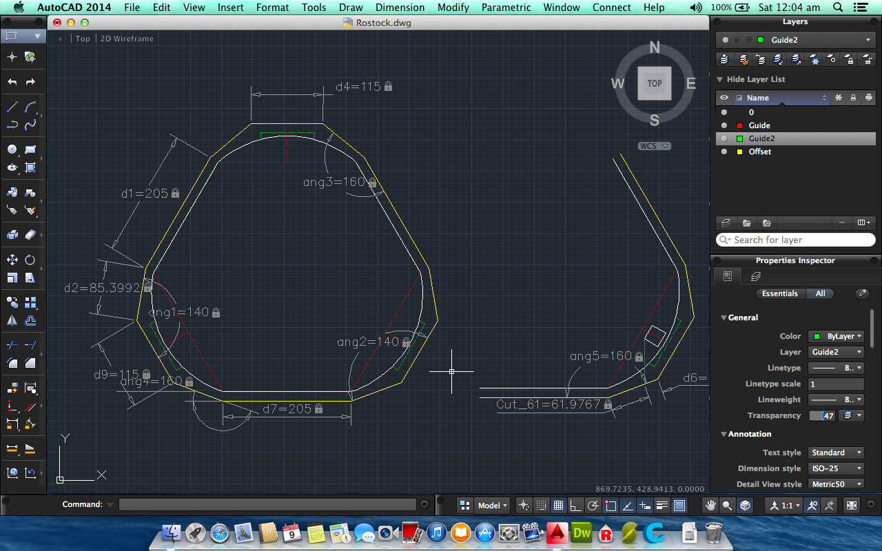

The whole enclosure is self supporting no screws needed. These are the measurements i came up.
Oh and its 752mm tall.
