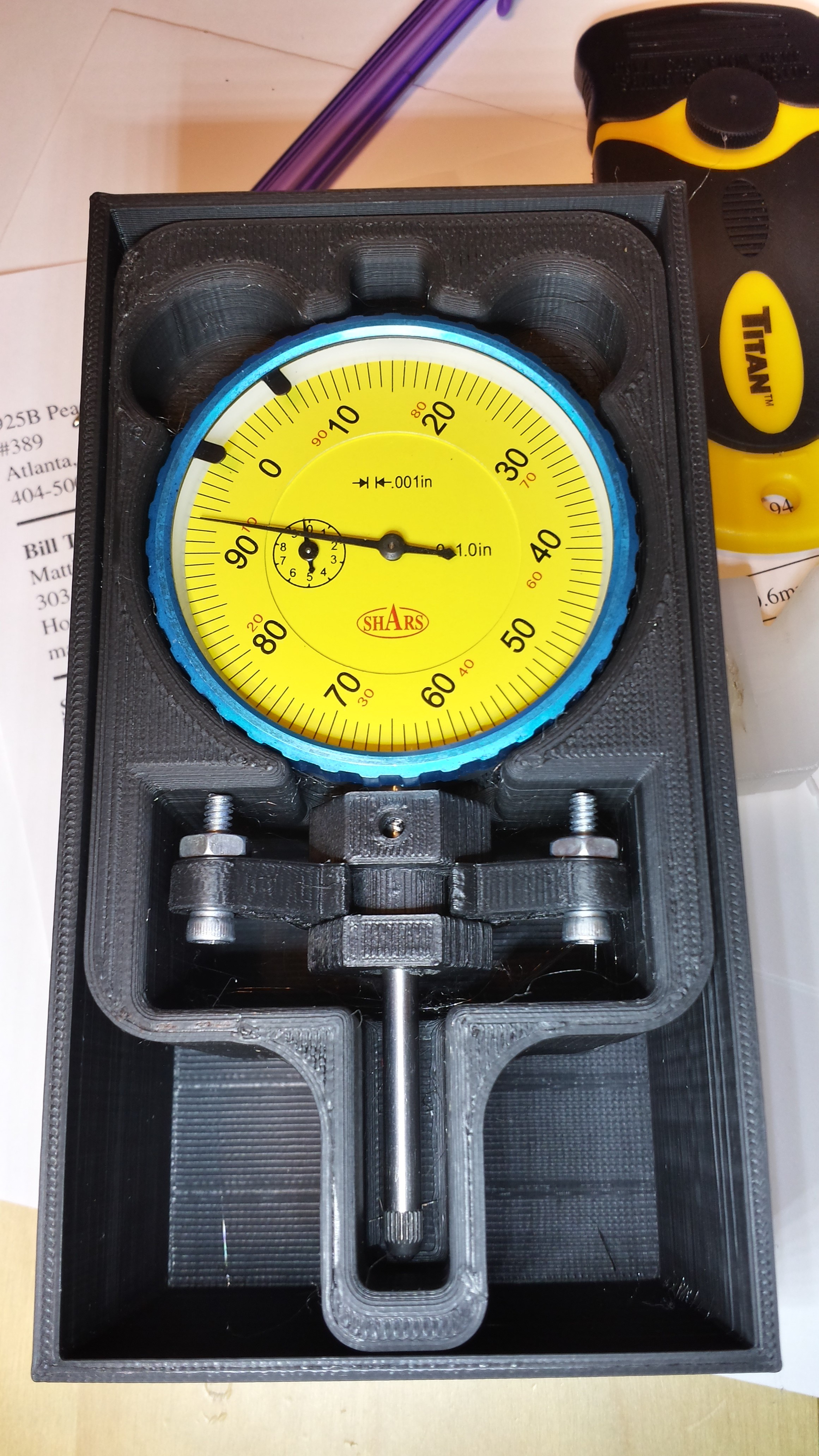

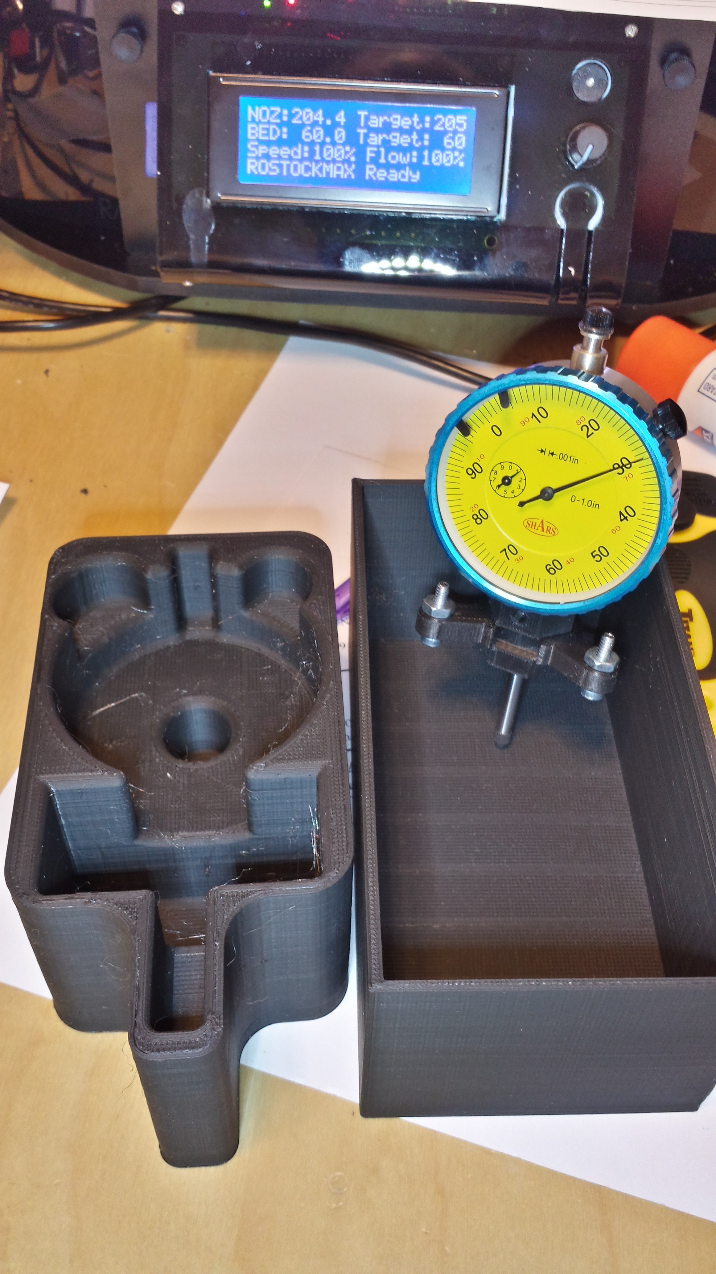

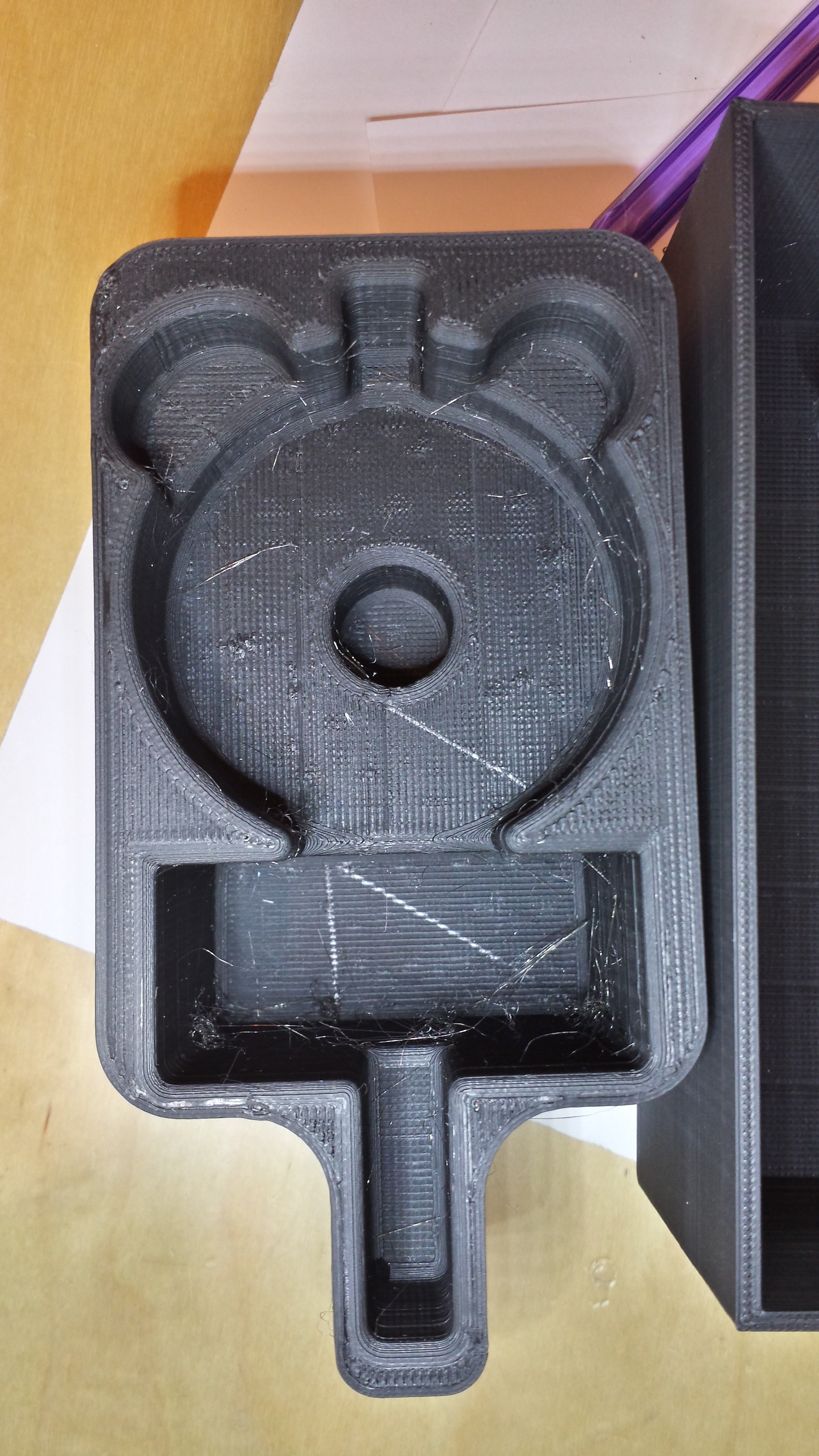

Just sat down and knocked this out in Solidworks last night. I wanted something a bit nicer then the cardboard box for my calibration dial. It might be a super high end model but it sure has my system calibrated and I want to keep that way. I also was just playing around in Solidworks and wanted to see if I could make the box and the insert fit perfectly. It turned out great and these are images with it right off the printer. Just thought I would share.
Matthercontrol and Matterslicer, Toner Plastics PLA at 75mm 210 EXT and 60 BED. Worked great!

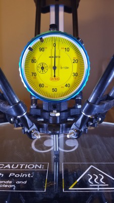

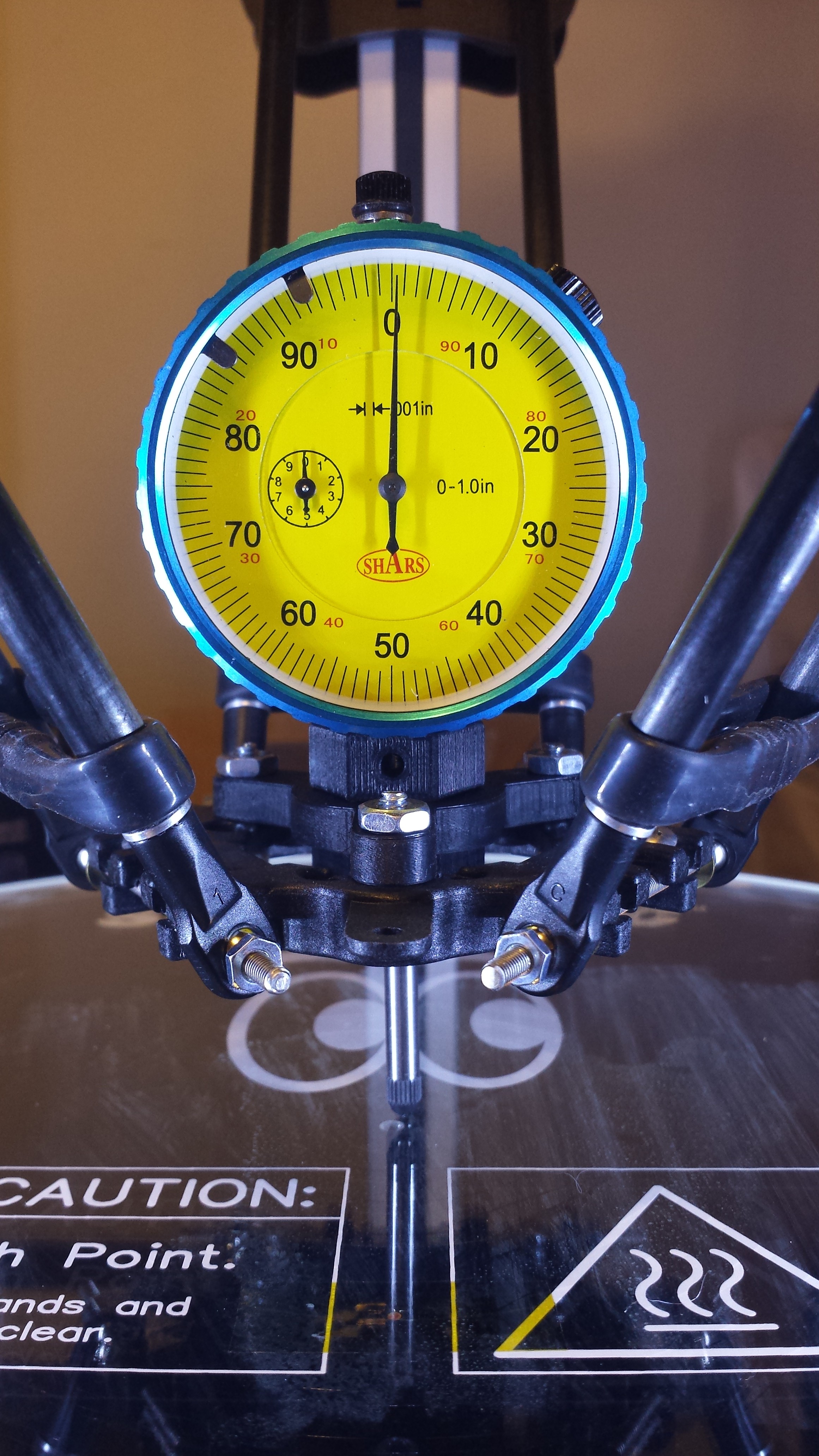

Just got the exact same dial in the mail. I had seen the part it's mounted on and printed it but I broke it while removing support. Can you show what the dial looks like on the machine while "in use"?
Rostock max v2 with e3d v6
travelphotog
Posts: 398
Re: Calibration dial box.
Post by travelphotog »
Here is how it looks in use

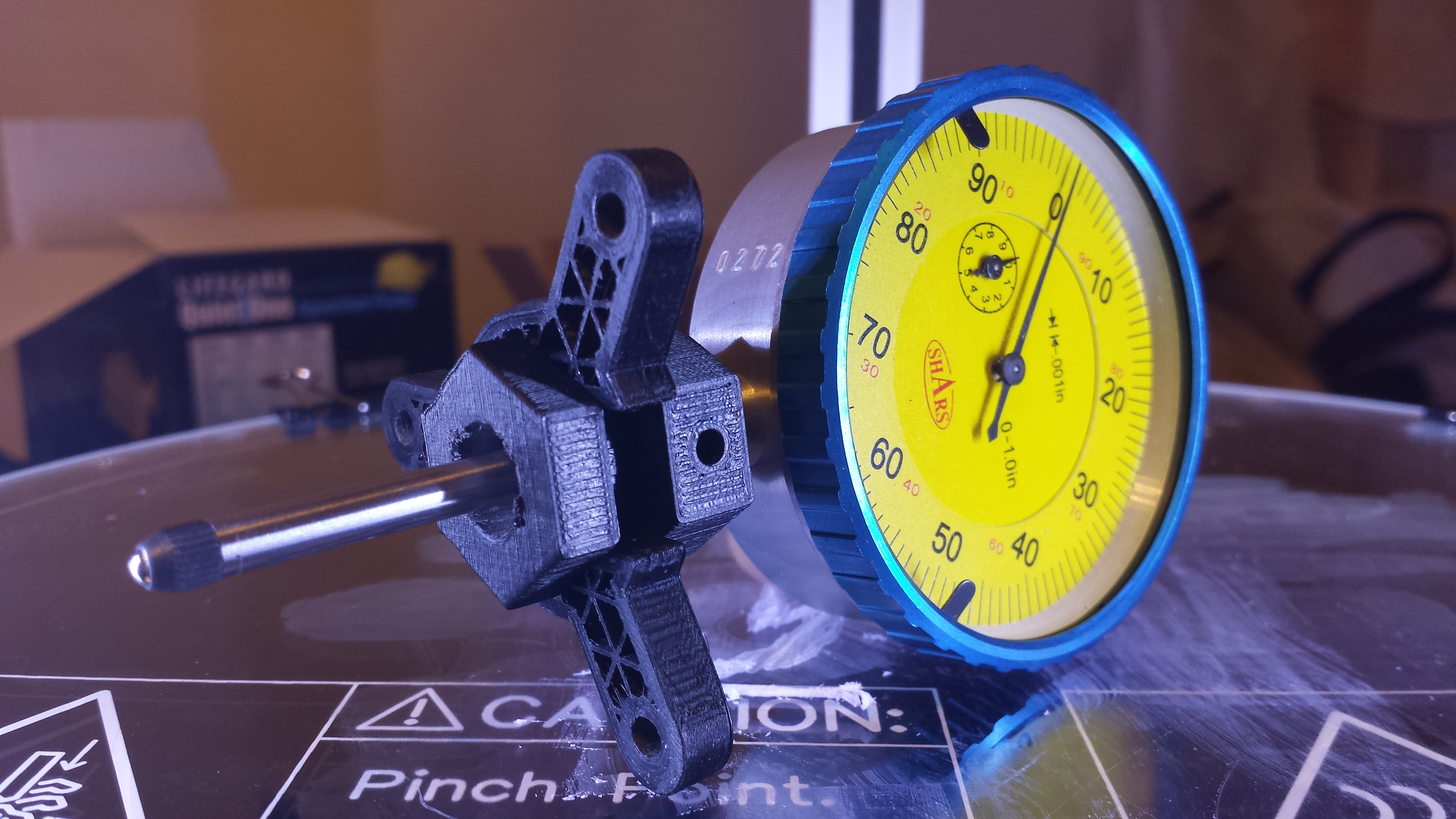

this is a shot of just the two mounts on the Dial. The Dial slides into the small mount which is held on by the Slot mount
dial indicator holder e3d mount R3 flats.STL
This holds the Dial in the slot mount. It is tight and might need a file but should not need the screw, though a hole is there if desired. I printed laying down on one fo the flat sides and it worked fine without supports.
(46.08 KiB) Downloaded 311 times
E3DV6_Mount_01.stl
I used this slot mount with some #6 screws. It is the same mount I use for my E3d V6.
