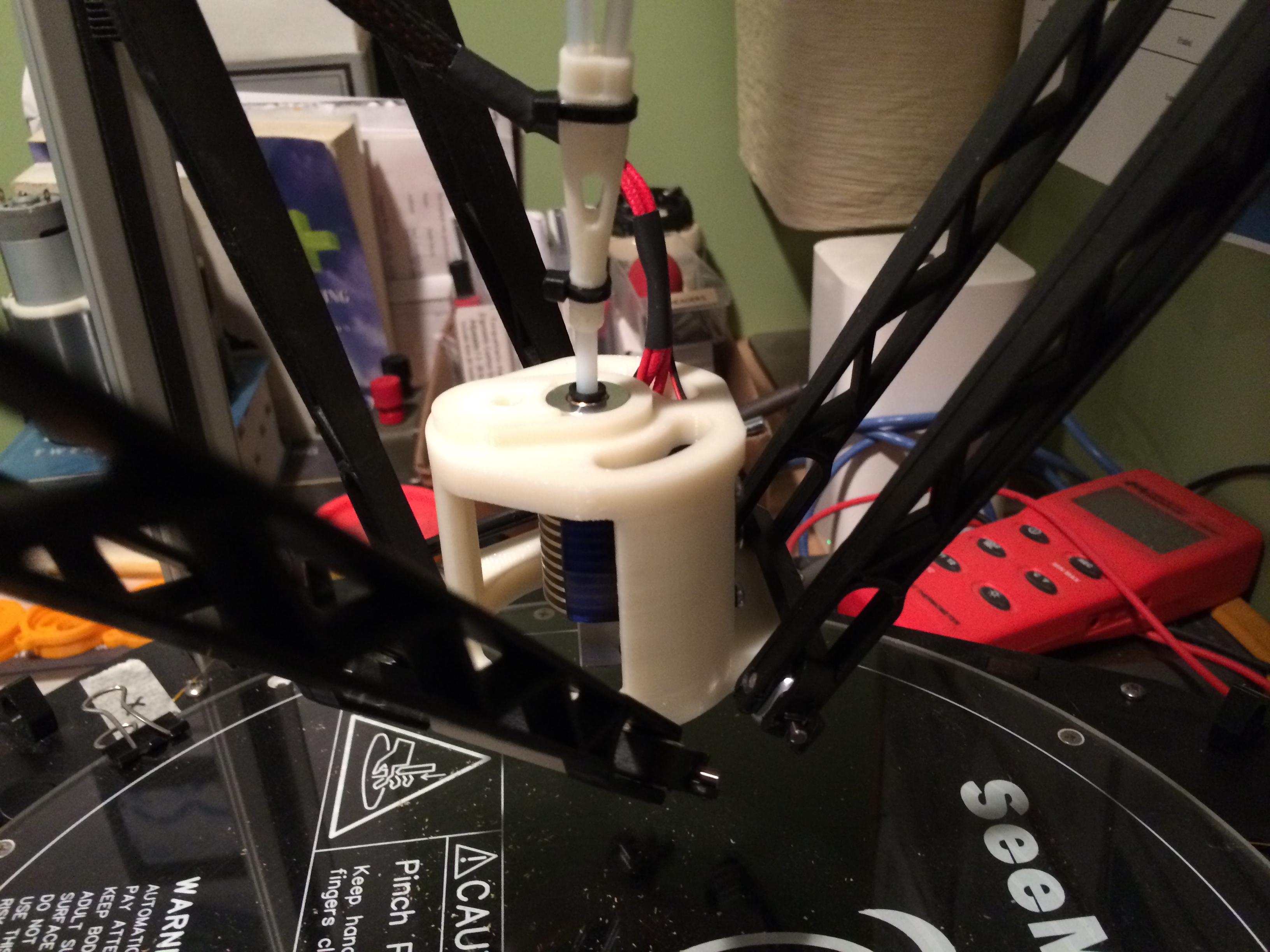

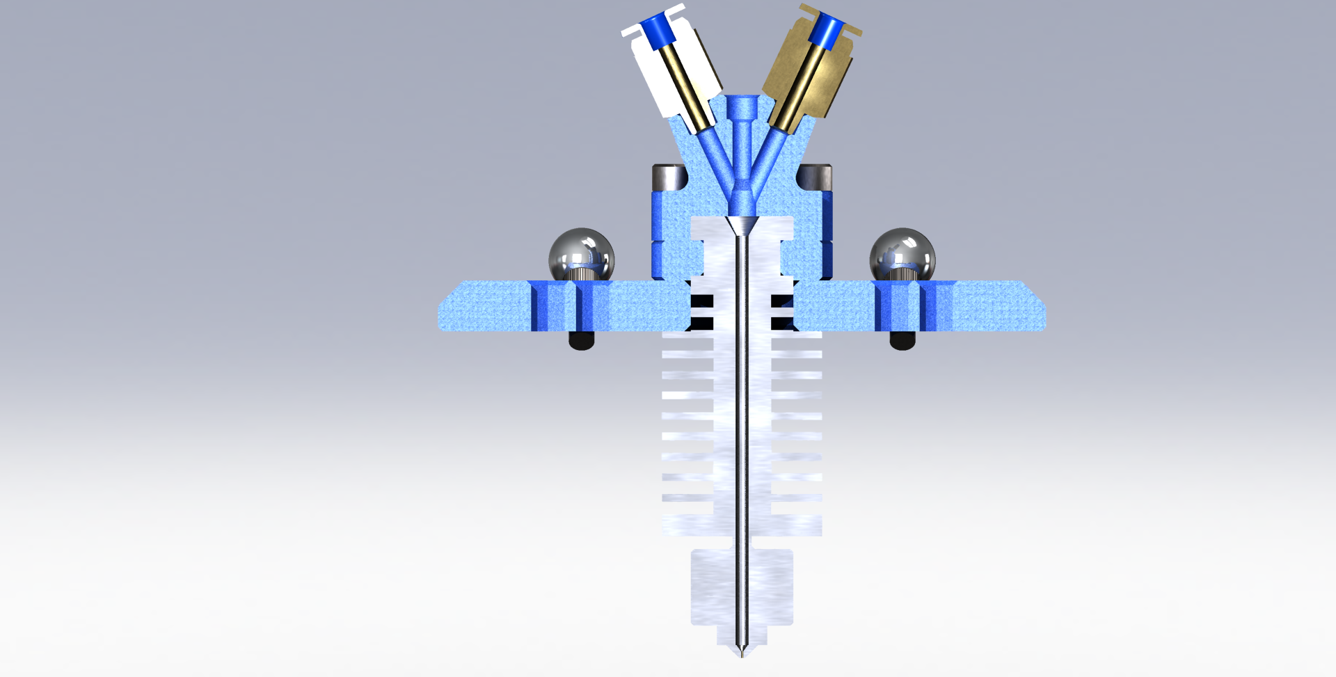

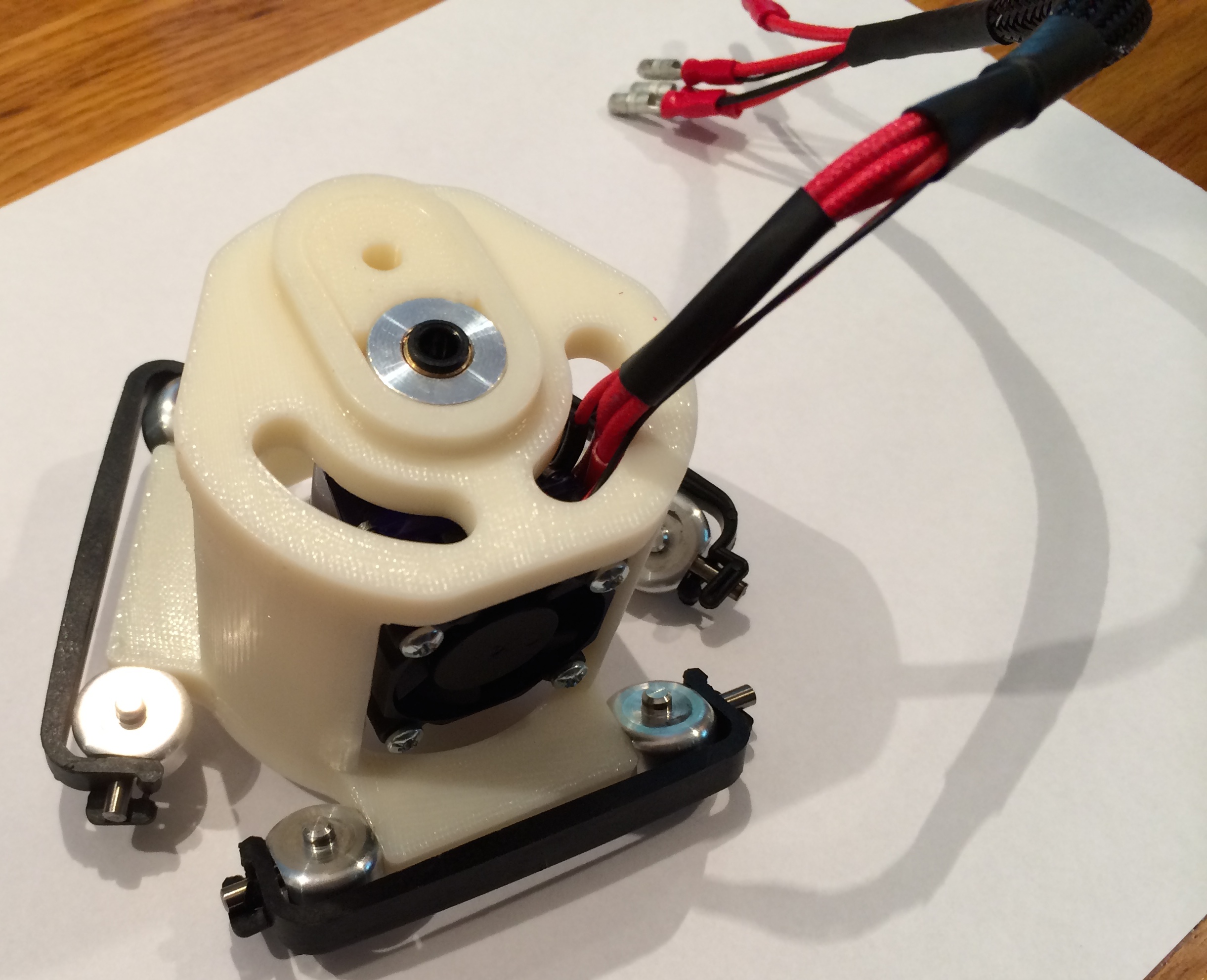

I swapped over to a E3Dv6 hot end a few days ago. I designed this platform to make my life a little easier. I'll share the github repo for it - be warned, though: The documentation is still a little rough, mostly pictures. It's working out well for now. It's printed from ABS. I'll cut one from aluminum once this proves out. Maybe.
https://github.com/justinmeyer77/Tricorne

Looks excellent! Definitely printing that one!

Wow that's cool! I like it a lot!
I might just print that thing

Let me know how it goes, if you don't mind. I printed it on a uPrint - so I had the benefit of support. I'd love to see pictures when you get it printed and running.

If you're interested, I can post the mods for the dual extruder through one hot end as well. It's just a couple of tiny printed widgets and you're up and running. Right now it's printing ABS and HIPS.

I am interested in your widgets. I assume that you retract the active filament past the biflurcation point and then advance the second filament into the hot end. Also looks like this is fitted to a E3D Hot End.
Does it work okay with PLA (can't imagine why it wouldn't)?

Yep! Absolutely correct. On all counts. It is an E3D.nitewatchman wrote:Justin,
Do you do a filament dump to purge the first filament out before printing witht he second filament?
thanks,
nitewatchman

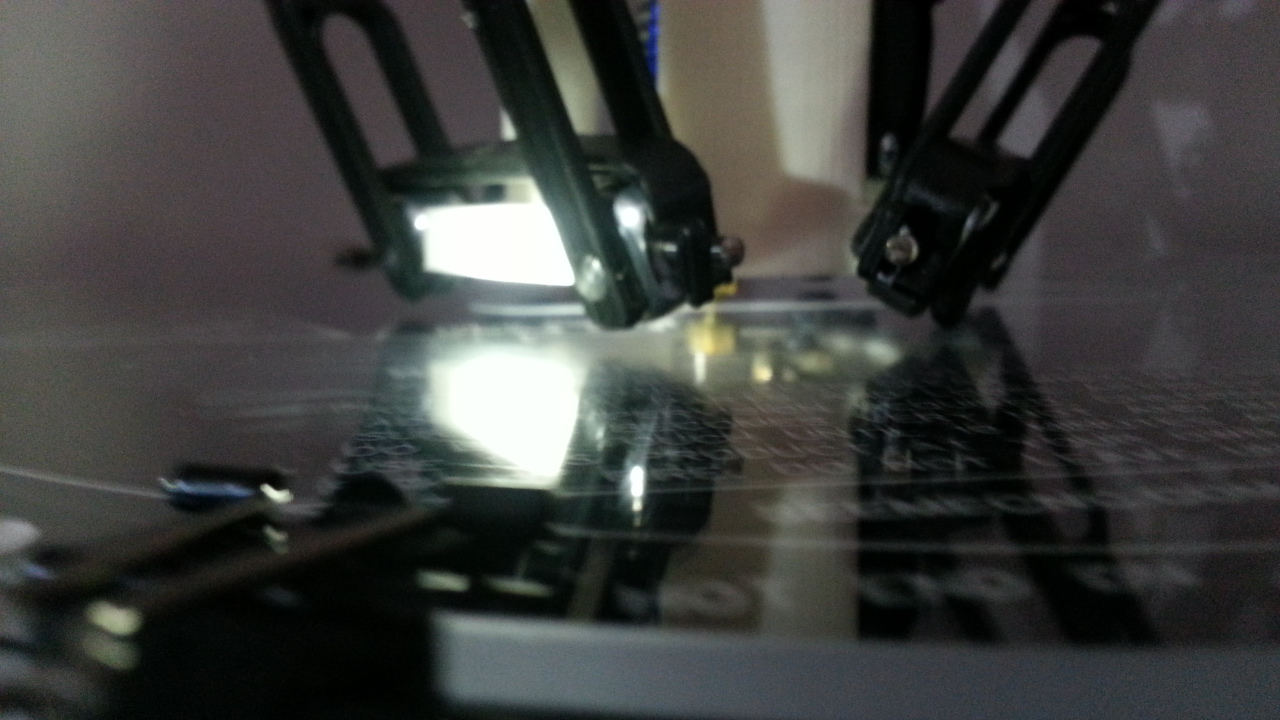

I don't use PLA. I'm not sure how it'd work with it. I can order a spool next time I buy filament and let you know.
I have a wire brush mounted that I use as a wipe (every layer and on extruder change). It really seems to help if I do it with every layer - regardless of if I've changed the filament or not. I noticed my uPrint wipes on every layer - so I figured I'd give it a try.
Don't forget to change your pins.h and configuration.h files! Make sure to point your second extruder to the same pins as the first for heat and thermistor.

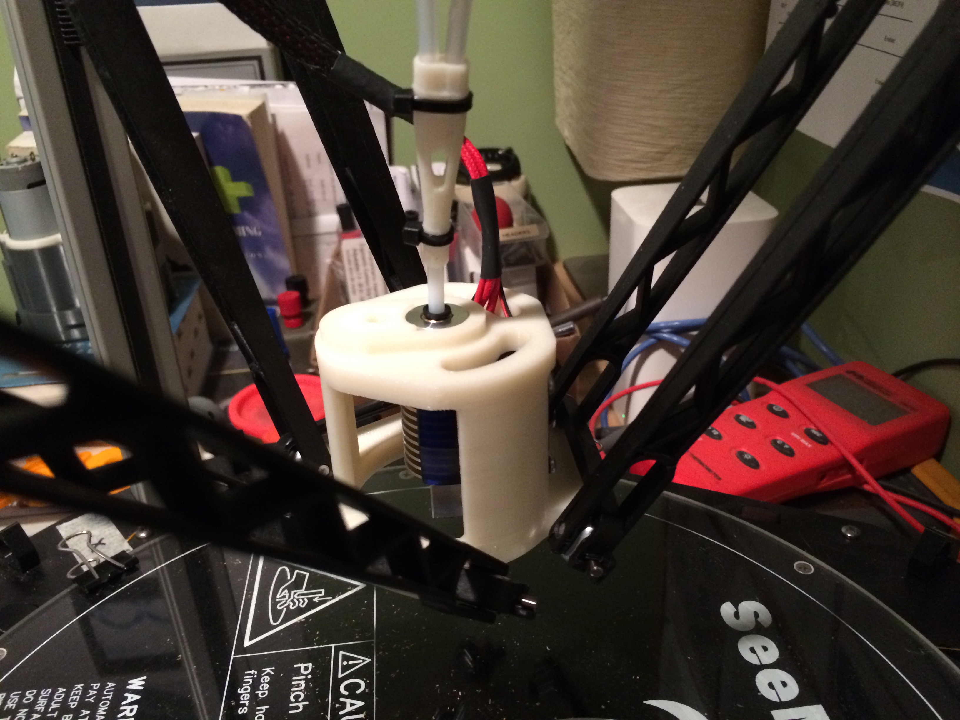

Re: Monolithic Platform for E3Dv6 Hot End
...forgot to add the filament guide...
Just print two and join with small zip ties.
Don't judge me on the geometry. I'm tinkering with Fusion 360 (...instead of Inventor...).

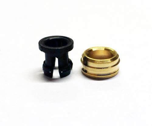

I'm not following you?! What do you mean?Jimustanguitar wrote:You ought to draw up a piece for the EZStruder to replace the aluminum bit that the bowden tube mounts to so that you can use the extra E3D insert as the clamp for the Extruder end.
Make a printable plastic piece that accepts the E3D style bowden insert (my kit came with an extra one that I'm itching to use). Get rid of the aluminum piece of the EZStruder that only has threads for the sloppy OEM pneumatic fitting...
- Justin@Saturday
- Plasticator
- Posts: 16
- Joined: Sat Aug 09, 2014 9:16 pm
- Location: Pittsburgh, PA
Do you mean this widget?Jimustanguitar wrote:Make a printable plastic piece that accepts the E3D style bowden insert (my kit came with an extra one that I'm itching to use). Get rid of the aluminum piece of the EZStruder that only has threads for the sloppy OEM pneumatic fitting...
I'd like to CAD up the geometry for this and be able to print them for projects. It's a really great idea. Kudos to E3D for this. (I've never seen embedded push fits in industry - I think it's truly their idea)
- E3D_Kraken09thumb-500x500.jpg (10.22 KiB) Viewed 30248 times

Yup, that one. I'd love to have that fitting on my EZStruder.Justin@Saturday wrote:Do you mean this widget?

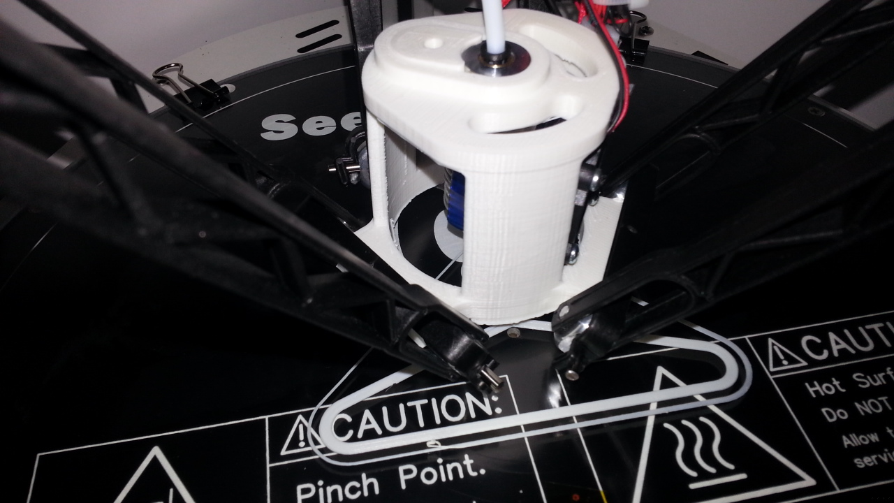

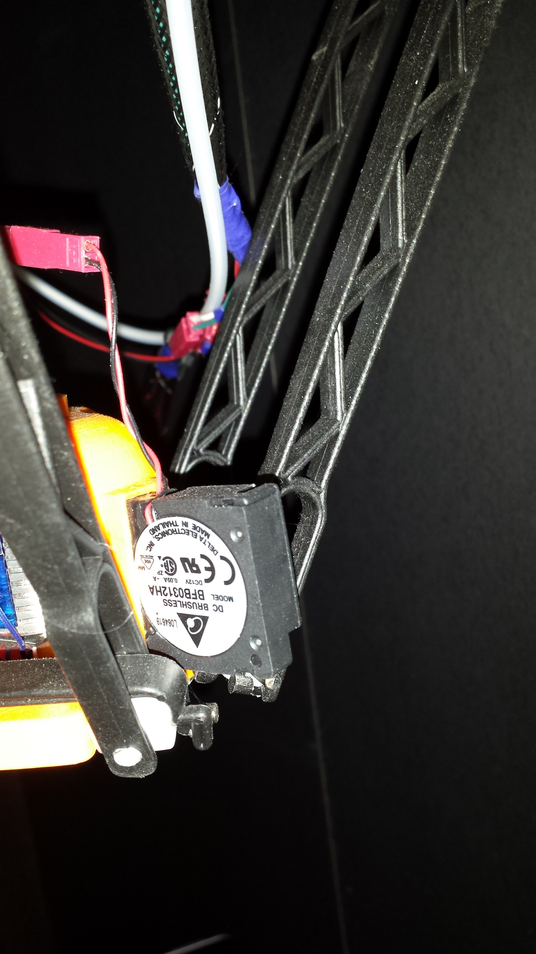

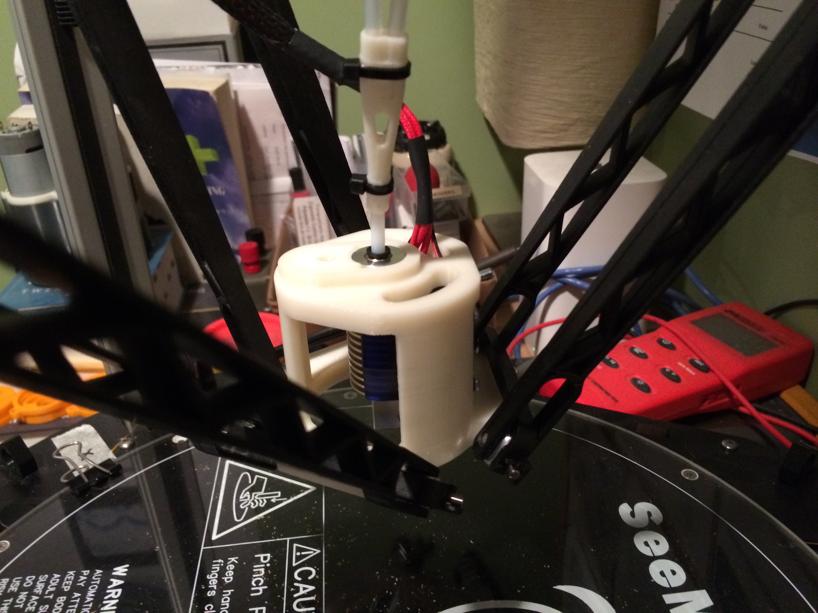

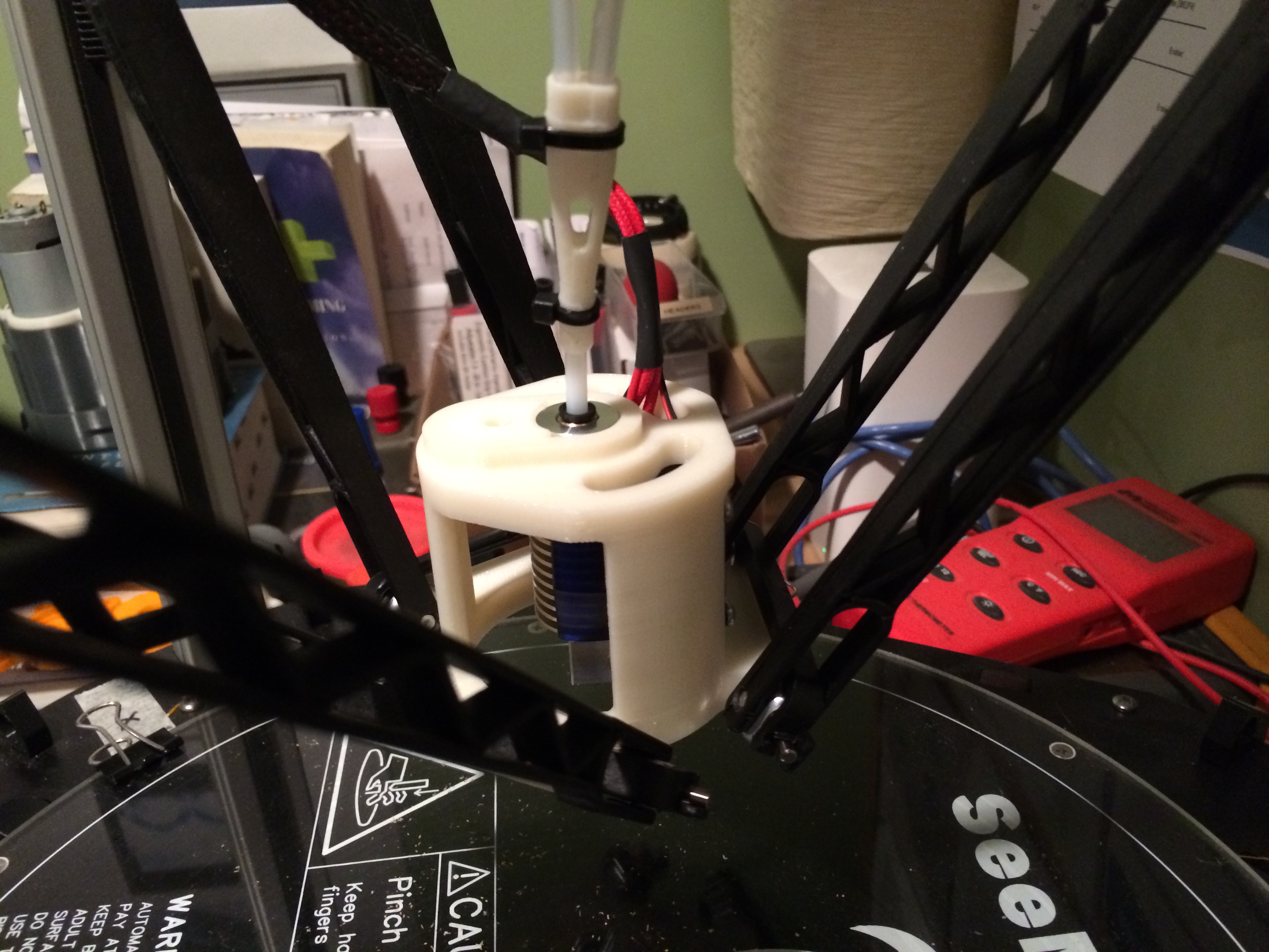

Well, this caught my attention so I made one, actually two. Switched back to abs since I have to come up with a layer fan idea because this drops puts the platform so close to the deck (extra 11mm build height). It is clean looking. Holes for the shaft are a wee bit big, had to put some copper shimming on the axles.
Just printed off my standard dolls coat hanger calibration test.
This is a nice housing, its reduced some of my vibration issues.
Got to go shopping, back tonight (wife's B-day)

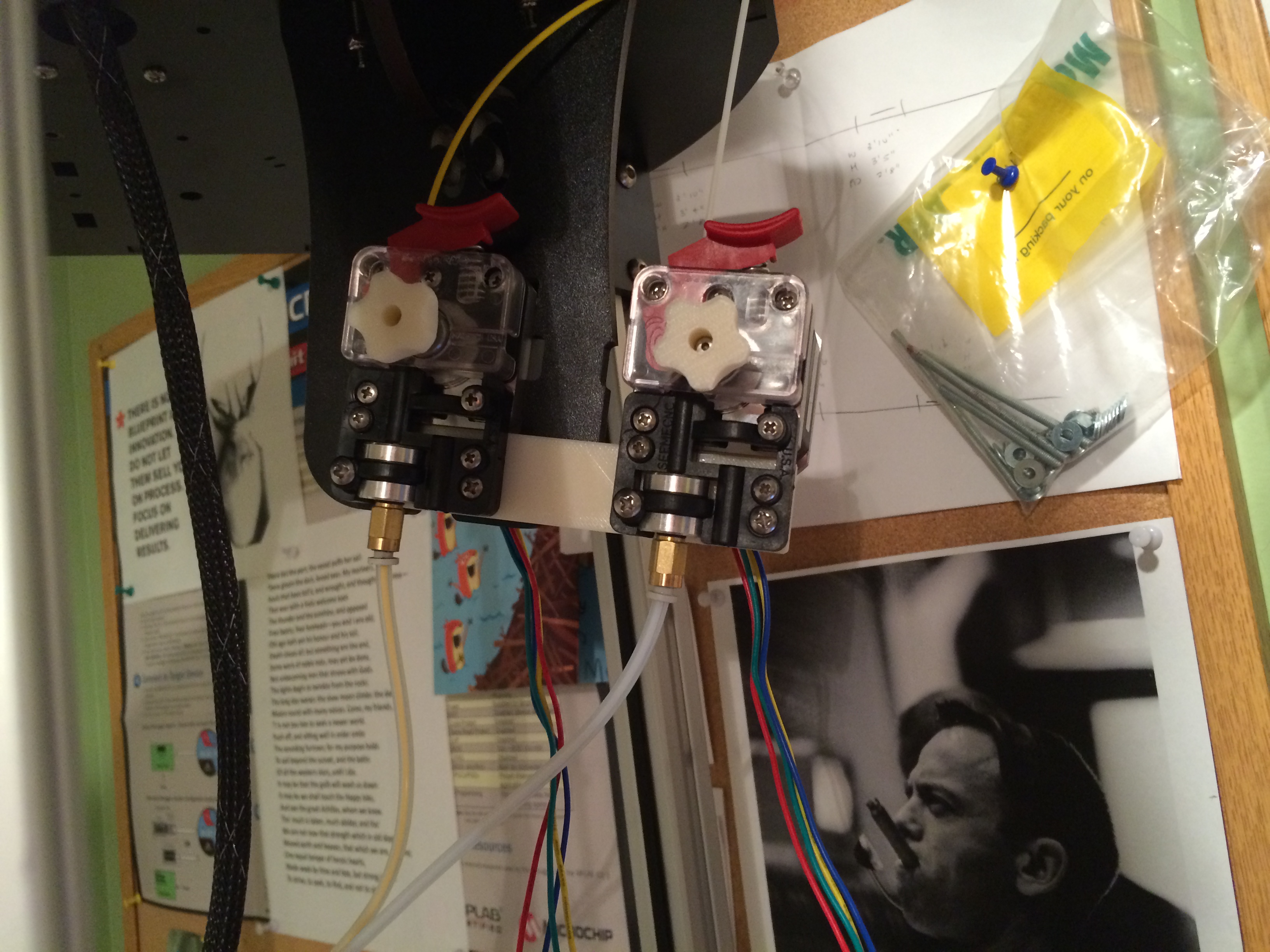

Mine looked like this; The rest is in the "Tilting dual extruder" thread in this subforum. Yours is so much nicer looking.
