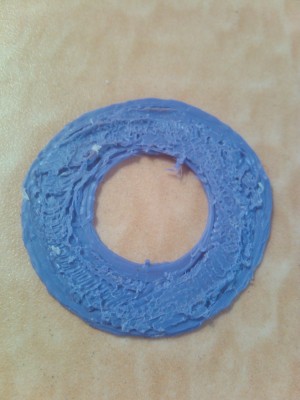

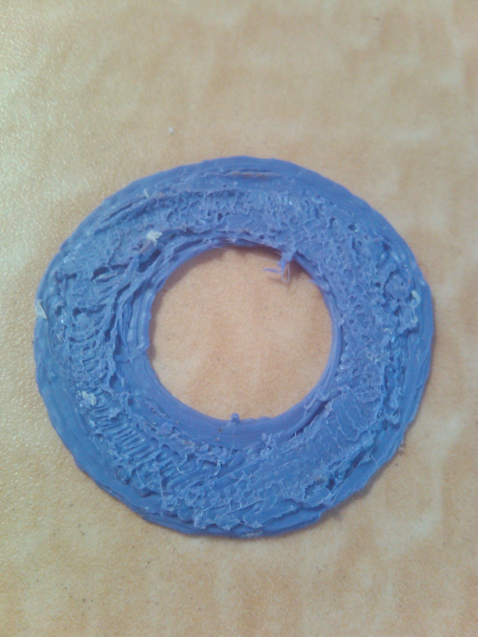

Does anyone know why this keeps happening?
Do I need new belts?
I have only had a few decent prints since I got this printer.
It a rostock max.

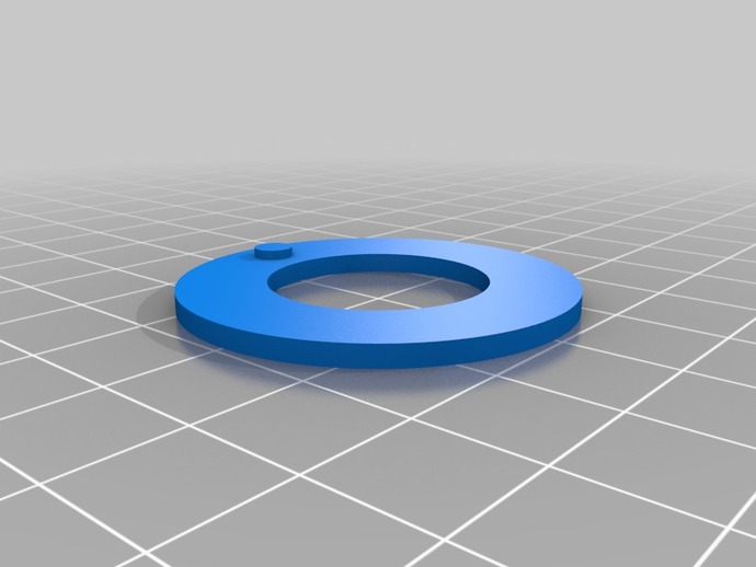

I attached a picture of a failed part as well as the model I tried to print.
Failed part. Why so bad?

Desired part.
Desired part.

Looks like some pretty severe over-extrusion. Have you calibrated your e-steps?
http://reprap.org/wiki/Triffid_Hunter%2 ... tion_Guide
Go down to the E-steps / measure section. Follow just the Measure steps for now, you can fine tune afterwards. In addition to these steps, I would measure/extrude another 100mm length just to confirm the settings are correct.
Let us know how that goes.

If you look at the print you can see its layers are off set to one side.
Need to.identify the direction and offending tower first. Could be a belt slipping or loose set screw on the timing pulley. Check there first...

I agree with the over extrusion, but could you also provide more information? What material are you using? What temperature are you printing at? Layer height, etc. You've obviously got problems and it looks like too much filament at too high a temperature.
Re: Why do all my prints look like this??
Zakk, lets start with basics...
Please post your slicing configuration - or better yet - post the gcode that you created to make this print.
What material was this printed? (the temps we need will be in the slicer or geocode file you prove so no need to ask for those)
Also post your Configuration.h file from Repetier - and, where did you get the original repetier firmware source?
It looks like you have several issues but we should attack those one at a time. What I see is significant over extrusion and/or too high temperatures to produce that "pile" like effect. That will obfuscate other issues so lets address that one first.
The other issue I see is an apparent shift from layer to layer. Rarely is a new belt required to fix this, it is likely a loose pulley on a motor shaft or a loose belt. But lets hold off on that until we get nice looking layers.
cheers,
Michael

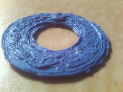

Thank you for the advise. I adjusted my nozzle diameter and printed the model again. It looks about the same.

My first thought is that there is something wrong with your calibration. If height is wrong, it may be dragging the head through the part which would cause all sorts of issues. That's the only thing I can really think of unless you have some seriously massive overextrusion going on.
