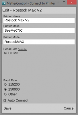

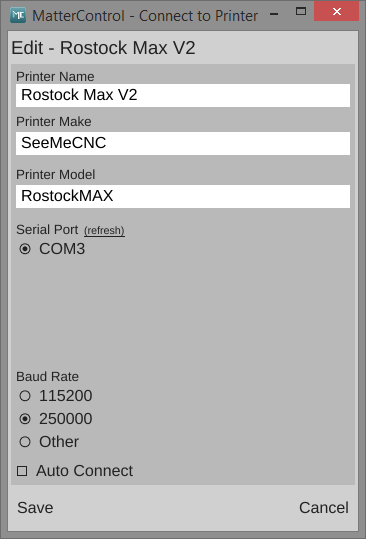

Is there a way, besides remembering to disconnect the usb cord, to shut off Mattercontrol's unnecessary need to automatically connect to the printer? When printing off the sd card, it interrupts the printer.
KAS
Posts: 1157
Re: MatterControl issues...
Post by KAS »
Mac The Knife wrote:Is there a way, besides remembering to disconnect the usb cord, to shut off Mattercontrol's unnecessary need to automatically connect to the printer? When printing off the sd card, it interrupts the printer.
It's a crap fix, but you can disable the auto connect in the printer setup. I say crap because now you have to select the printer every time you "want" to connect. But it's still better than it auto killing something currently printing. ( which I've done several times...)
