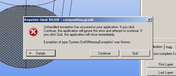

Well...update...got the print Slic3d...took over 20 hours...Log says "...Filament required..465946mm "
Error code then appears..."out of system memory"
What can I do now to salvage 20 hours of Slicing? I saved the Composition.gcode file to a folder. I saved the Composition.obj and Slic3r config files as well.
If I save the program to an SD card, will it run on the Rostock max alone?
Can I attempt to load the file into Matter Control or another Print program?
I have an AMD 3.6 GHz Quad Core with 24 GB Ram, but running Windows 7 Professional 32 bit (due to version compatibility with my AutoCad 2000 and only 3 (+-) GB ram usable.
Should I bite the bullet and just reinstall Windows 7 Professional 64 Bit to take advantage of the full memory available? Will that help with this issue?
ALSO....HOW MANY SPOOLS OF FILAMENT WILL I NEED TO COVER 2 TIMES 465946mm? is there like 1000mm/spool? (1.75mm dia filament)

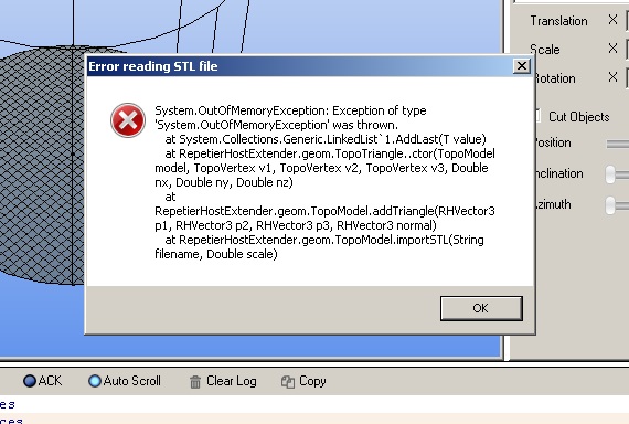

When loading the orginal STL refered to in last post
This Popup appears when loading the original STL file Above:

Posts: 1407
Re: Repetier-Host Slic3r hangs when Slicing??
Post by Mac The Knife »
I assume this is your impellor,,,,, What setttings are you using for perimeters? What type of infill are you using? What is your infill density set at?
1ggy
Posts: 44
Joined: Fri Jun 20, 2014 11:32 am
Post by 1ggy »
Yes, absolutely upgrade to 64 bit. What's the point in having 24gigs of RAM if you can only use 3? :?: Also, as per previous advice, try a different slicer. I've been using Cura for most of my slicing lately and it is MUCH faster than slic3r. I'd also recommend the stand alone version, the version in repetier host doesn't seem to have all the options and what not.

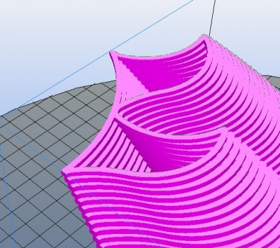

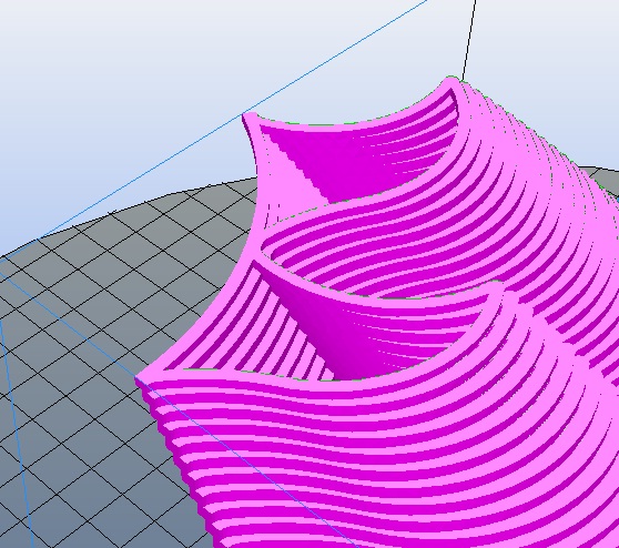

Got a question on INFILL...I do not need any infill in the part I am doing now...what do I set to eliminate infill?
As you can see in the part the "blades" are hollow and I do not want to infill them. My first attempt filled them in and this part was going to take 26 hours.
No infill inside the hollow blades
Momma told me "You need to work on your Printing"
Posts: 1407
With slic3r, I would try setting the infill percentage to 0. I haven't tried Cura.
