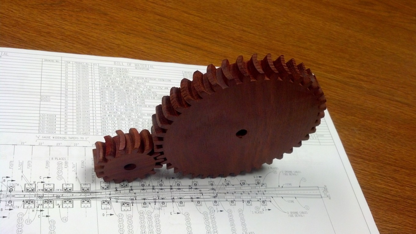

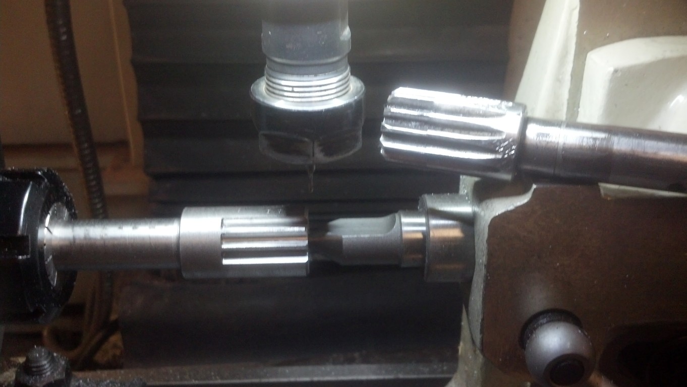

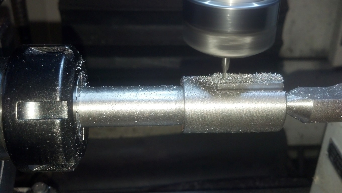

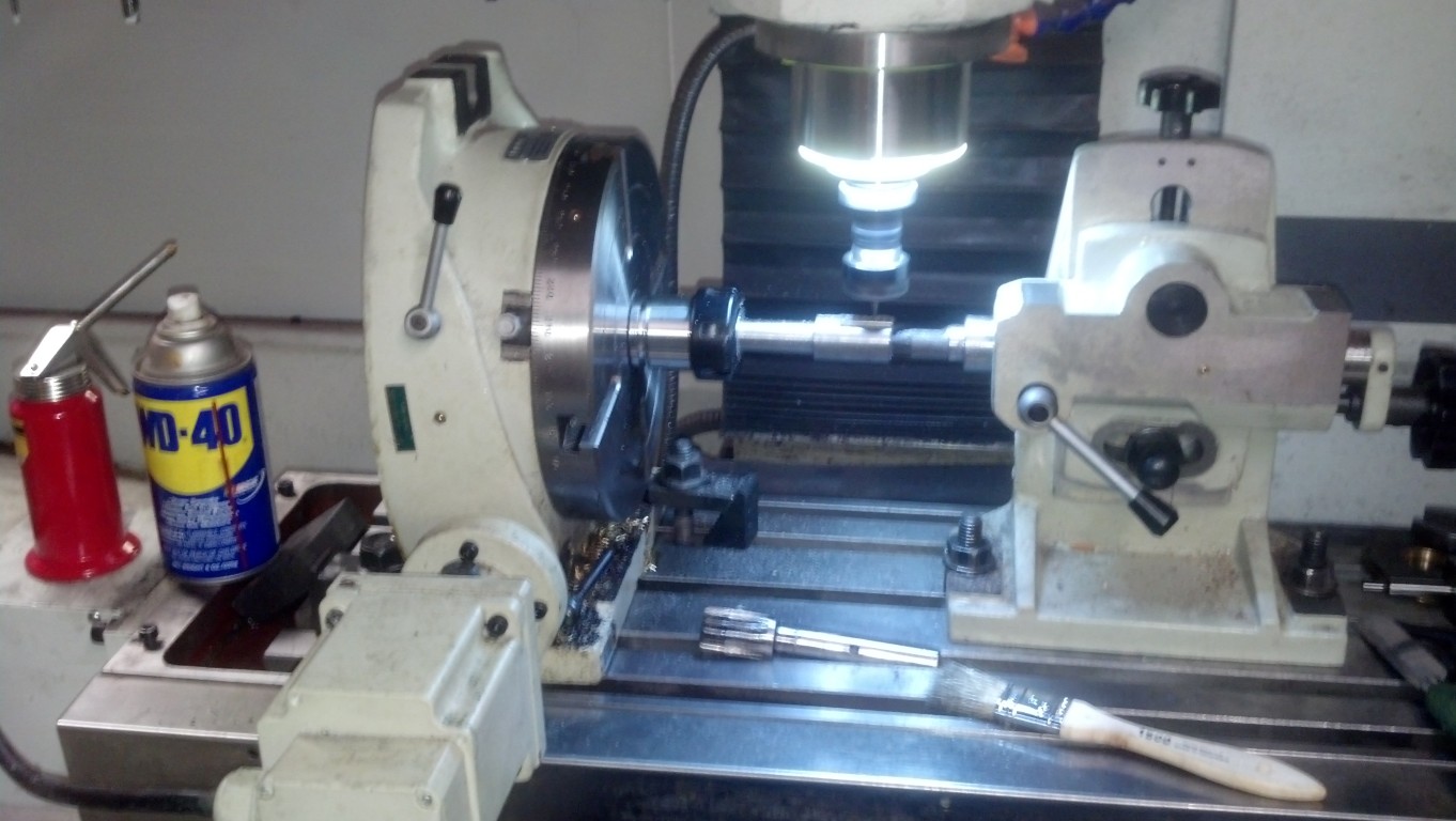

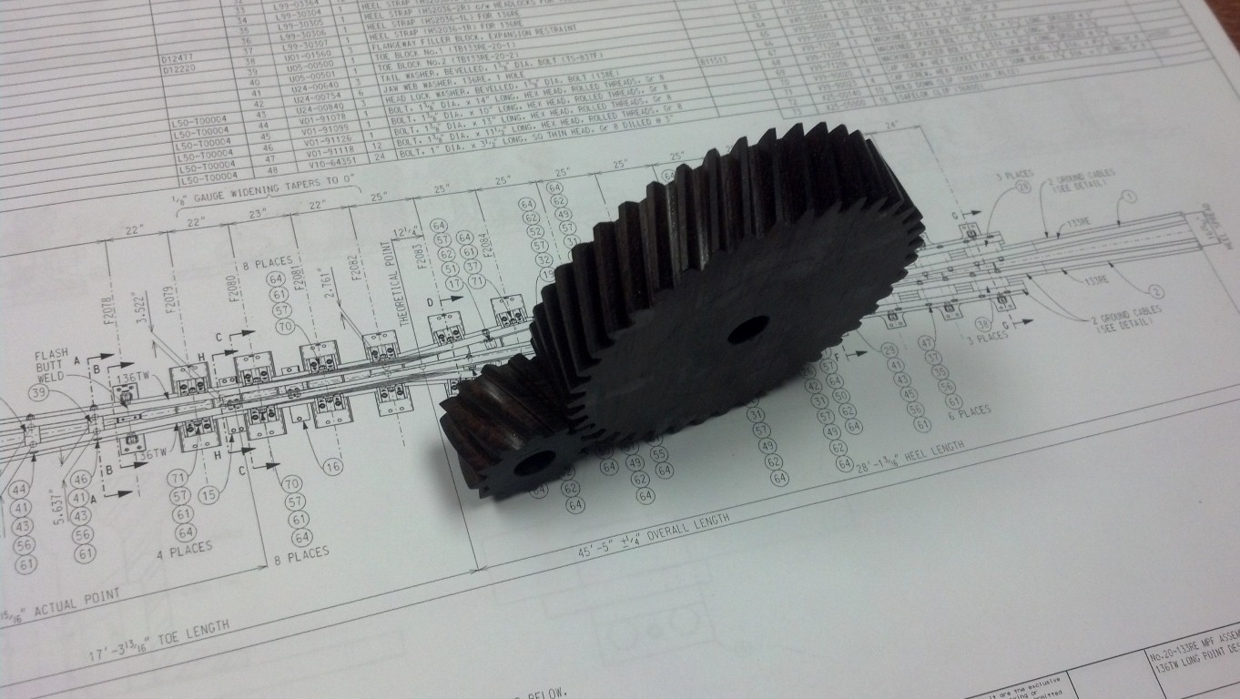

I use Gearotic on my CNC mil with a 4th axis to cut gears by gear shaving. It yields VERY accurate results. Not sure however how you would get a model file from it since it default output is G-Code for either shaving or 2-d cutting. A question to Art Feeney would likely be in order.

Below are photos of Gears machined with Gearotic Code.
