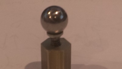

I've come up with a different method to attach the ball bearing to a screw for the Magnetic arms. I grind a small cup into a phillips head screw, and then silver solder the two together. I do sand a spot in the ball bearing to help flux, and solder adhere. I then have to buf the ball a little because it oxidizes a little from the heat.

why not just use traxxas ball ends?

I bought these before I read about he traxxis ball ends.

Someone asked why I didn't just get the traxis balls. Well I've been tooling away in the shop, and figured I had most of the parts already.
I know most people don't have lathes at their disposal. But I happen to. I made a small jig for the lathe to screw in a small phillips head screw, turned it down a little, and put a cup in the top. That's mainly so the ball will sit level when the silver solder melts. The picture is the second jig used to silver solder it all together.
Yes buying the traxis balls would be faster, probably cheaper, and certainly a lot less time.
