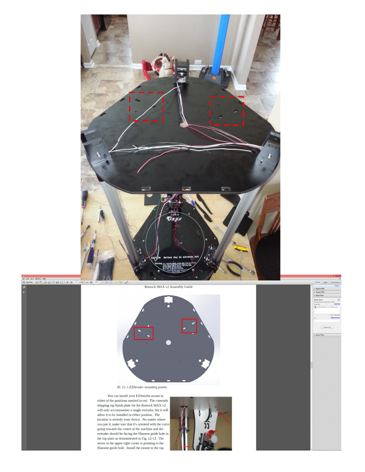

So far everything is going along swimmingly until I just noticed I installed the Top bottom plate backwards...
SO... since I am quite a bit past this can I continue and just adjust how I assemble the extruder mount? See below
we will see if the image shows up.
Re: RJ's v2 Build
yes, actually you built it the way I build them here at the shop... you will just mount the extruder as seen here... https://www.flickr.com/photos/seemecnc/12599516435/ I prefer this way because I like the blinky eyes to look normal when looking at the front of the machine.. but works either way...

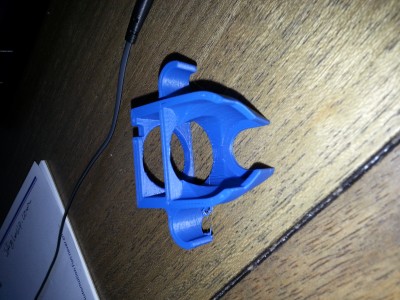

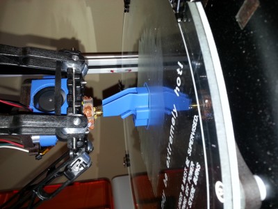

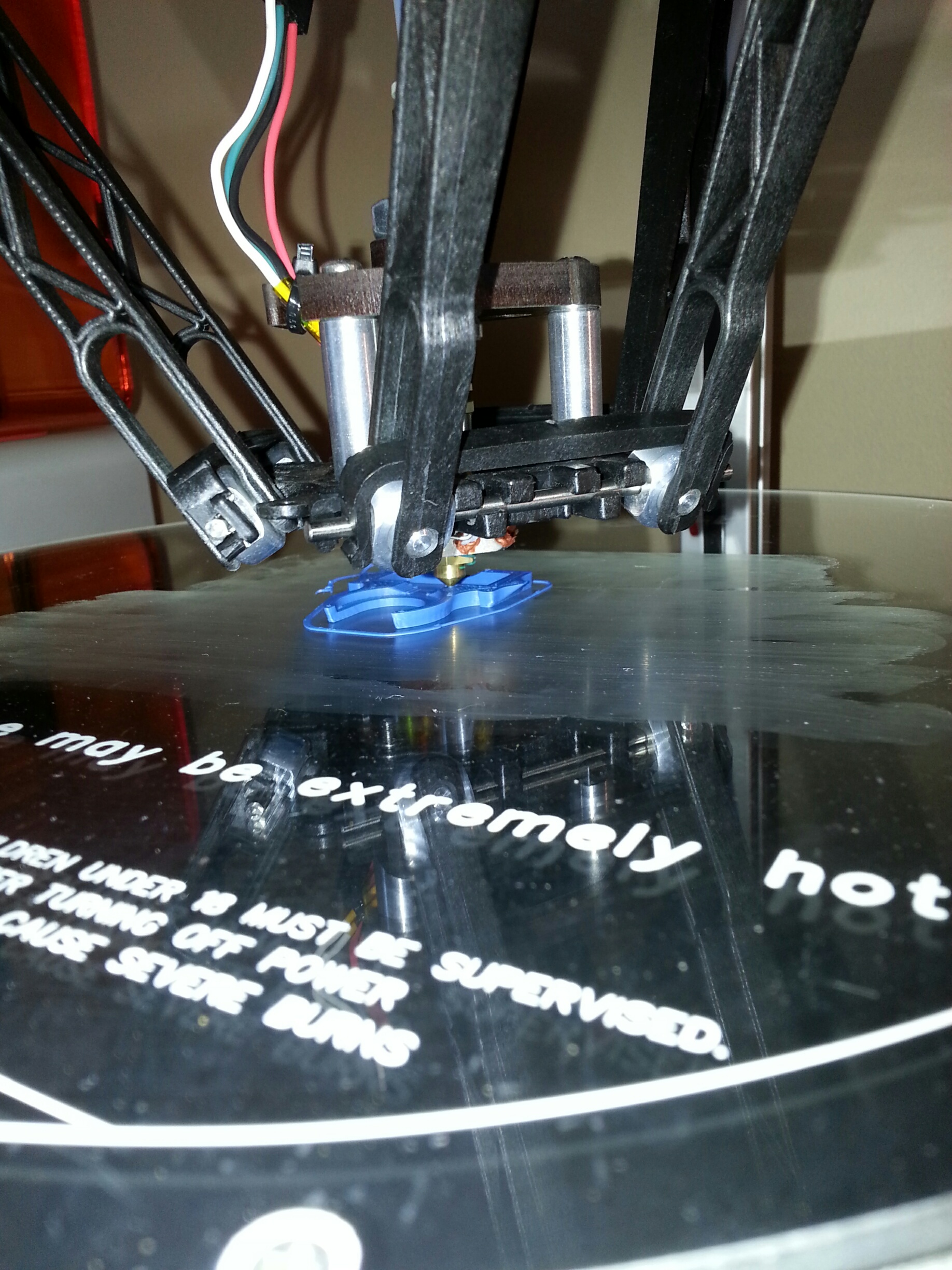

PEEK Fan Shroud Complete
before cleanup: Not too shabby for print number 1
Installed it and went to print the Layer Fan Shroud and it would not stick to the surface. Figured two things were against me here. A, I needed to recalibrate the axis after installing it. B, I needed to reapply glue, even though I was printing it in an untouched area.
Fixed both those situations and it is looking pretty nice!

Re: RJ's v2 Build
Good looking results!
You might also consider the closed Layer Fan Shroud. I have moved to this design and it puts more air directly where it is needed.
http://forum.seemecnc.com/viewtopic.php?f=35&t=5632
nitewatchman
nitewatchman
Re: RJ's v2 Build
Of course that looks like a better solution! Dangit! Printing again....
