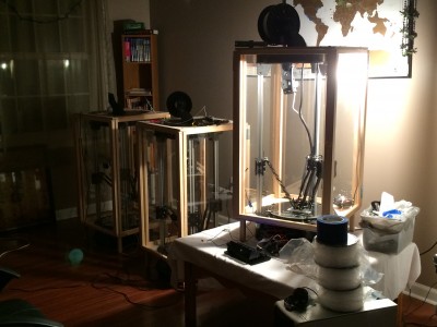

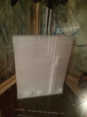

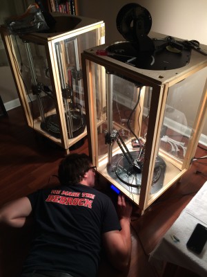

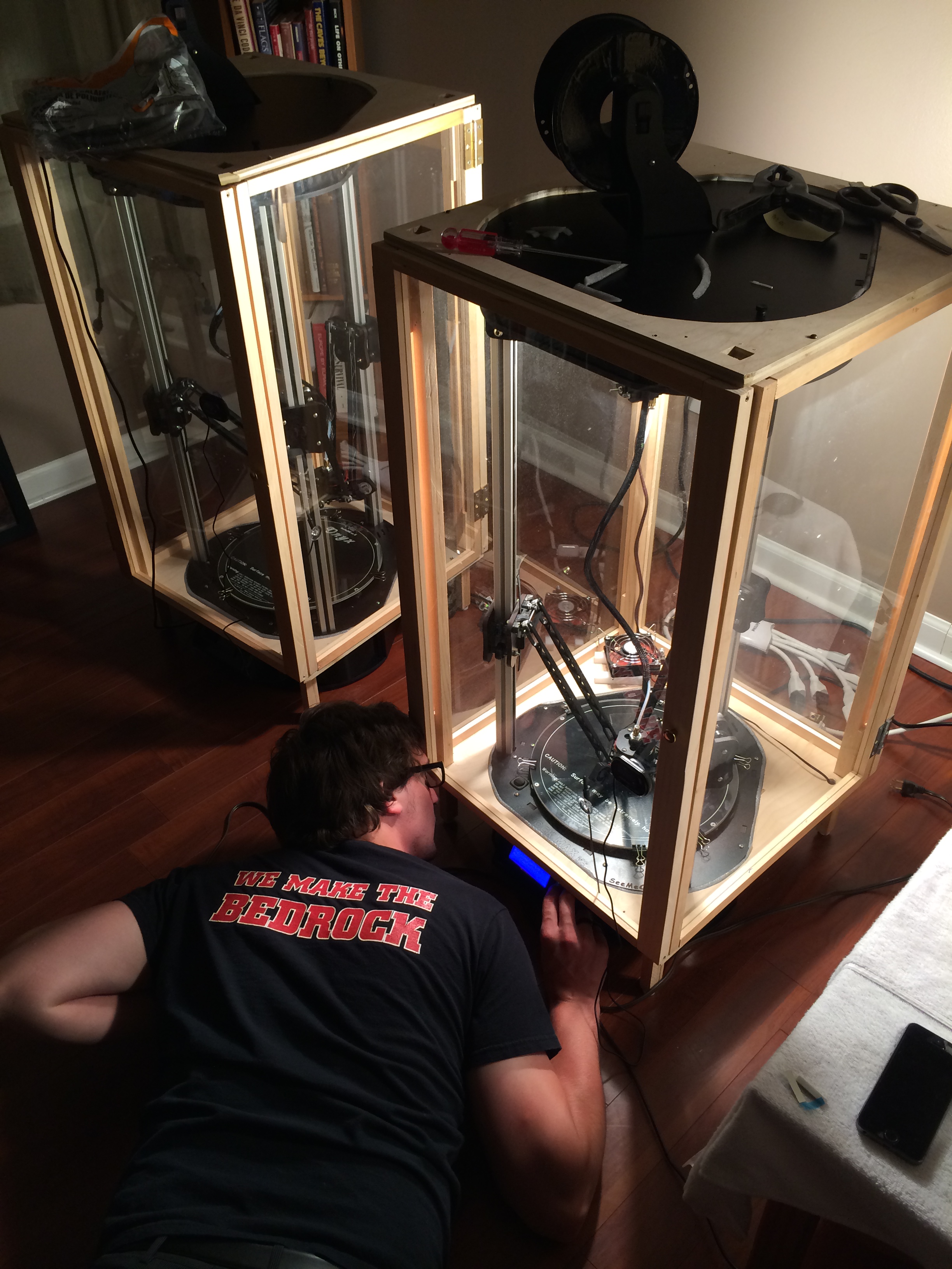

So I need to print ABS (for acetone smoothing) and I need to print large parts (final part is 36" long, so I'm printing 3 twelve-inch tall parts and then glue them together with ABS-Acetone glue). To prevent delamination, big cracks, and warping my FIL built enclosures. These are made of cheap wood and single pane glass. There are 200W light bulbs and a computer fan in the enclosures to uniformly heat the build area to about 110 degrees F. The heated chamber has definitely reduced the delamination to where there may be only one crack in a 12" tall print that is 10" wide, but I am worried for the safety of the components of the printers if I heat it any more. Perhaps CF arms are in my future. Anyway, just thought I'd share!

I built one rostock, took me 40 hours as I had never touched a soldering iron or built anything in my life. I fell in love with it, and now I have 3! I built the 2nd and 3rd printer simultaneously in only 24 hours. (it helps a lot when you don't need to keep looking at gene's manual over and over). I can't wait for my electric bill this month.

Nice job on the enclosures. As for heat, I'd worry about glues and plastics first. The motors and wire insulation are good for a lot more.
Have you popped a breaker yet? Three printers heating up, the 600W of lights, and whatever else you have on that circuit must be getting close. I can just imagine you cranking up the stereo and losing 3 print jobs at once.

Thanks Eric, I haven't tripped a breaker yet. I did have my UPS yell at me though when I tried to plug more than one printer into it. I should move the printers around the house so they're not all on one breaker. A tripped breaker when I'm not in the room paying attention would really be unfortunate as most things I'm printing are 12-24 hour prints. Thanks for the heads up!

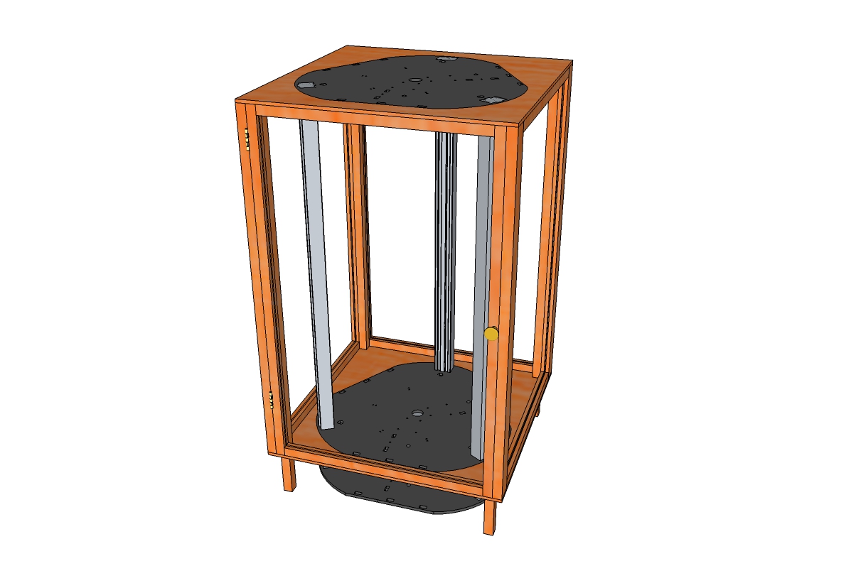

They look awesome.. I want to make some enclosures too, i was just thinking of the best design without making it too bulky
Do you think you could post dimensions of your enclosures for us out of curiosity ??
