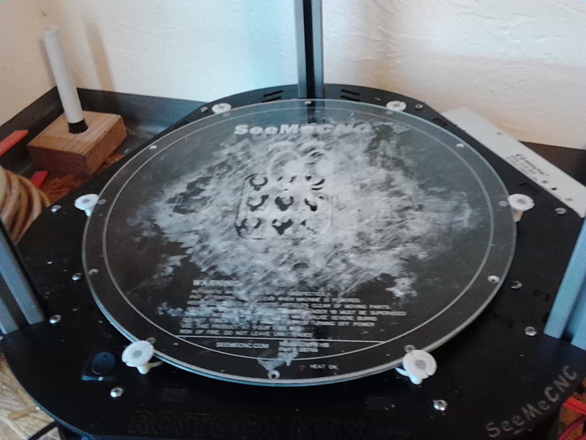

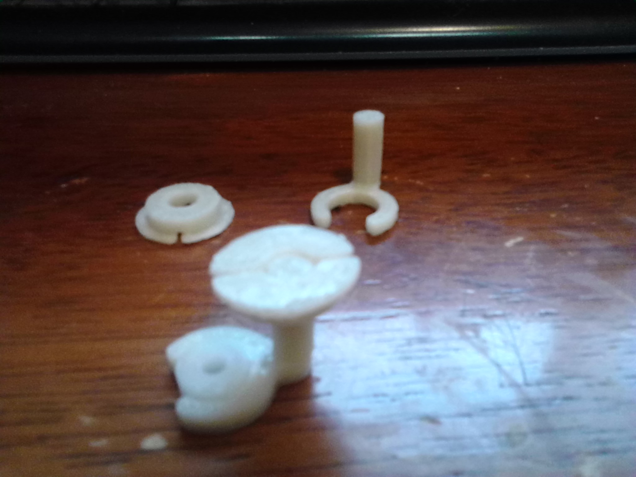

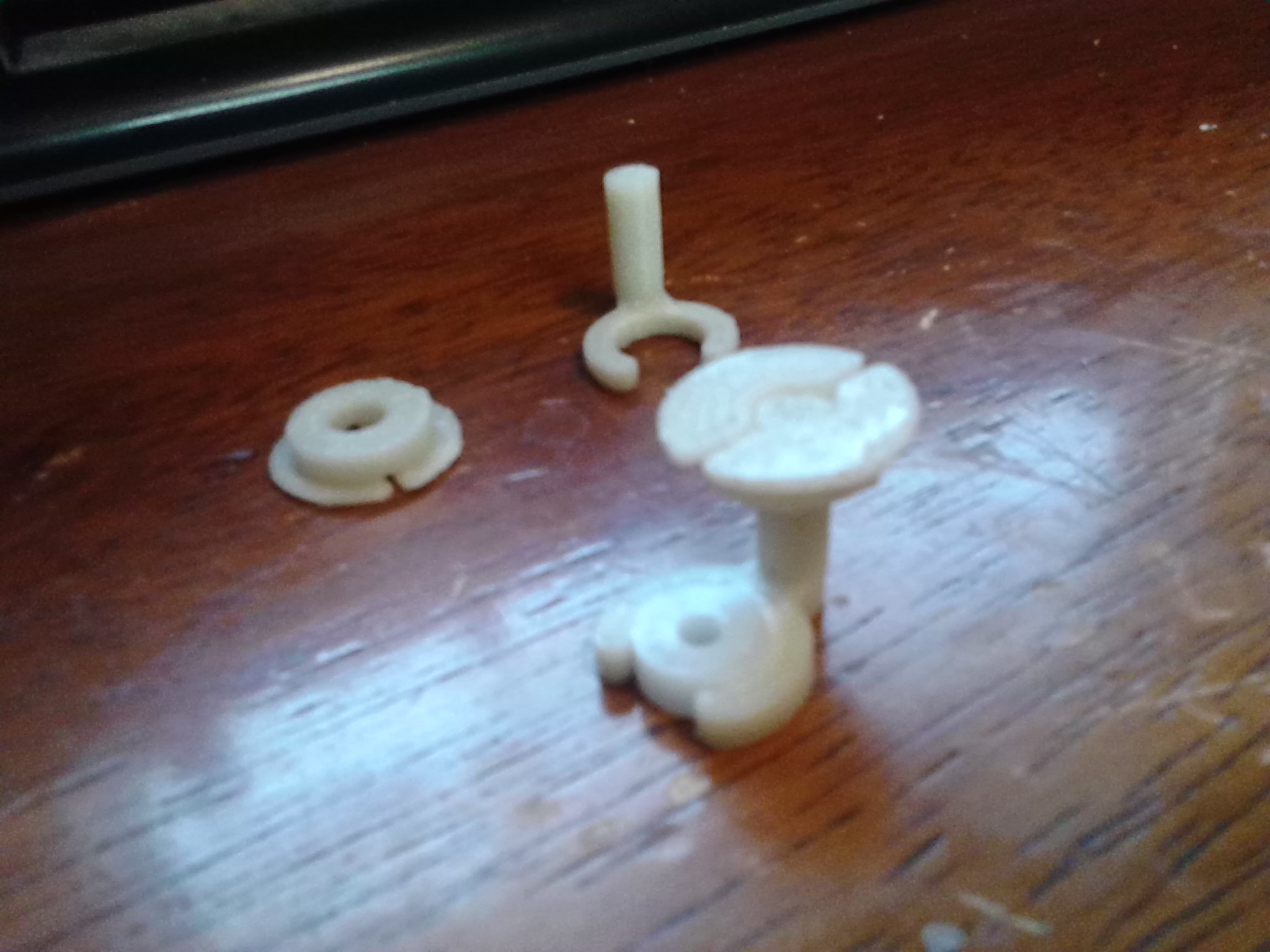

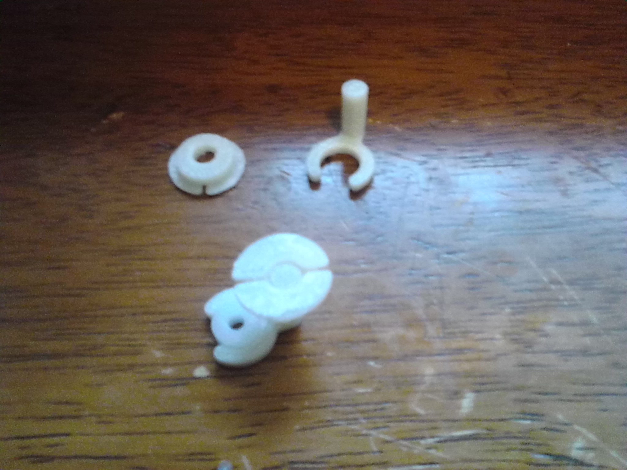

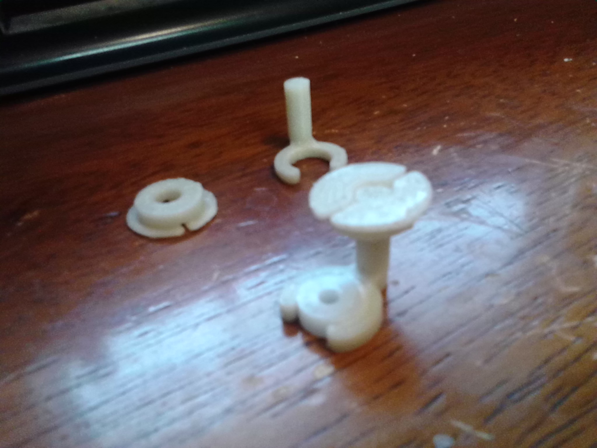

So far they are holding up.  They keep everything in place.  I printed with ABS so the dimensions might be off for PLA.  I will post the files and let people play with them.  I make them is Cubify so the source files are not exactly universal.
I initially planned on use the slot in the hub to adjust. However in practice you can do by hand. I think I may extrude the bottom part of the hub a bit to make it a bit less wobbly when placed on the clip part. You will have to sand/file the clip post or the hub as the tolerances are tight. With PLA it might be loose. Or maybe with a better calibrated machine it will be loose. I don't know.
I do my clips in batches of 9 to prevent heat from sagging the post. With the hub I just did 6. You only need six total.
If someone needs this modified here are the Cubify files, or if you are really nice I can play with changing dimensions for you. Let me know how these work out for everyone. They are working fine for me now. I just was tired of my paper clips from flying off across the room when I pried parts of the borosilicate.
