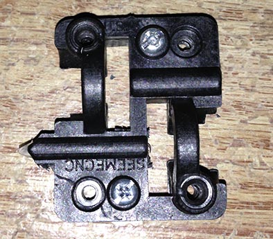

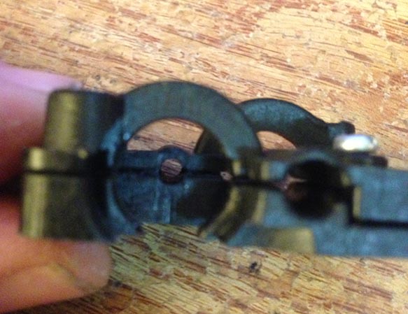

Ok, so I finally got around to taking pics last night so I'll finally write up what I did to mod the ezstruder to print ninjaflex at 50mm/sec
Sorry if this is pic heavy for such a simple mod, but that the way I write how-to's because its easier to see whats being done than describing it...
yup, real detailed...

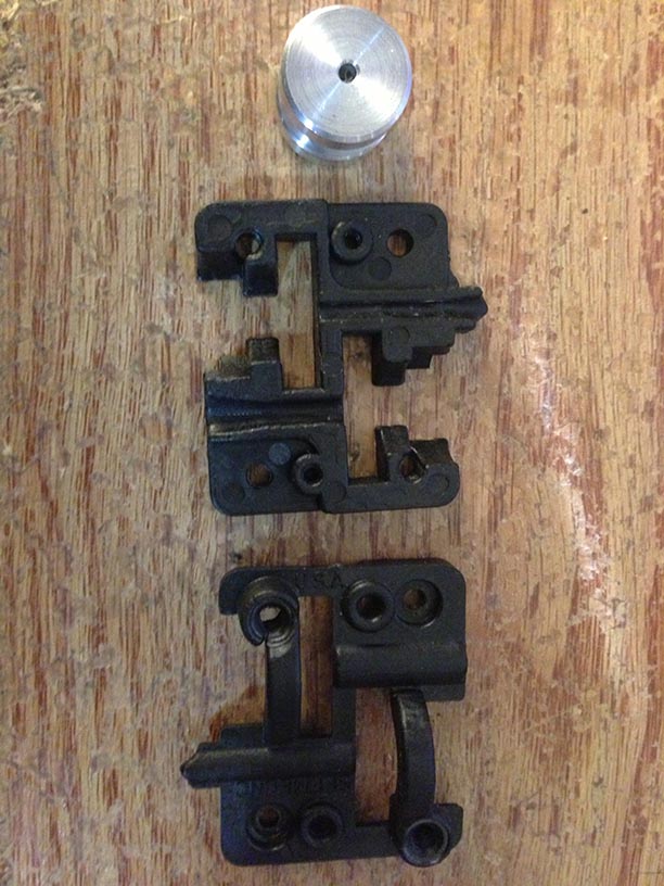

Step 1: disconnect the ptfe tube from the extruder.. depress the grey (or blue if you still have one of the older style) ring nice and hard, and give the tube a yank..
Step 2: remove the lower section of the ezstruder by removing the 2 long lower screws that attach the ez struder to the bracket, and the middle 2 screws that attach the black section of the ez struder to the motor so you have this piece seperate:
Step 3: seperate the black piece and remove the aluminum adapter
Step 4: I found some random small screws to attach the two halfs together while they are off the motor, place a couple screws in the middle holes to clamp the two pieces together..

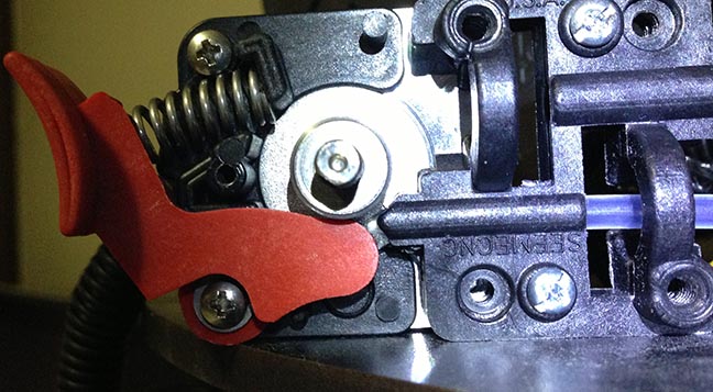

Step 5: using increasing sizes of drill bits, drill out the channel where the filament runs (the 1.75mm channel)... this could be done on the 3mm side as well if you want to be able to revert back to standard if you want, I didnt bother, but thinking about it, that would work just fine... this pic is after 2 drills (one small then one step larger) take your time and run the drill through it while squeezing the halfs together being very careful to keep your fingers away from the drill bits!
Step 6: Increase the drill bit size until you have just enough room to put some PTFE liner in the hole.. the last drill bit size I used was 11/64 (used what I had, no metric bits around my bedroom)
Step 7: remove the middle screw that holds the clear cover on the part of the ez struder and remove the cover... (no need to remove the 2 screws that actually go into the motor on the corners)

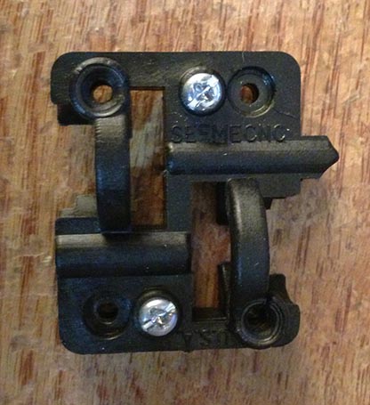

Step 8: using a razor knife or something similarly shap, shape the tip of the ptfe liner to a V leaving one side lower than the other... the reason for this is the idler on the ezstruder is a smaller diameter and sits slightly higher than the drive gear, you want the V of this cut to basically go along each roller without leaving a gap
Step 9: with the V of the ptfe about 1/4 inch sticking out, line the top holes of the black piece up with the holes for the motor, this pushes the ptfe tube sticking out back in to the correct distance for when its bolted on..
Continued on next post....

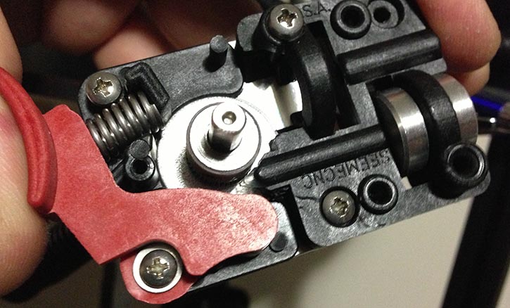

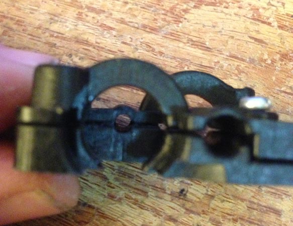

After alignment:
Step 10: Without moving the V side use a razor knife to trim the PTFE tube flush with where the aluminum adapter sits.

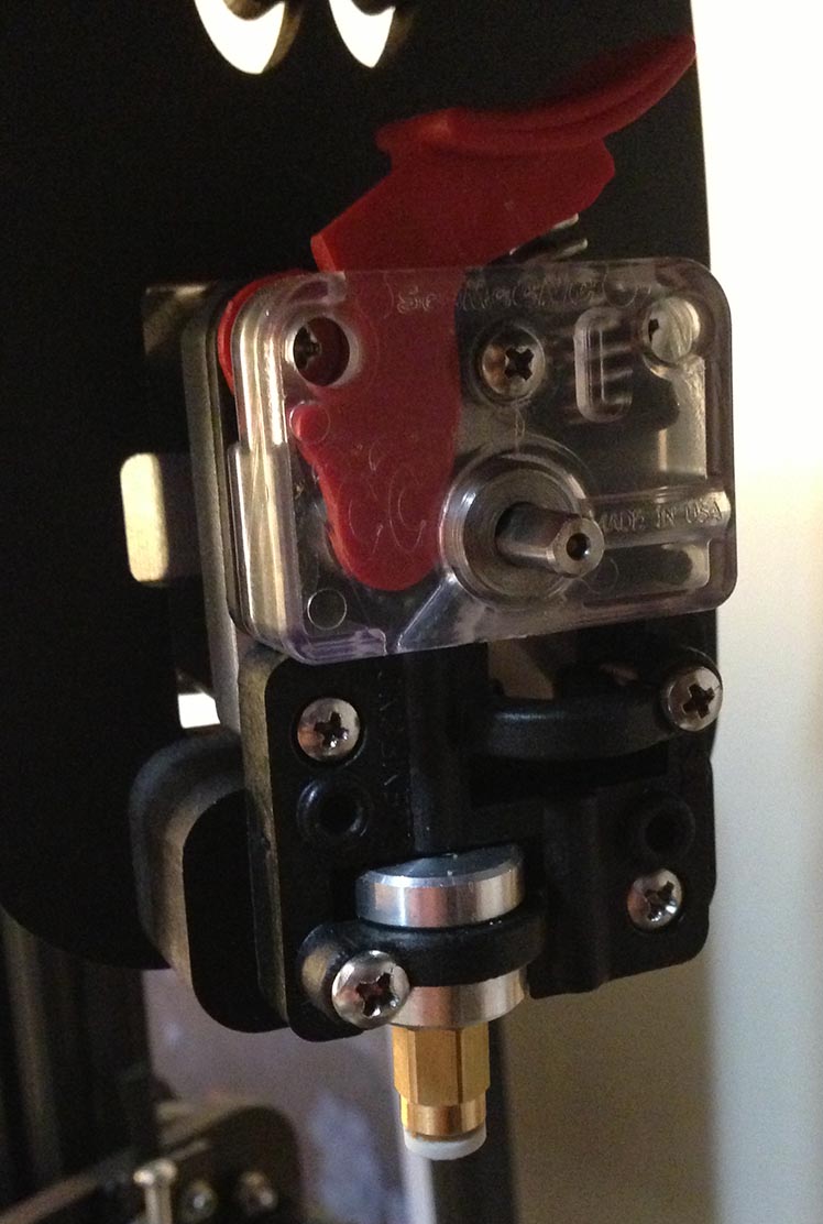

Step 11: remove the temporary middle screws, open the halves and replace the aluminum adapter, then screw the assembly with ptfe tube to the motor and check alignment with the drive gear and idler.. here I opened the idler to show the ptfe sticking out.
Step 12: replce the clear cover of the EZ struder, and feed in some filament, you will notice its slightly more difficult to get it in the ptfe liner, this is because of tighter tolerances, and if you have a gear or knob for the extruder, it makes life a LOT easier as you only need it to bite and you can use the knob to feed the filament.. heres me testing the feed..
thats it! put your ptfe back in the push fit connector and you are good to go.. this mod eliminates the gap that when printing filament like ninjaflex that it can bind up and jam into...
before this mod I couldnt go faster than about 18mm/sec with ninjaflex before it jammed up in the extruder... after I brought it up to 50mm/sec with no problems, could prolly go faster but I dont print fast to begin with, so that was plenty fast for a verification that it works..
hope this helps anyone who wants to print with crazy elastic materials
Guanu

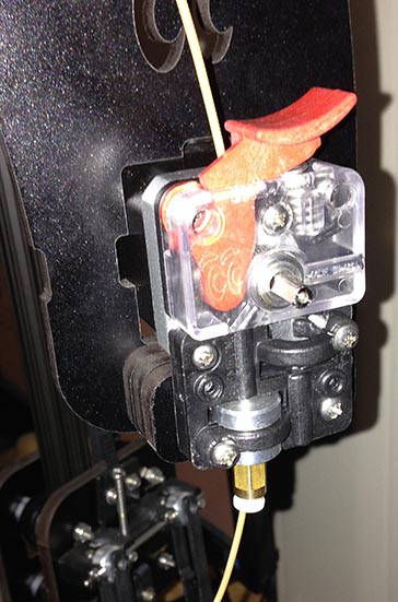

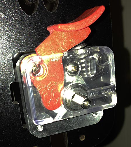

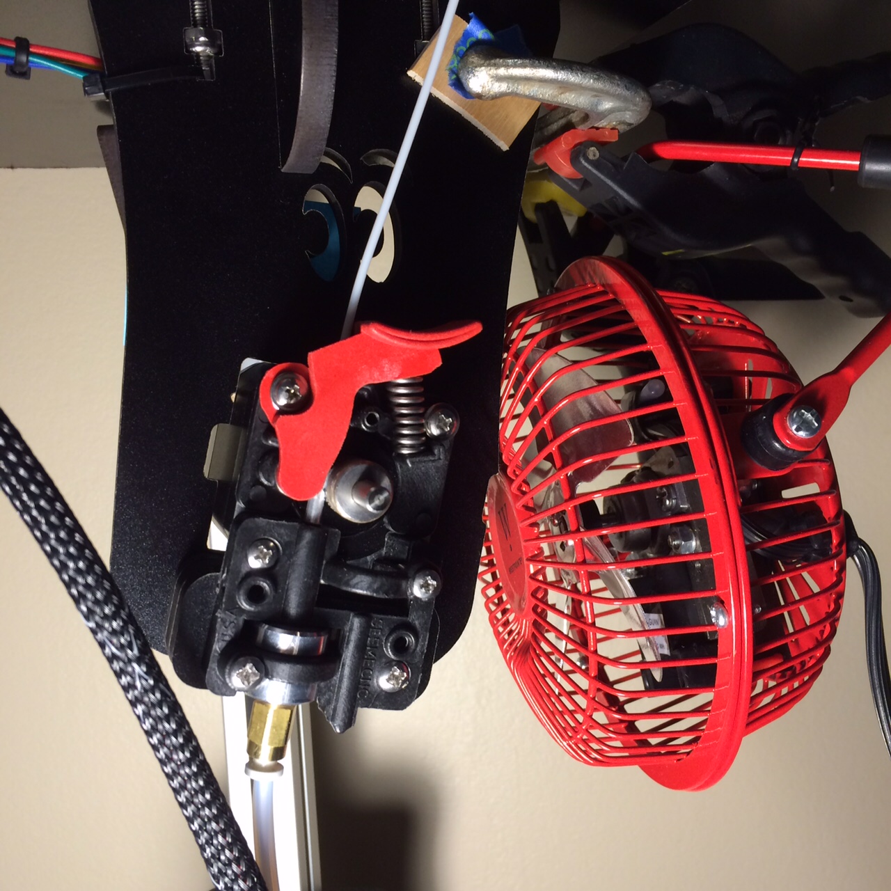

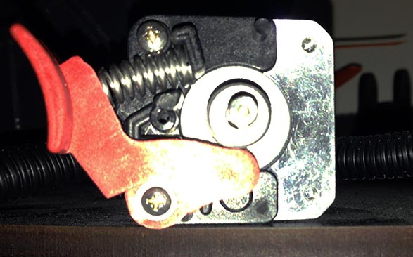

EZStruder Fix for Flexible Filament
Printing flexible filament seemed impossible with the EZStruder on my Rostock MAX V2. Here is one fix which involves no printing, gluing cutting, or drilling of the stock parts, and cost less than $13. It is all reversible if needed, no harm done.
I flipped the EZStruder filament guide block 180 deg. (Item 2 in Fig.10-1 of the Max V2 Assembly Guide), installed a 1/8 inch dia. aluminum tube to tame the filament, and added a small fan to keep the assembly cool. The photo shows the final arrangement.
The flipped guide block has “USA” on the left and “SEEMECNC” on the right, which is upside down from how it was originally, or supposed to be, installed. The aluminum tubing is 1/8 x .014 in. from a hardware store, and is approximately 27mm long. The upper end is angled to a point in order to fit as close to the wheels as possible. I suspect you could make it just touch the wheels on both sides and the soft aluminum would quickly wear into the right clearance. The tube extends down through the guide block to the top of the large cylindrical aluminum fitting, and is wrapped with a layer of electrical tape to keep it tightly sandwiched in the guide block. The guide block on that side has a pathway slightly larger than the diameter of the tube.
The fan, a $10 4 inch desk fan, cools the potentially hot stepper motor, so it doesn’t heat the filament and make it even more flexible. Not sure it this is a necessity or a precaution, but cooler is usually better.
I removed the clear plastic cover so the pinch point, or potential jamming site, is easy to see and check on. The same is true for the nylon manual turning wheel. I’ll pop that on later if needed.
The extruder is set to 230 C. I started the print speed at 10mm/s and have increased to 30mm/s over the course of several tests without any jamming. The source of flexible filament is unknown since it was a gift from a frustrated printer and has no brand name on the spool. Nevertheless, it made a nice cell phone case for a test. Maybe Ninja-Flex is next!
