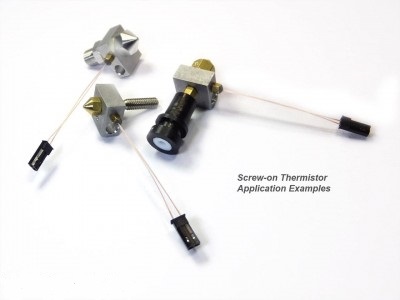

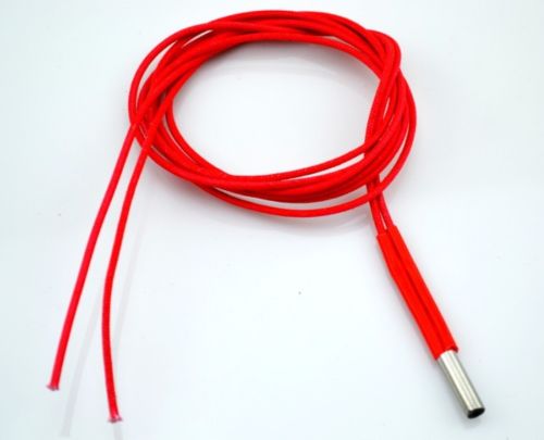

Ceramic cartridges have been out for some time now and thermistors can be encapsulated in a Male-Female Threaded Hex Standoff with some high temp
epoxy and there is no need to use one drop of the RTV silicone. An example of a threaded thermistor and ceramic cartridge is here.

I think that the best way to lock the thermistor is in fact the threaded capsule, this method is the only one can guarantee optimal thermal conduction and retention over time; also is easy to replace and made at home.

Tomorrow i should go to the store to buy a copper screw (M4 or M6) for realize my thermistor capsule with hight temp epoxy.
