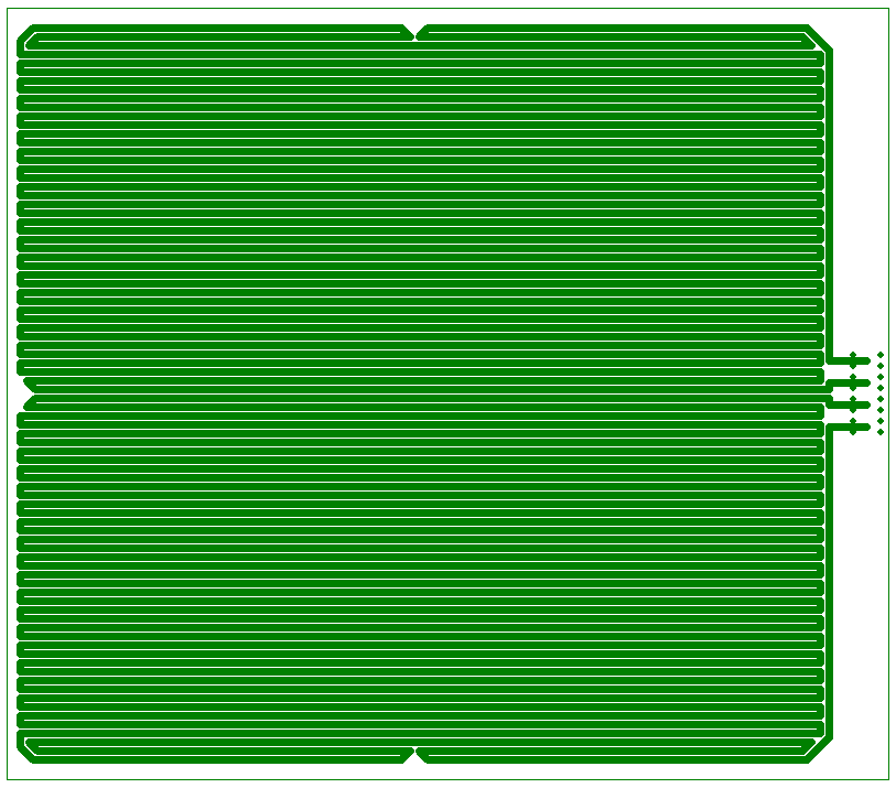

Good point, the MK1 HBP is 8.4x8.4" (70.5 sq in). If we need 7x7.5(52.5 sq in), we are effectively removing 18 sq in (25%) of the surface area. I am thinking to compensate we will need to run the board at higher voltage.
Thoughts? Anyone versed in eagle design or whatever design software to create a proof of concept?
Mike Latif
H-1 #3
Posts: 2417
Location: Redmond WA
Re: (Group Buy) for 7"x7.5" Heated Bed
Post by Polygonhell »
Surely less space means less trace means lower resistance, means more current and as a result faster heating.
Isn't the issue going to be potentially drawing too much current?
Polygonhell wrote:Surely less space means less trace means lower resistance, means more current and as a result faster heating.
It is a bit more complicated than that. To obtain adequate heat, the board must be designed to have enough traces to obtain the
the correct current for that size of board. A smaller board would have thinner traces than a larger board but it is a balance of the
area of copper, the proper current and the breakdown of the traces depending on that current. Lesser amounts of traces does result
in reduced resistance and higher current but does this higher current adequately generate the proper temperatures without destroying
the traces? It is a balance of board size, width of the traces, thickness of the traces and how many traces. It needs to be created and
thoroughly tested for heating effectiveness and burned in at the proper temperatures to ensure the design does not cause melted or lifting
of the traces from the substrate.
Regards, Carl

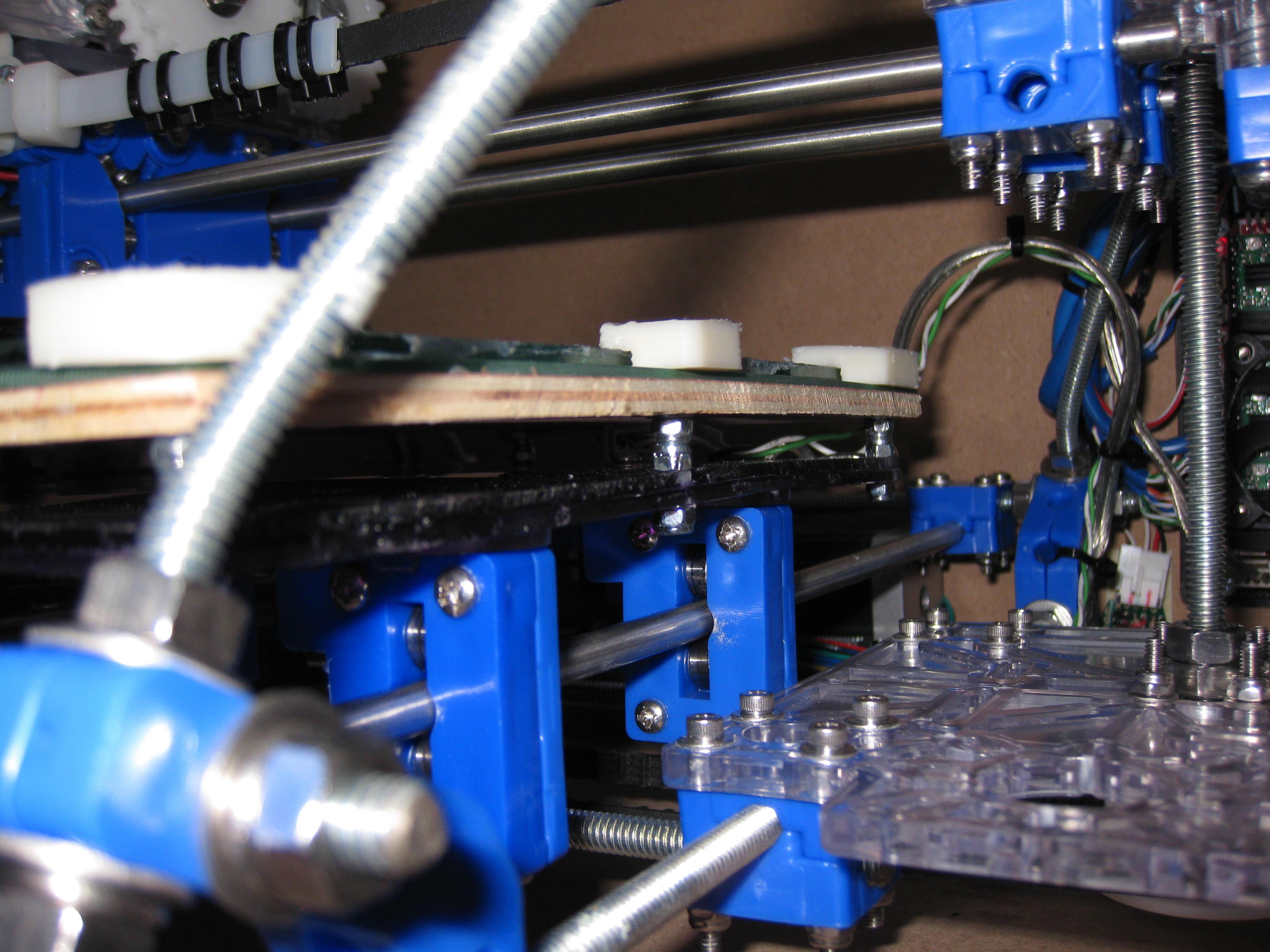

There may be another option to building a heated bed using circuit boards with traces. The people that built this heating pad will build them to what ever wattage and voltage you need. This one is a 50watt at 3"x6" 12 VDC. I can check with my son in law and find out where he is getting these.
[img]http://i132.photobucket.com/albums/q3/D ... 0_1193.jpg[/img]
Dave Sohlstrom

TKL
Posts: 41
Joined: Sat Apr 14, 2012 6:07 pm
Location: Denmark
Post by TKL »
Here it is (cobber layer only). The pads looks a bit wrong due to a missing apt file and the led is not added yet. The board is for 12 and 24V actually. The heating tracks are split into two 12V / 60W sections. You put them in parallel for 12V and series for 24V. Don't worry about the calculations; I am E-Engineer.
TKL wrote:Here it is (cobber layer only). The pads looks a bit wrong due to a missing apt file and the led is not added yet. The board is for 12 and 24V actually. The heating tracks are split into two 12V / 60W sections. You put them in parallel for 12V and series for 24V. Don't worry about the calculations; I am E-Engineer.
Are you able to create this board and test it before committing to purchasing the 25?
