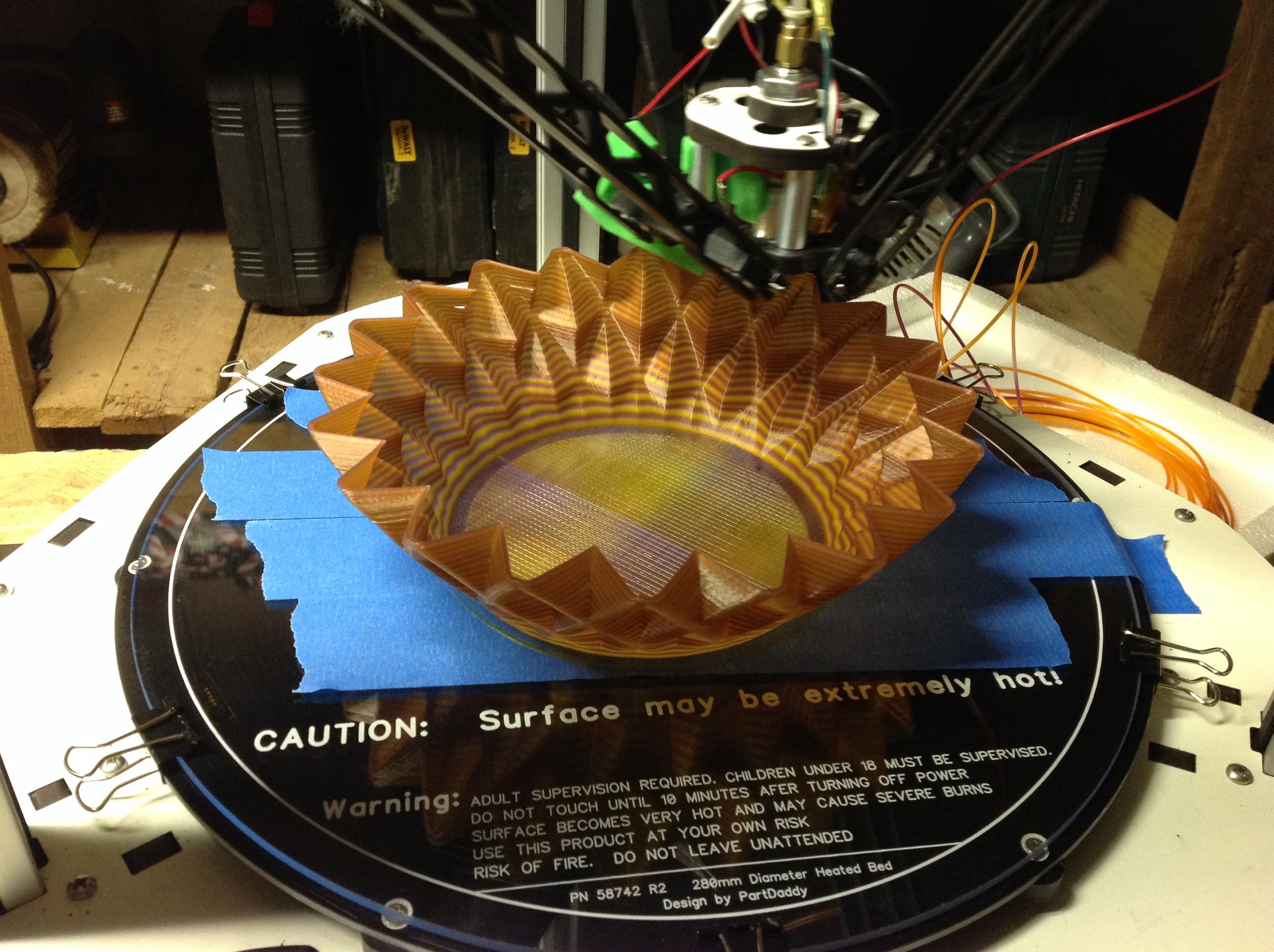

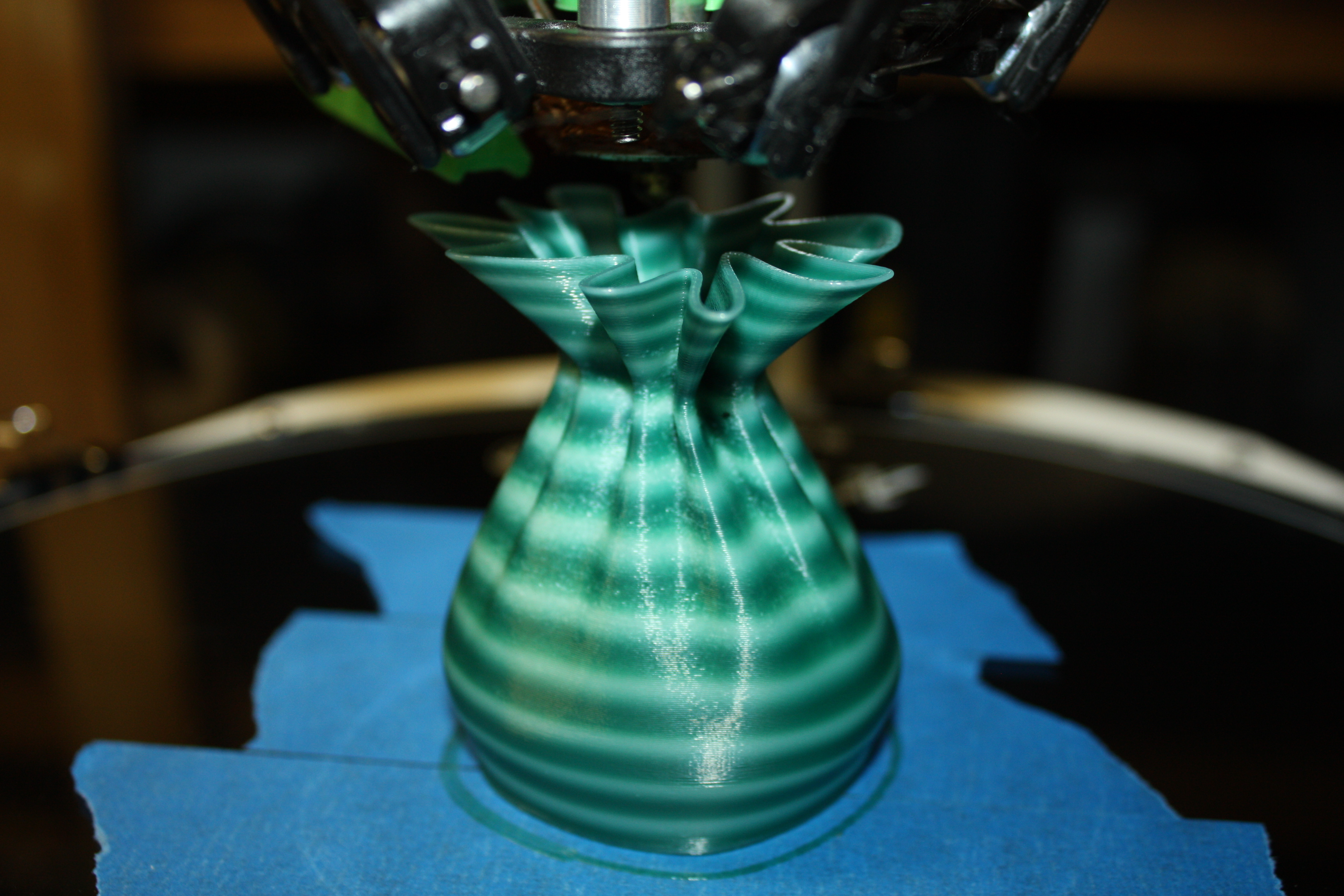

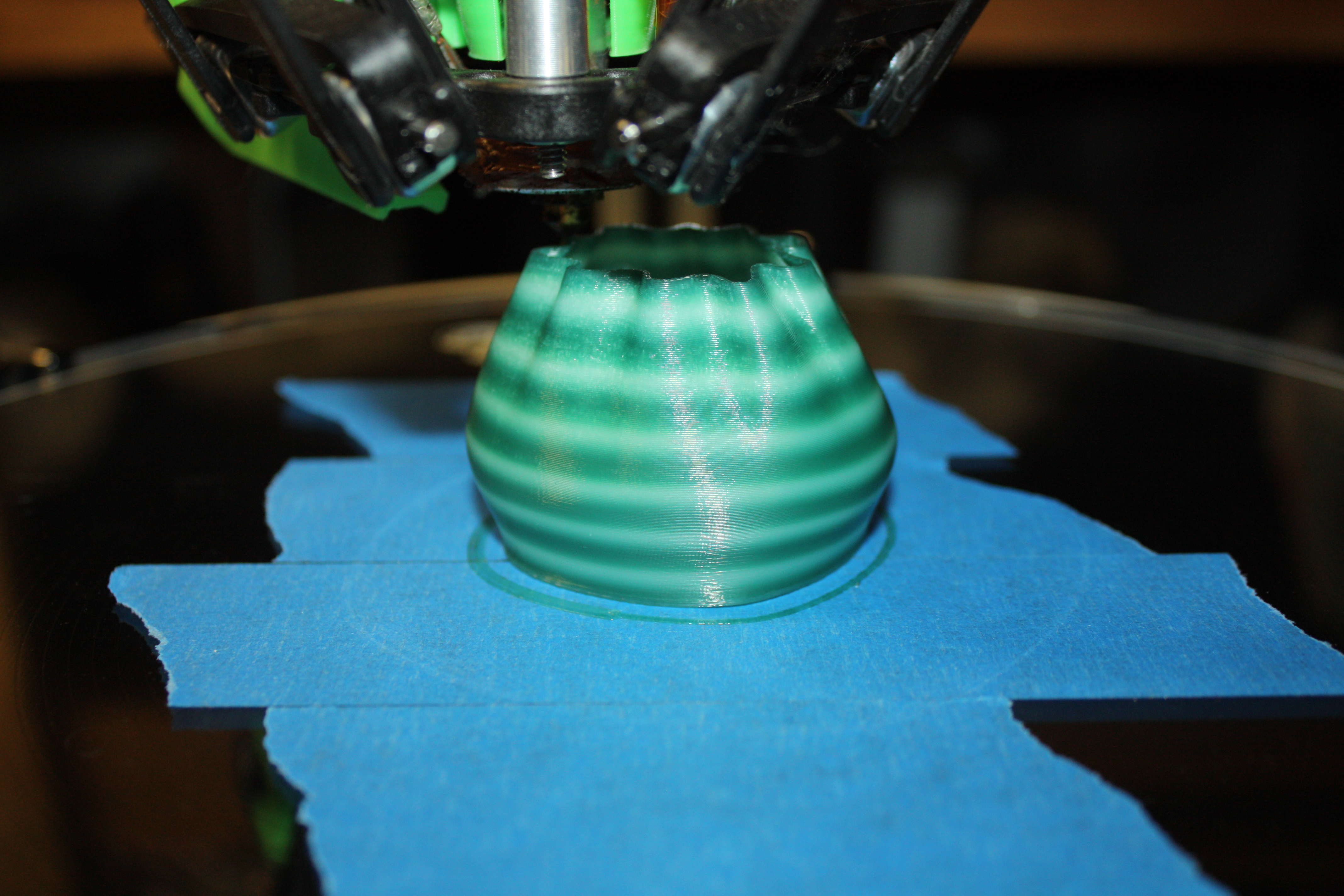

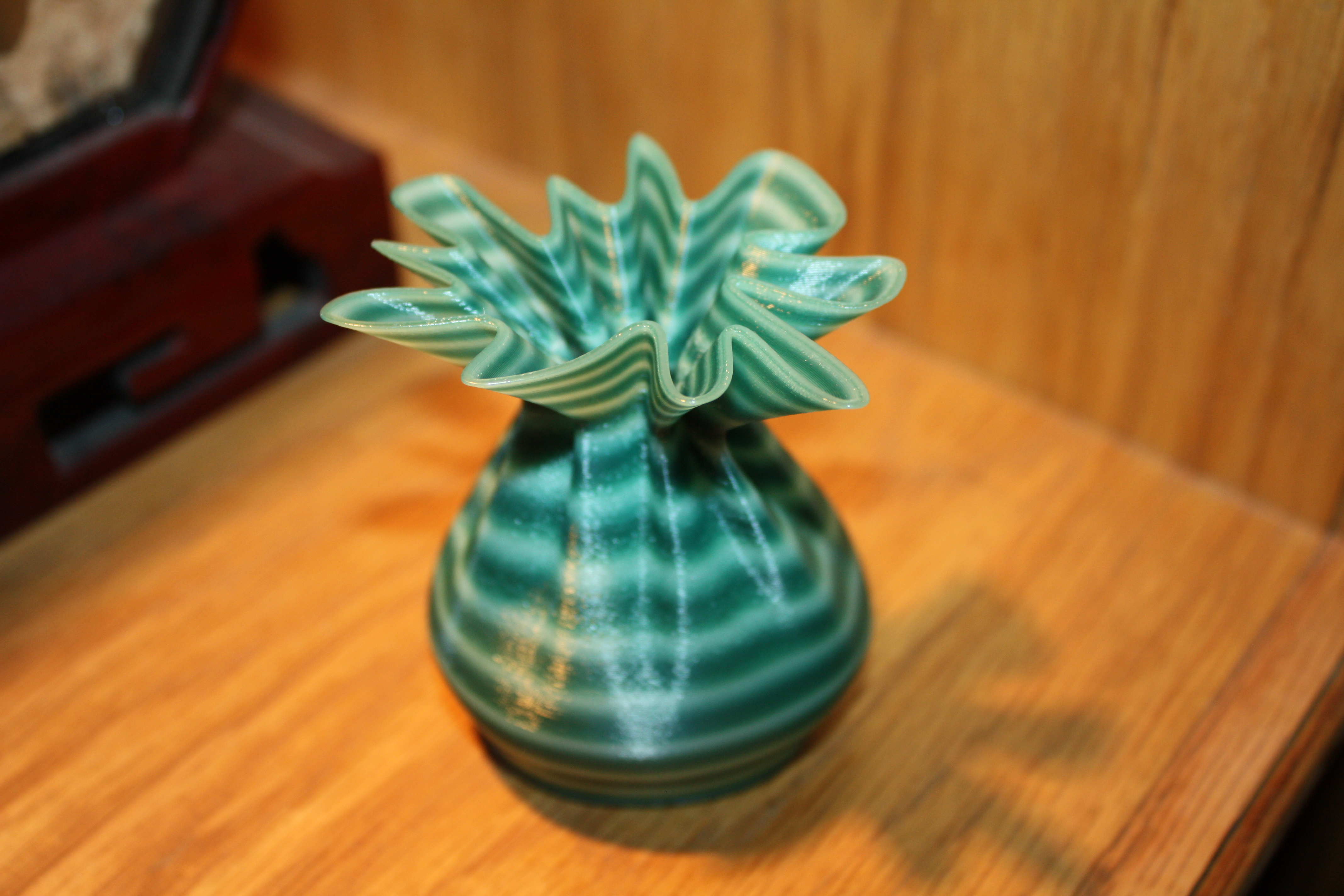

I have been playing with nylon and recently I attempted to dye it using RIT brand fabric dye. This is my first model sliced with Cura. I really like the Spiral Z setting. It makes for a Very smooth finish with no exterior seams. Here are the results. Its just a small proof of concept

Thanks! I pretty much did exactly what this guy did.
http://richrap.blogspot.com/2013/04/3d- ... nt-in.html
I dried my filaments on top of my home stereo receiver. It get nice and toasty warm.
On the printer now. I need to make the walls thicker. It's separating in some places.
Re: Dyed Nylon Proof of concept
Another option - that is much better for nylon - is iDye Poly. It was developed explicitly to dye synthetic materials. It has some very nice bright colors that do not fade. It's cheap and easy to use too. I've been using it for over a year to dye polyester and nylon for fly fishing lines and more recently, nylon filament.

how does this work? do you soak it over night? does it work with PLA?
It works great, follow the directions on the iPoly, it takes about 10 minutes. Since PLA already comes in all the colors I need I have not tried dying it. Nylon only comes in white/natural so it made sense to investigate dying it.
