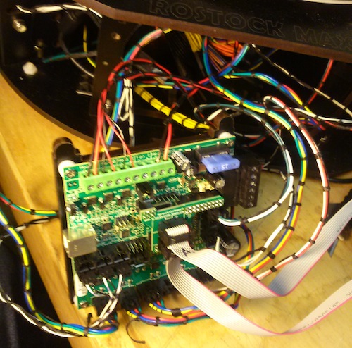

  2. Per Gene's recommendation, learned how to lace wire bundles, and laced every wire in the printer to within an inch of its life (... big fun...):
    Wire lacing around RAMBo board

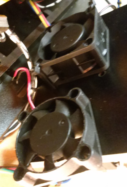

  4. Replaced the RAMBo cooling fan with a much quieter one. The original fan was noisy with a nasty whine, substantially louder than the PSU or PEEK fans. I replaced it with a Scythe Mini KAZE ULTRA 40mm fan from Amazon for $6.84 (free shipping):
    New RAMBo cooling fan, with original fan in foreground
    It's twice as thick as the original, which makes installing the RAMBo slightly more fiddly, but it is a WHOLE lot quieter. I can barely hear it over the PSU and PEEK fans now.

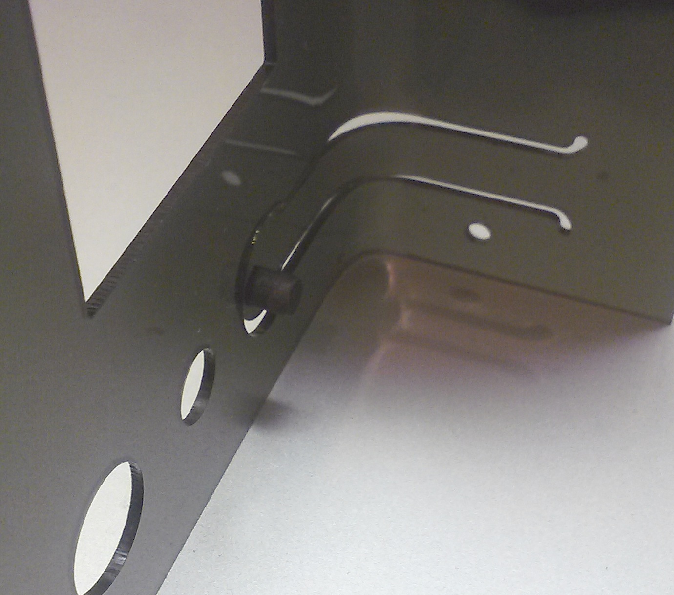

  5. Added an extender to the reset button on the LCD front trim panel so that you don't have to press the trim panel tongue in 1/4" to get any results. I used one of the cylindrical leftovers from the Melamine sheets, trimmed a bit shorter and SuperGlue'd to the tongue on the trim panel. Be careful about positioning; you need to put it further towards the end of the tongue than you think. The results are good, with a nice positive snap action:
    Reset Button Extension

Holy crap that's a lot of lacing. You're going to want to cry the day you have to make a wire modification.

Tinyhead wrote:Holy crap that's a lot of lacing. You're going to want to cry the day you have to make a wire modification.
Heh, you should work on aircraft!

It was a lot of fun; I released my inner neat freak. (Then again, given how many comments I've submitted about the manual, maybe that neat freak isn't so "inner" after all.)
Re: Dan Griscom's Max v2 Mods
Lacing is SO much nicer than using wire ties. :D When I start building out the side console harnesses for the F-15, I'll post a few pics. It'll involve a 5 foot long pin board in order to align and locate all the connectors along the harness. Fun stuff. :)
