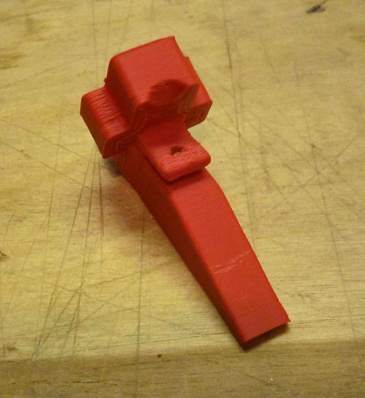

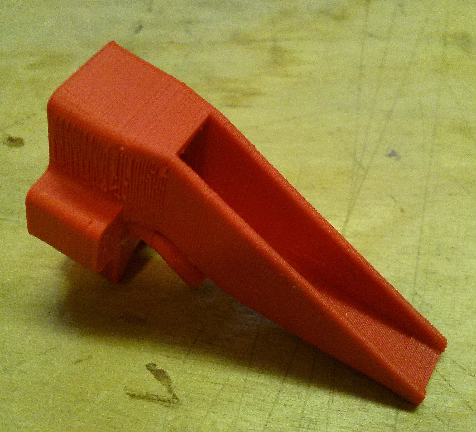

Well, I finally solved it by reworking John Olaphson's housing using OpenSCAD. I wrote a script that imports his STL file and does the following:
  1. Makes the fan slot 1mm wider and taller
  2. Adds some clearance above the mounting screw so that a screwdriver can more easily get to the mounting screw
  3. Added a bit of wall to better guide the air exhaust towards the part.
Here's the OpenSCAD code. It takes Oly's design, subtracts a cube to make the fan slot larger, subtracts a cylinder to add the screwdriver access, and then adds a plate to better guide the exhaust:
