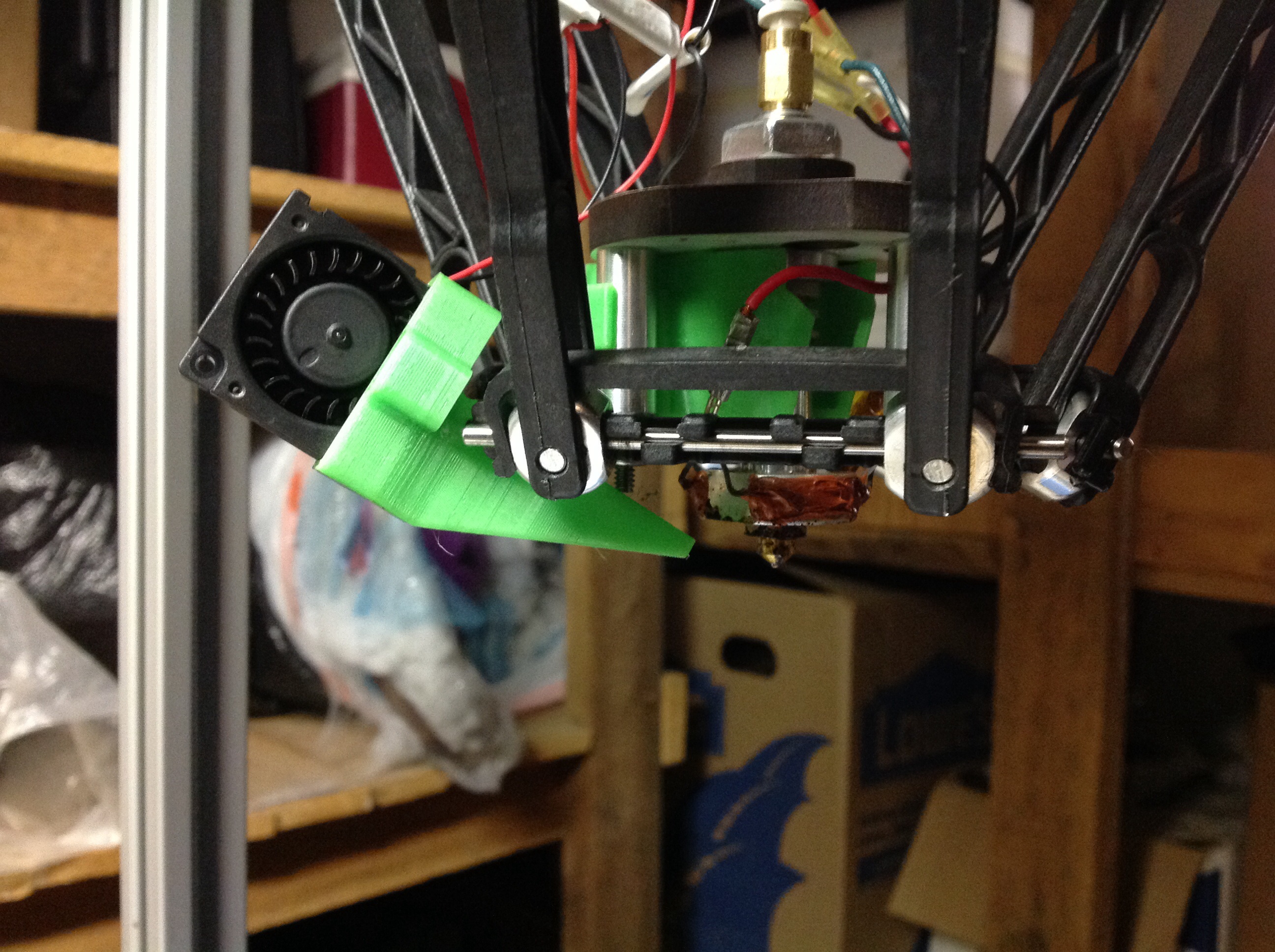

If the layer cooling fan is dropping your hot end temperature by 20 degrees, then it's blowing on the hot end and not the part. Can you post a pic of the layer cooling fan you're using?

Ok here is another symptom of the problem. When I run the PID calibration the hot end reaches full temp quickly and holds it well. I zeroed out my PID, ran the recalibration, and tried to print at 220. The hot end temp rises toward the set point then at 210 degrees you see the PID start cutting power to the hot end. The temp never reaches 220 so the print never starts. I have a setting wrong somewhere . My max temp is 240 so I don't think it's that. The Gcode was sliced by slic3er so I don't think its that. I am missing something. I think the problem lies with the PID.
As requested, here is the photo of my layer cooling fan.

Re: Hotend Temp off by several degrees
after careful observation of the temps and how much power was being applied to the hot end i have decided that i have a bad resistor. One was slightly cracked after i pulled it out and re-sealed it. I will install a 40w heater next week and that should resolve the problem.
