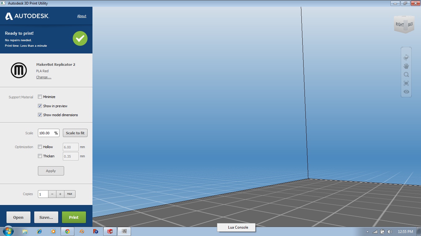

Found Lua Console in Autodeask 3D print utility
i like to play around looking for hidden things in closed programs and i stumbled across the "Lua Console" engine embedded in 3D print utility
if your a code junky i wonder if you can do some script impregnating into this autodesk 3D print utility
to get to the "Lua Console" ( center scroll type) you basically press and hold the scroll wheel, while holding down move mouse to your taskbar, without letting go press your right mouse button and the "Lua Console" button will appear click and off ya go. ( or vice versa reversing the method for right click center scroll/left button etc.. )
