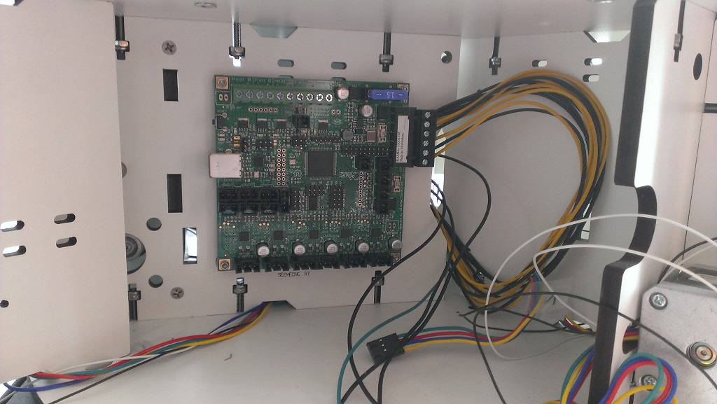

I have everything all together and those wires are not there.

hmm did not have a little bag with those, I do not have any switches other that the 3 limit switches. I just ordered three small fans one 25mm x 10mm and two 30mm x 10mm and a new LCD daughter board. I accidently soldered everything on one side of it, That's what we get when we work on it into the night, should have paid more attention.geneb wrote:A JST connector will not properly mate with the thermistor connectors on the RAMBo. The thermistor wires were included in the little Ziploc baggie that ships with the RAMBo box. It's the same bag that contained the three end sotp switches, the end stop wiring and the extra 2 and 3 pin connectors with crimp pins.

I've never seen a RAMBo box from Ultimachine that did NOT have that little baggie. Keep searching.
