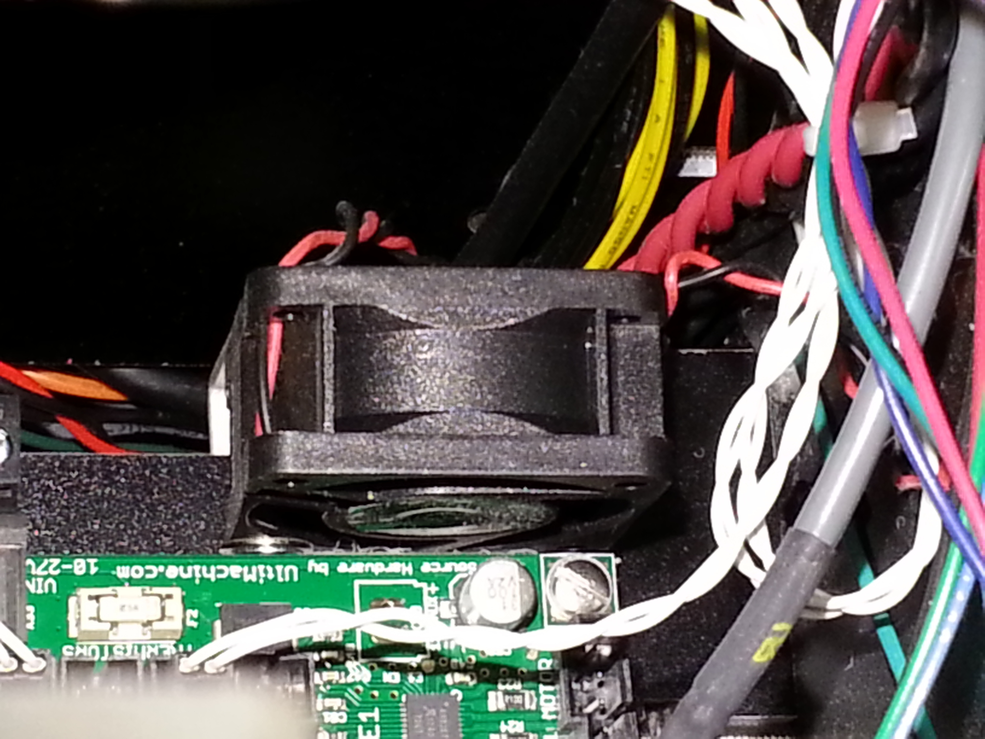

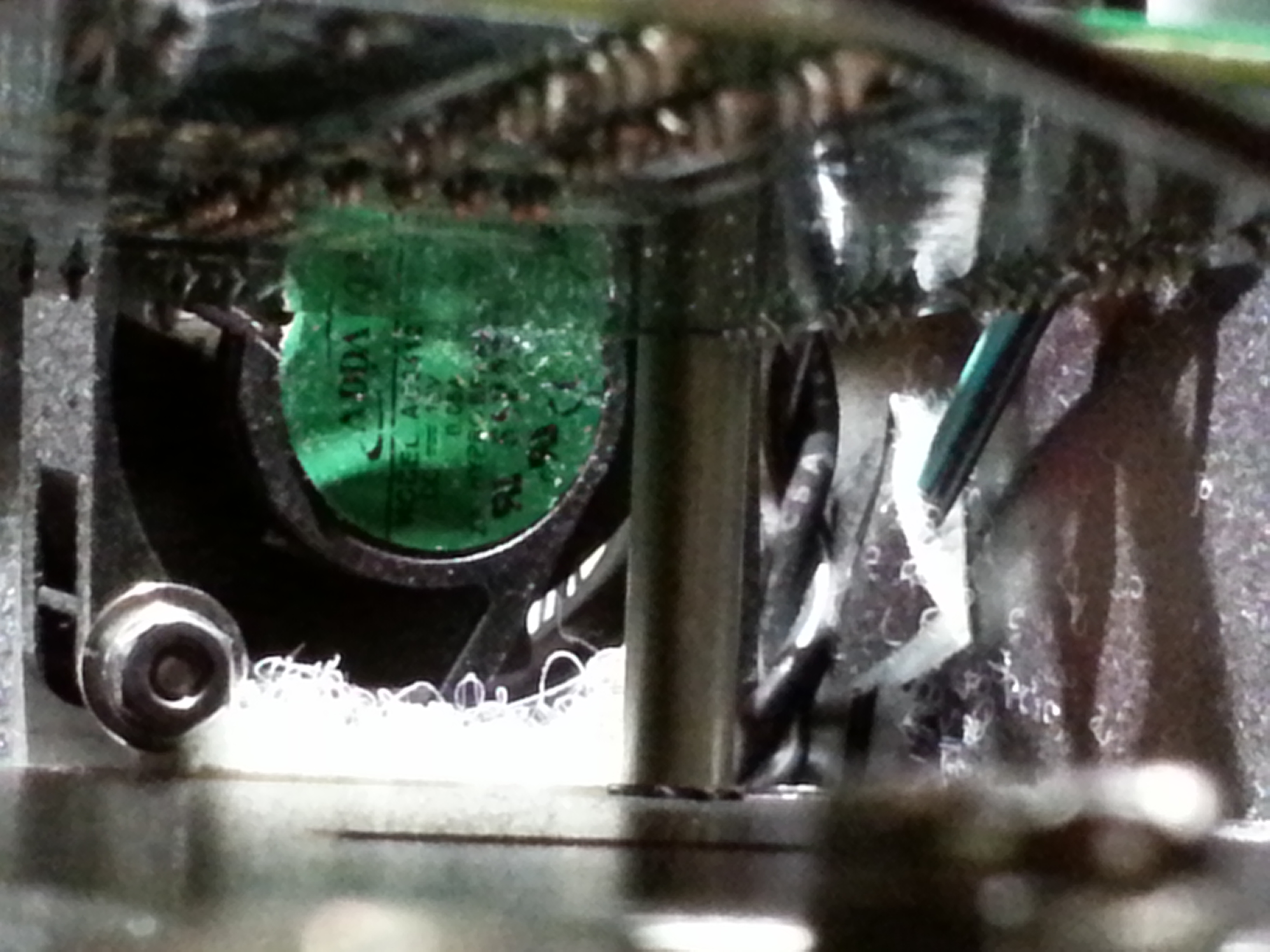

I've been having troubles with the RAMBo overheating and prints going off the rails. It takes hours with ABS, but I've been experimenting with Nylon and it's happening MUCH faster due to the higher temps (280c with an e3d v5 hotend).
Does anybody who has added a fan to their RAMBo have pictures of their setup? I'm going to shamelessly copy one and get back up and running ASAP - trying to print myself a phone case.

First, I used 1" standoffs to mount the rambo. I wanted the room for air circulation, and as it happened it was perfect for a 40mm fan mounted to the support in back. It's hard to see in the pics. Basically a clip on the fan spaced to grab the melamine, and a strip of velcro(fuzzy stuff in pic) to hold it at whatever angle I wanted.
It's wired to be on all the time. It blows nicely across the bottom of the board and out the bay.
Sorry for the sideways pics.

I had these coolers laying around and mounted them to the dedicated positions at the back. Later I experienced overheating and skipping (especially of the extruder stepper) and added the fan I had laying around
