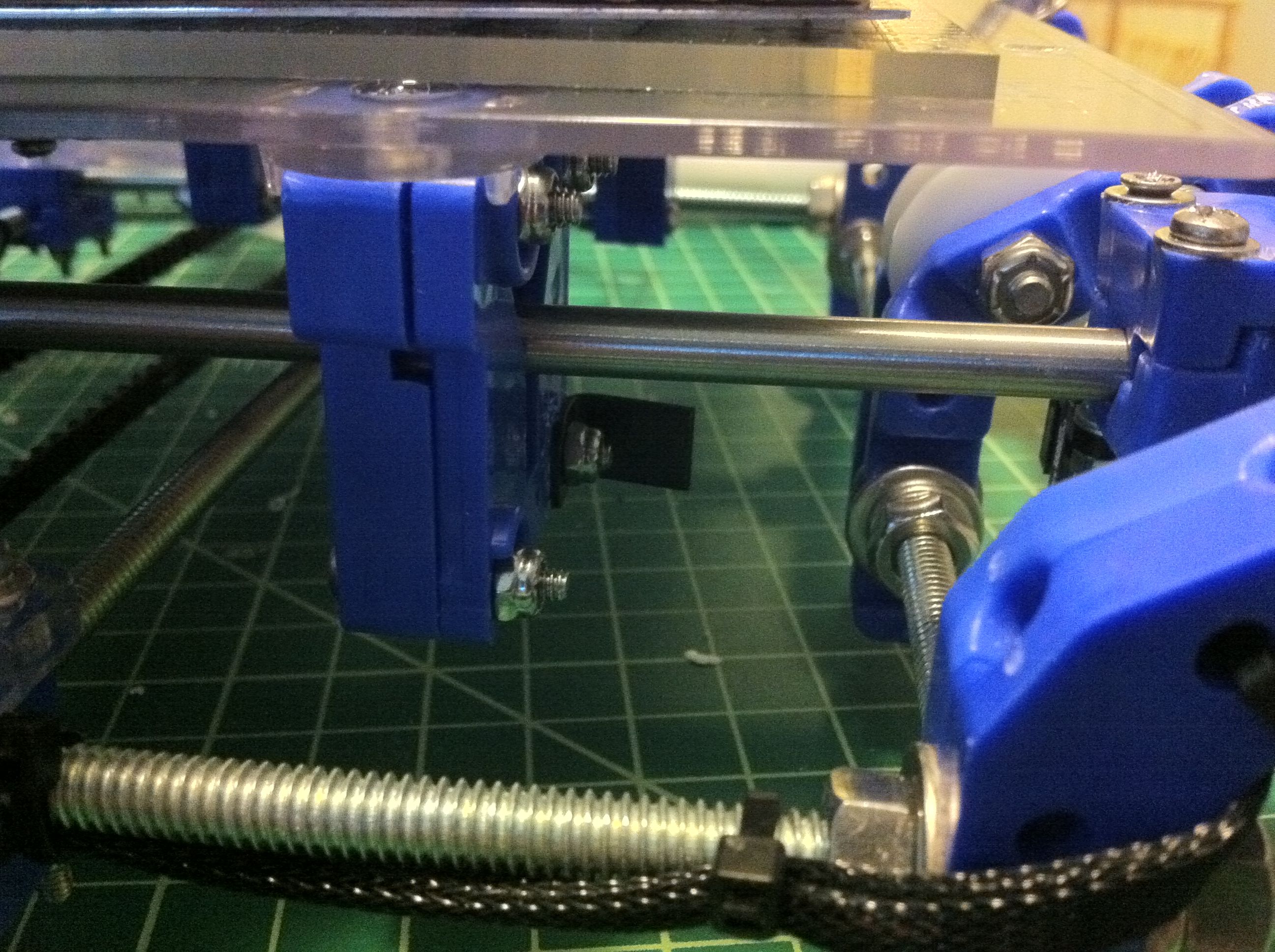

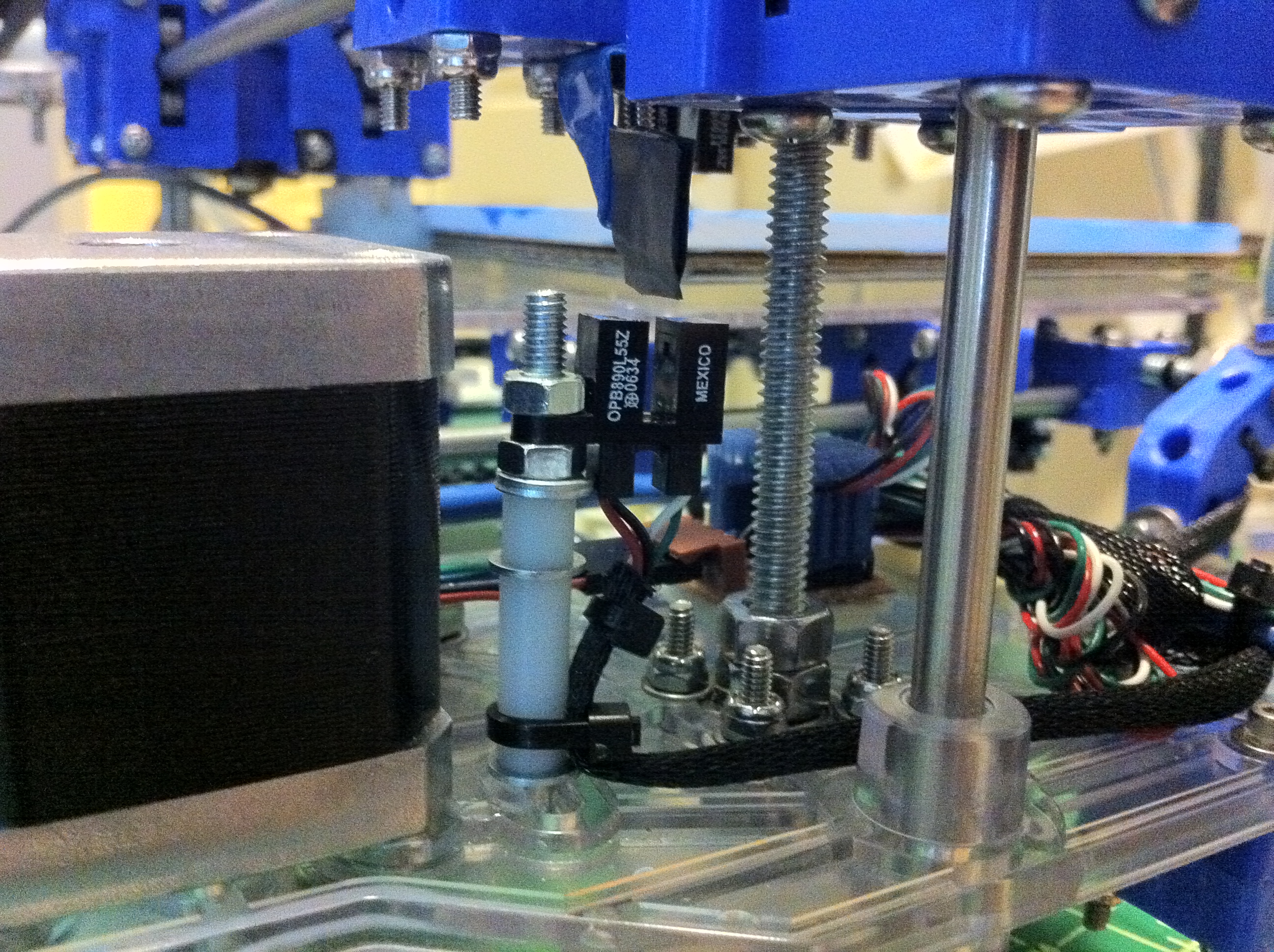

Ouch! I know that if I didn't have endstops I would have done the exact same thing and my neighbors would have found out that I swear like a sailor!

Post some pics of those so I can see how you did it.

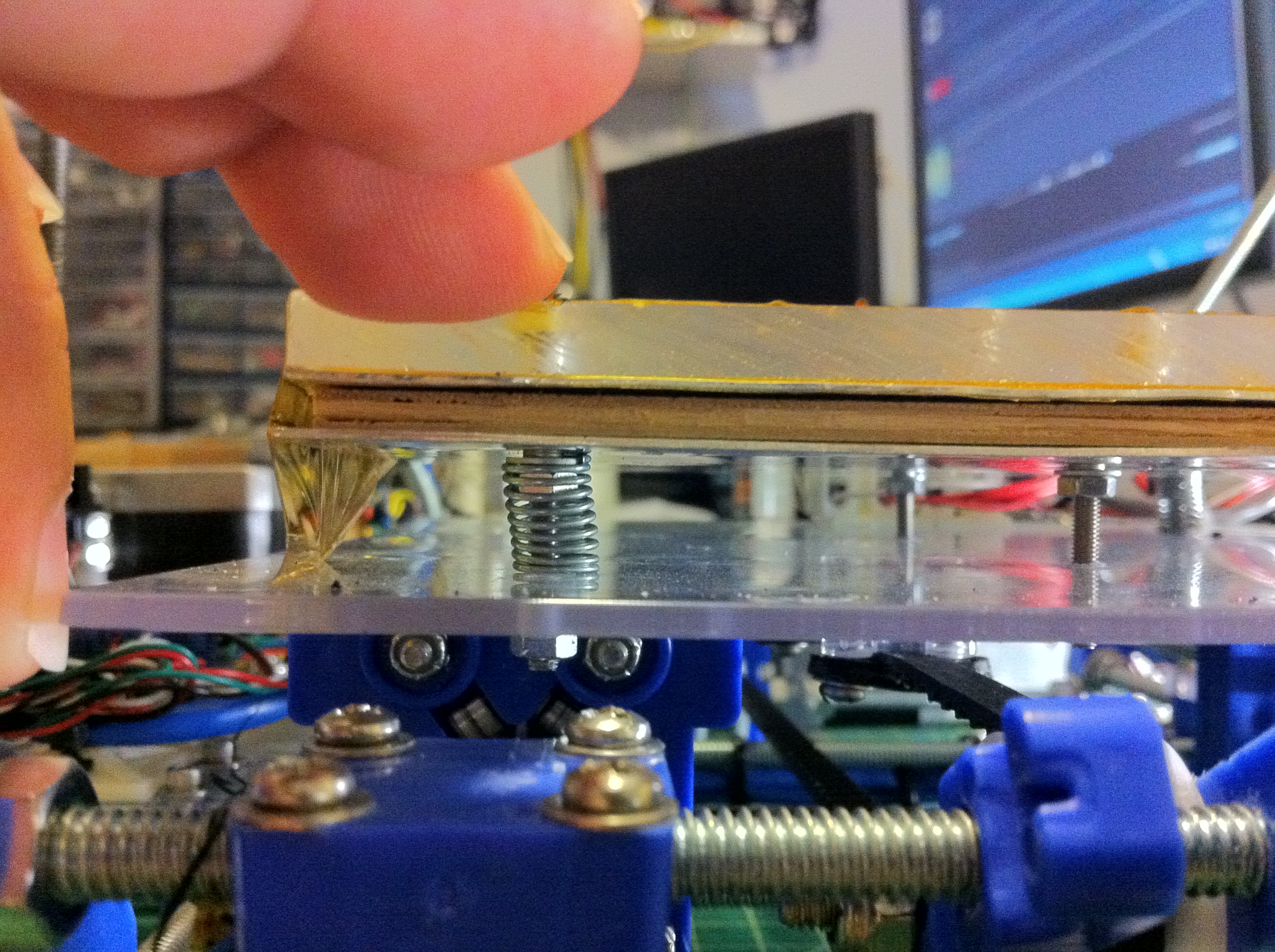

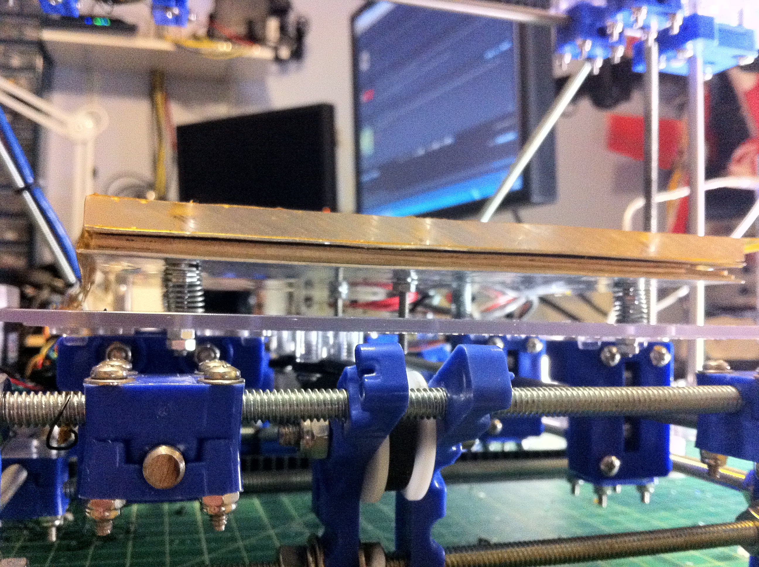

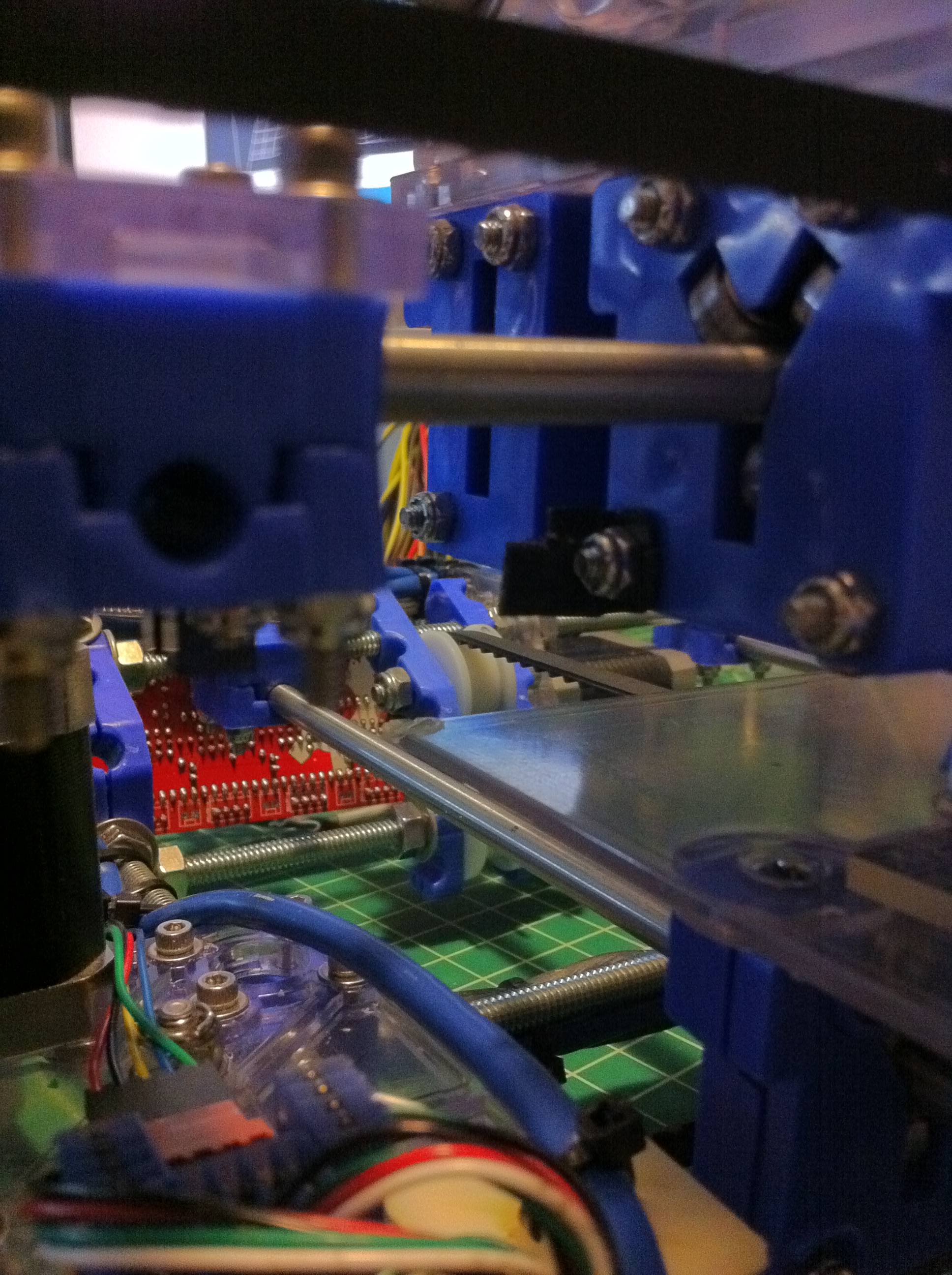

Re: Broke my hot end tonight...

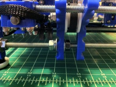

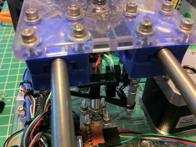

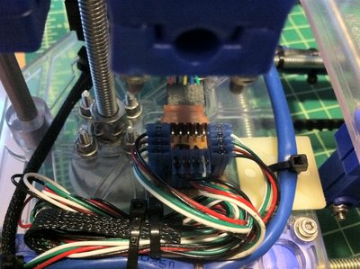

Here are some pics of the photo-interrupter endstops. They are old (~3 weeks old) but the endstops are in the same location and look the same.Chris Muncy wrote:Post some pics of those so I can see how you did it.

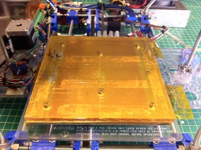

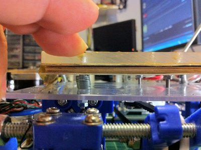

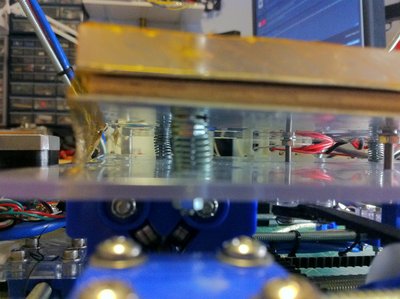

For my H-1 I have the standard/basic bed (the one that comes with the kit) attached to the carriages and then a heat bed (custom built) is held in place with bolts and springs to make leveling/adjusting a breeze.
Mike Latif
H-1 #3
H-1 #3
[quote="michaellatif"]For my H-1 I have the standard/basic bed (the one that comes with the kit) attached to the carriages and then a heat bed (custom built) is held in place with bolts and springs to make leveling/adjusting a breeze.
Thanks for the great pictures! Your design with the springs on the bed inspired me to attempt something similar.
