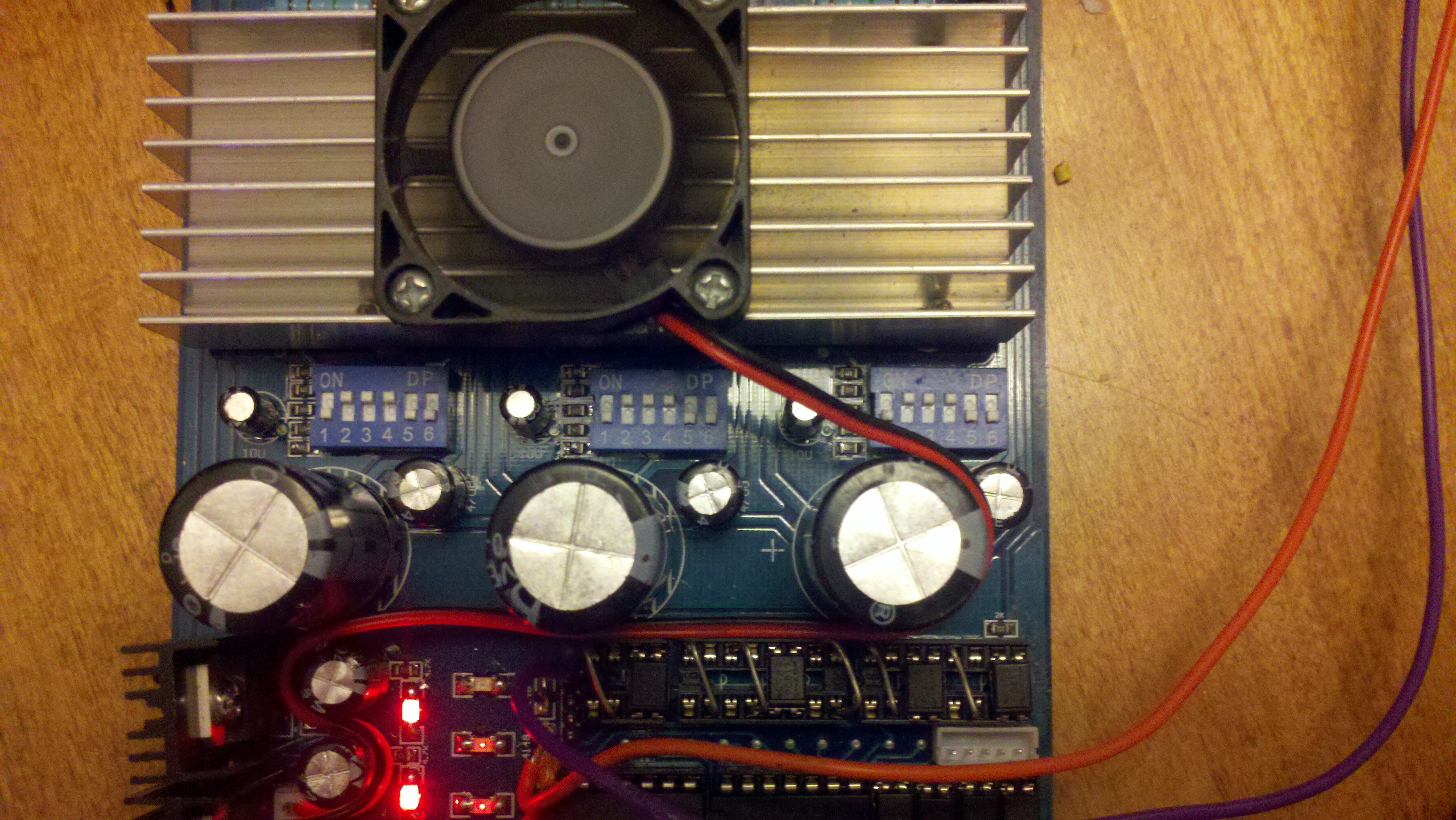

Hello and thanks for your time! I have an H1 complete kit and I'm not sure about the DIP switches on the 3 axis board. What is the proper configuration for these? As it arrived, I have a loud and weak Z axis (will not move and makes tons of noise as if fighting itself) when commanded to move. I was having an issue with my parallel port on the first computer I tried to use for this printer and all axis motors were buzzing loudly and the extruder motor was dead. After changing desktops, I found this issue and it led me to wonder about the dips.
Help is appreciated! Thanx again!

Please pm me yr email address so I can send you the draft of the electronics manual, it has all of this stuff in it for the stock configuration like you are looking for!

Here's the dip switch settings commonly used:
(it would sure help if I uploaded the correct file..)
