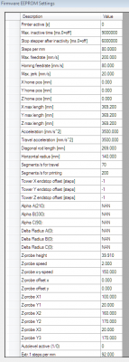

During the initial setup I've got the Z axis calibrated but the firmware won't let me move in the X or Y axis, its ignoring the move, calling it invalid. I've uploaded the new 0.91 firmware into the machine - does anybody have a link to or know of the settings that need to be changed in the 0.91 firmware specific to each machine?
Q1: What's the most common cause of invalid coordinates on the Rostock?
Q2: Microsteps= 16?
Steps per rotation= 200?
muchas gracias hombres. scouring the tubes now but can't seem to get the right google code words to give me the answer...

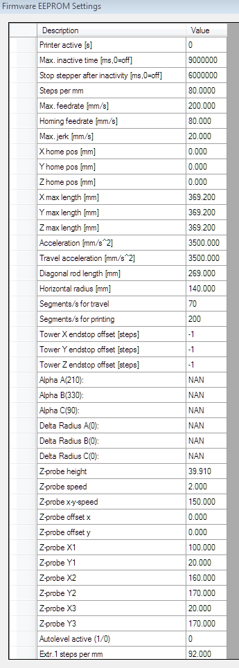

edit: diagonal rod length and horizontal radius are set to NAN in the Repetier EEPROM? those should be numbers?

Ok, so with the EEPROM setting above, any requested X or Y move results in only Z movement. As the X or Y axis is moved through its measured zero point, the move arrows only let me move to zero, then I can continue the move past zero in the same direction after the head stops at zero. Polar coordinates give me a headache, can somebody please post a screenshot of their working EEPROM and/or relevant firmware settings? If I can move horizontally, I can finish the calibration...

I haven't upgraded to Repetier 0.91, yet, so I'm not sure what the valid settings should be. However, those "NAN" values need to be replaced with correct values (for the uninformed, NaN = Not A Number which in computer math basically means the value isn't a meaningful number -- e.g. 0/0).ouchmysac wrote:Ok, so with the EEPROM setting above, any requested X or Y move results in only Z movement. As the X or Y axis is moved through its measured zero point, the move arrows only let me move to zero, then I can continue the move past zero in the same direction after the head stops at zero. Polar coordinates give me a headache, can somebody please post a screenshot of their working EEPROM and/or relevant firmware settings? If I can move horizontally, I can finish the calibration...

Just got my machine wired(temporary) and the latest Repetier firmware/Host a little bit ago. Did you make sure to wipe your EEPROM before uploading 0.91 like John says to in the first post of the 0.91 firmware thread? I forgot to do this in my excitement to just see it move. My printer was moving all kinds of strangely when I'd try to move in the Y or X. Once I reset the EEPROM and re-uploaded the firmware, it started moving correctly, ready for endstop calibration.

blam, genius.

OK, so when I G28, the positions I get for the X and Y axis are 140 (when the print head is centered). If I change the print radius maximum, that is then reflected as the X and Y coordinate after G28. So, I can only move the print head in the quadrant where all the dimensions are positive. This is a setting issue, but which one?
Re: Invalid delta coordinates - quick question
Nevermind, got it.
Under Printer Settings in Repetier, the printer shape tab, there are pull down menus for how the firmware interprets the end stops. I didn't think you guys would have made it so simple. Set Home X and Home Y to 0, Home Z to Max.
